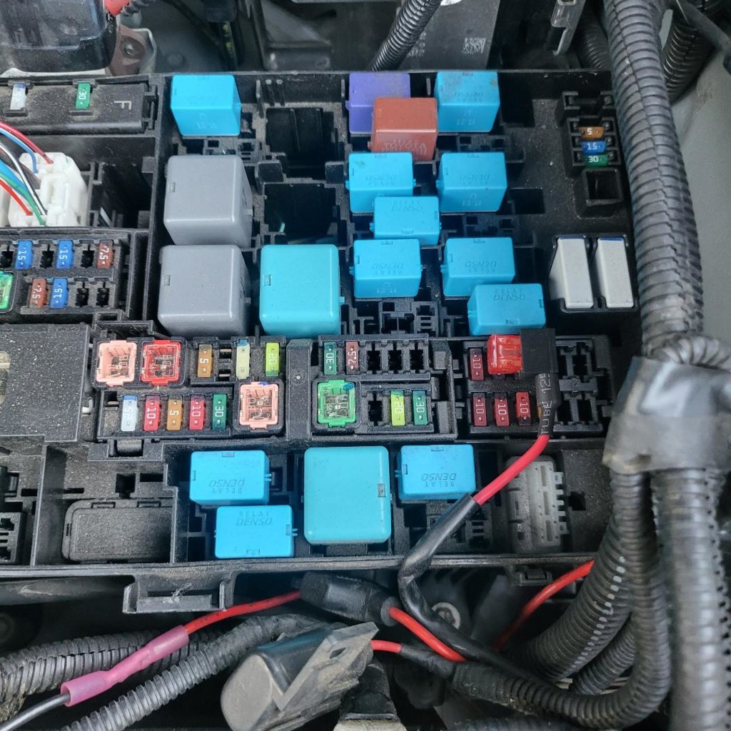

    I installed Morimoto headlights, and they keep blowing my taillight fuse under the dash. Any idea what is causing this?

    What year, which fuse do you have the fuse tap in, and are both of the fuses in the tap 10 amp?

    2018 SR5. I have the fuse tap in and both fuses are 10 amps.

    What location is the fuse tap in?

    It's in the first slot the 10 amp ignition

    Do you have both headlights on the one circuit? And what are you adding a circuit for? The headlights don’t plug into the factory headlight circuit?

    They are on one circuit. Not sure what the fuse tap is for going into the fuse box.

    If I'm not mistaken, the fuse tap is for the DRL's.
    Check the 2:10 mark.
    https://youtu.be/kcxQssGld1o?si=yxwQkP5jTlUY3NsE
    I realize that the video is for a 2nd gen, but the fuse tap should still be for the DRL.
