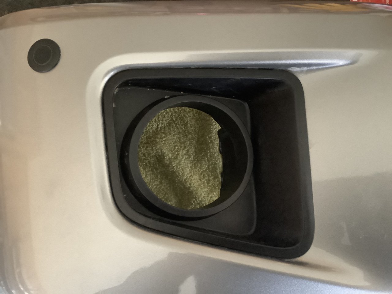

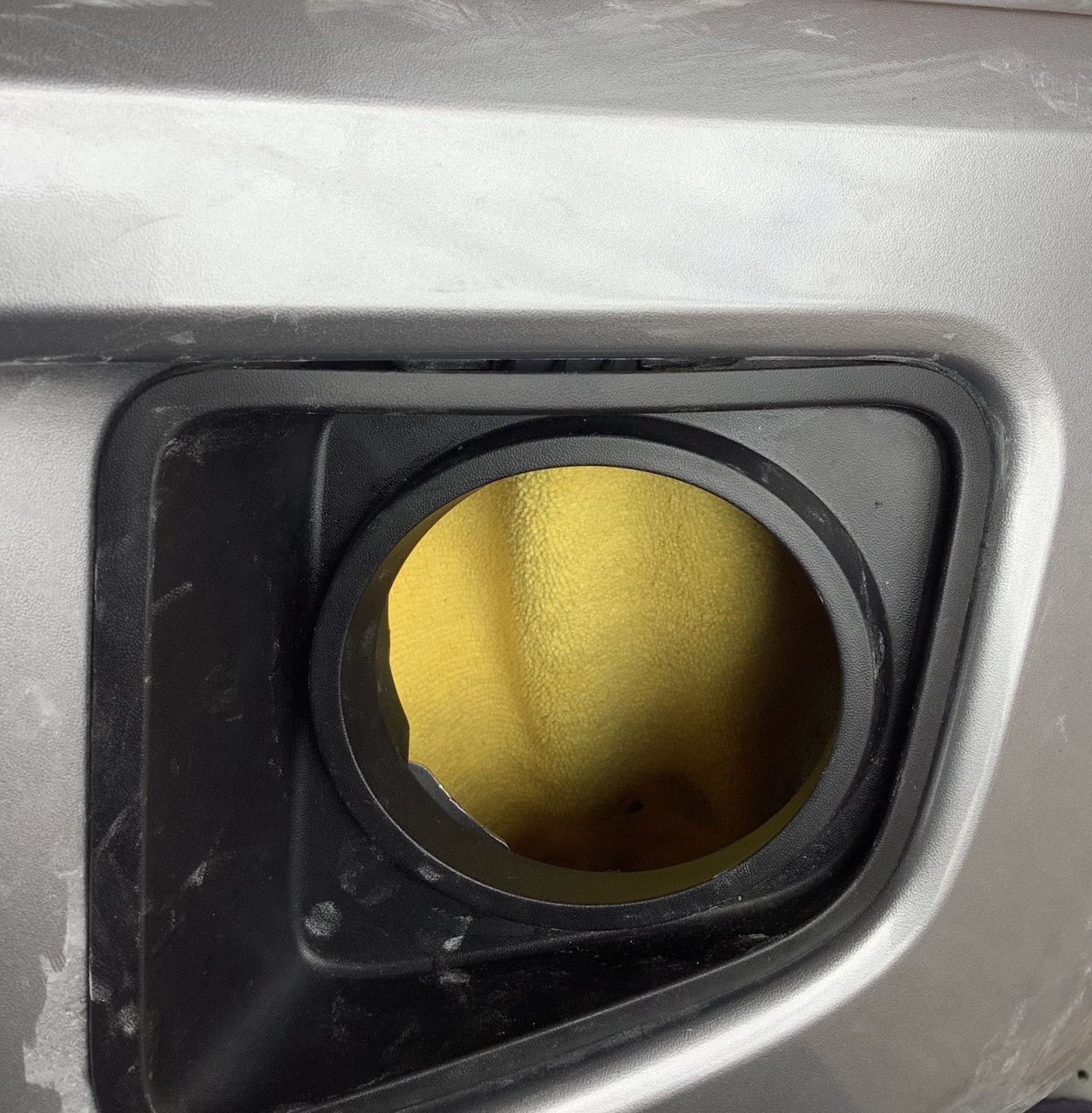

    Here’s a couple of pictures. Both the driver and passenger side are similar with the gaps. The hook on the housing is fully engaged into the bumper and has wiggle room back and forth.

    That happened to my bezels when I installed my BD fog lights. Zip ties is the only fix from what I've tried to figure out. Pull em tight.

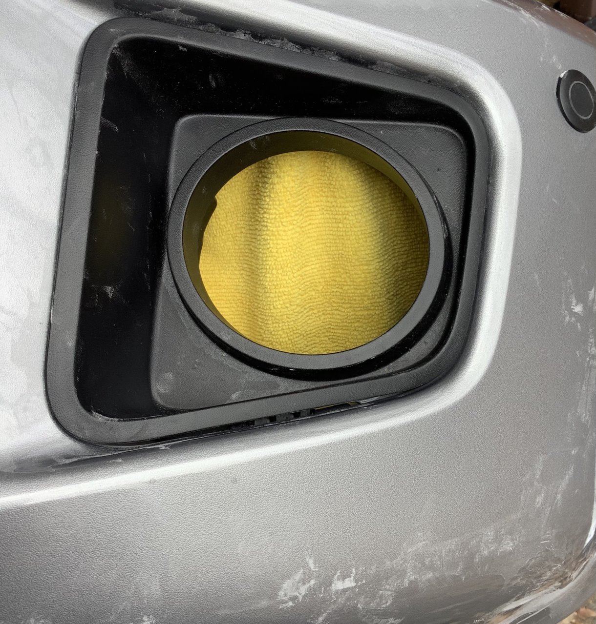

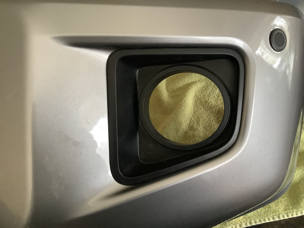

    Here’s a couple of pictures after the housings were heated and slightly stretched outward around the tab area.

    Alot better! You are the only one who will look at them daily anyway.
