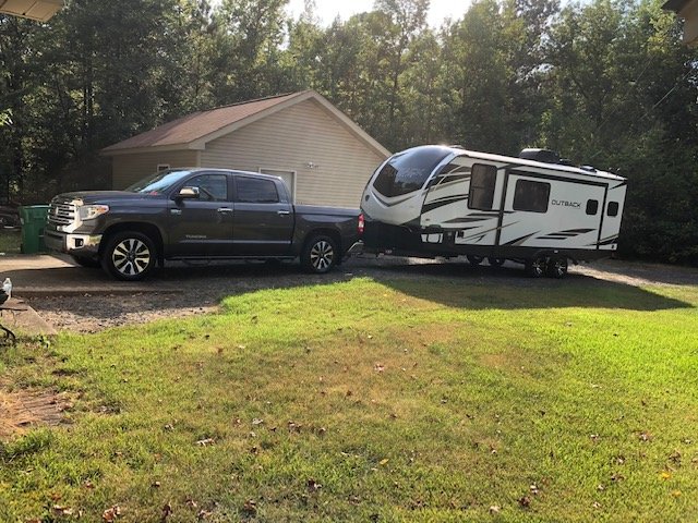

    It would also be helpful to know where and how often you plan to pull. Do you want to go to the lake a couple of weekends a month, or are you planning a 10-week trip to Alaska? :)
    We recently bought a 2021 Keystone Outback Ultralight. With a 22' box I think it weighs in at about 6000 pounds --dry weight of 5100. Our 5.7 L Tundra rocks right along with it doing 70+ easily. We bought the truck for the trailer and expect the truck will spend 90% of the rest of its life -- well, my life anyway -- with the trailer attached. We do, in fact, have that 10,000 mile trip to Alaska planned for July / September of this year. If it were going to be my daily driver just doing occasional duty to pull the camper to the lake for the weekend I'd have been comfortable with a trailer closer to the max stated capacity.
    Definitely do the weight distribution hitch. Our truck squats like crazy until we put the weight distribution bars in place. Then it's level and handles the load well. Our hitch is a 10,000 lb Fastway e2, but there are several good manufacturers.
    As far as trailer recommendations, I'd strongly suggest you check out the Keystone Outbacks before making your final decision. We've had other trailers, class C, class A, yada, yada, and we're delighted with this unit. But, then it's just me, the wife, and the mutt :)

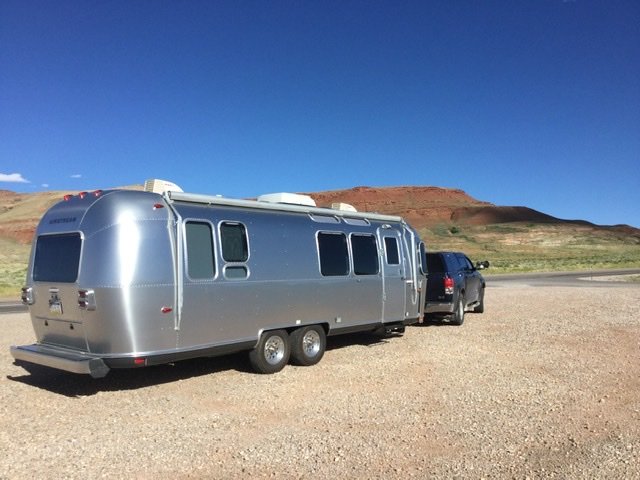

    We bought an Airstream in November.
    Has always been my dream, after many years of owning Coleman Pop-Ups.
    Not cheap for sure.
    Now just have to wait for Spring.

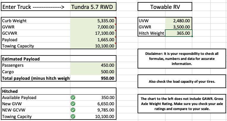

    There is a helpful "calculator" from KYD that will help determine if your truck/trailer are safe based on the weight ratings of your tow rig.
    KYD Towing Capacity Calc
    Example for my truck and Casita TT. As others have stated, you'll run out of payload before you hit max towing capacity.
