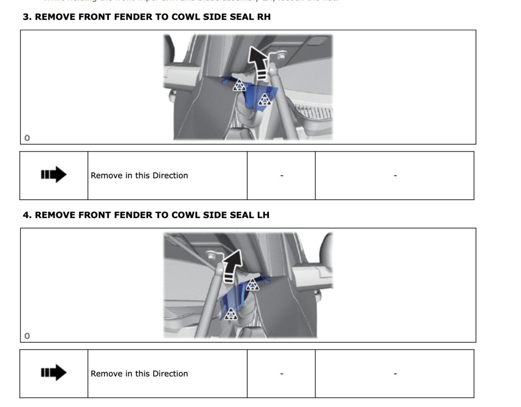

    Front Fender To Cowl Side Seal Left Hand: #53867-0C070
    Front Fender To Cowl Side Seal Right Hand: #53866-0C060

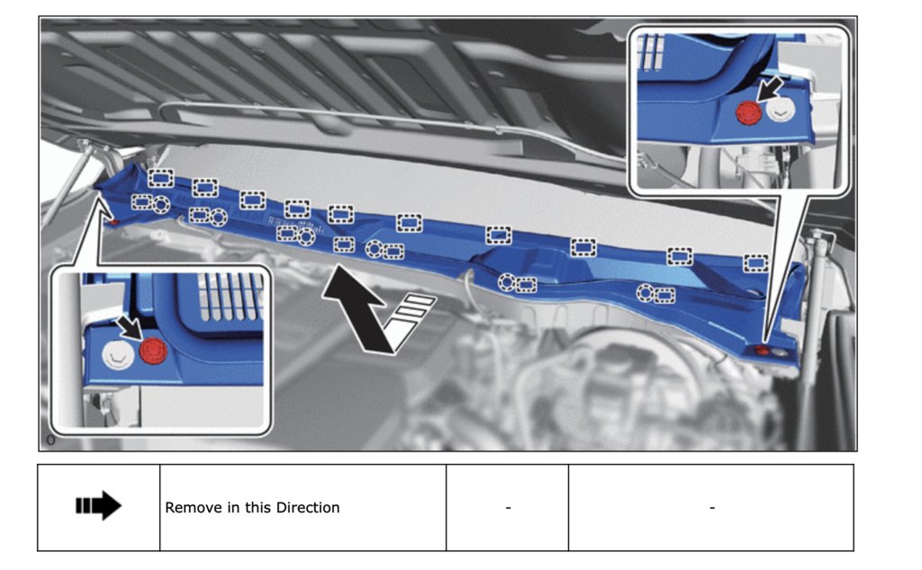

    Cowl Top Ventilator Louver Sub-Assembly: #55708-0C070
    Has anyone tried to remove these parts yet? I'd like to pull them out to rodent proof the truck's air vents, but looking at how fragile some of the other plastic is - I am hesitant of snapping off the clips. To replace the main Cowl is over $700!

    here's the procedure:
