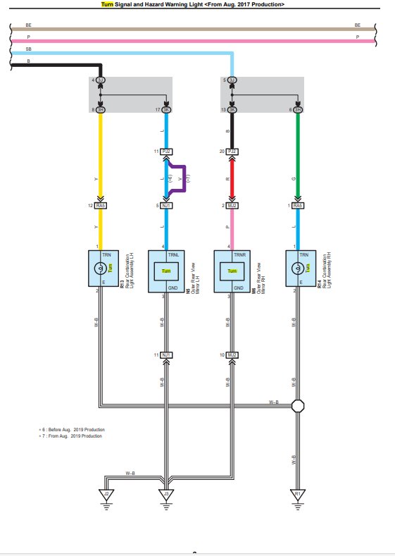

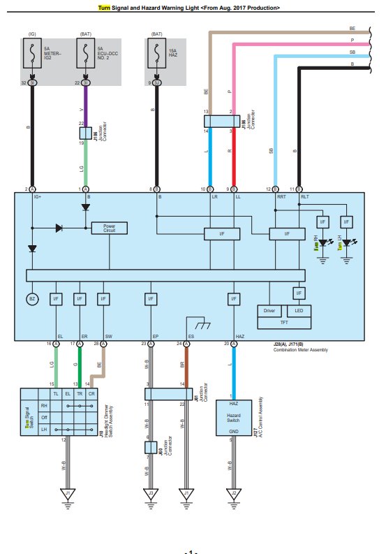

    Here is your wiring diagram and associated fuses.
    Did you recently upgrade any of the bulbs to LEDs?

    I obviously am no expert. I checked every single fuse.. nothing. I tried changing out all the bulbs (regular, not LED), nothing.
    Open to other ideas but running out of hope.
    Starting to think I might have to make a deal with the devil. Schedule a service with the dealership

    Update: gauge cluster was believed to be In need of replacement. Prior to replacement who was discovered that a Connector was loose on the gauge cluster. Technician plugged it in and everything returned to normal
