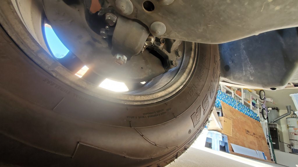

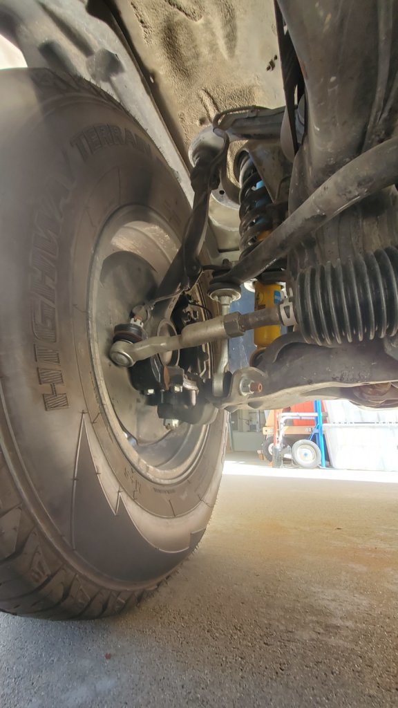

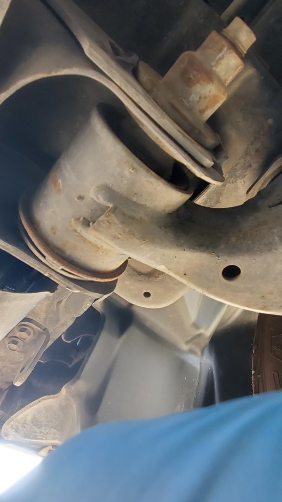

    About 2500 mi's now into new LBJs, Outer Ties, End links & bush's, Stblzr Bush's, StrRack Bush's., Rack boots, clips & Bilstein 4600 x 4. Tracks straight, turns steady w/out wheel slop, quiet, smooth.
    About 1500 miles back , towed 4500# boat/tandem trailer 150 frwy, flat road miles and launchramp [handled all like near new truck]; all other miles frwy or city streets [pavement queen].

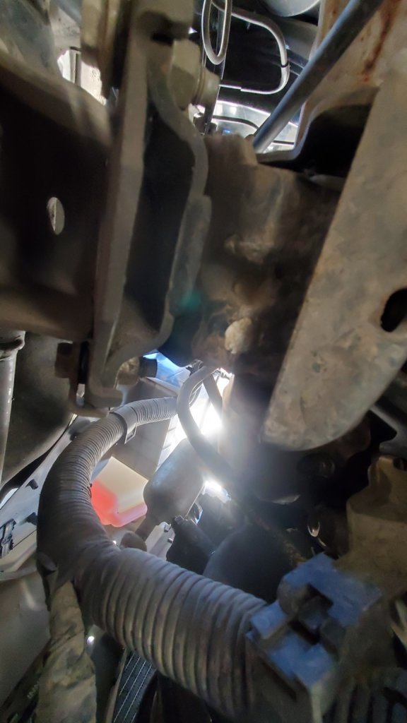

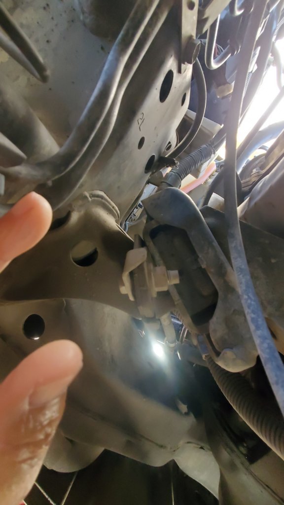

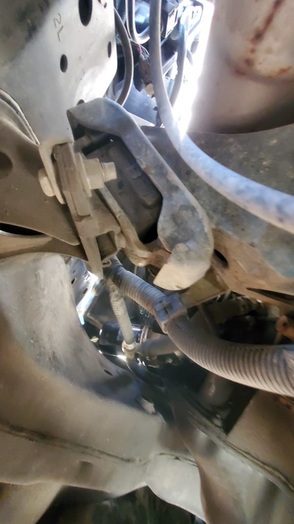

    Yesterday, started a dull pop sound at acceleration only- Single pop and nothing otherwise until next acceleration fr/full stop or very slow. Sounds like coming fr/Lt side and very repeatable.
    Please take a look at the pics and comment if anything looks out of ordinary.

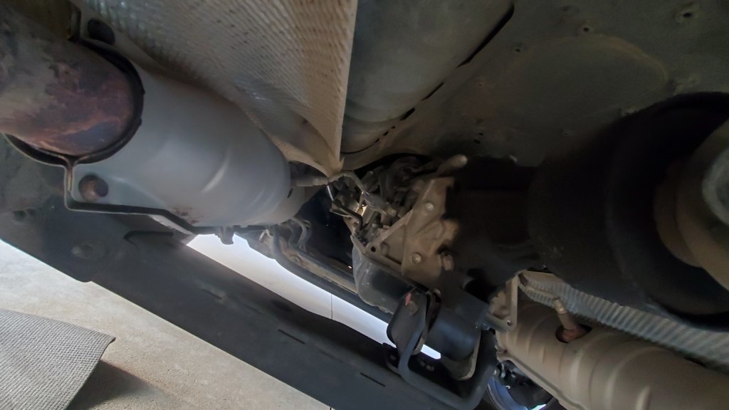

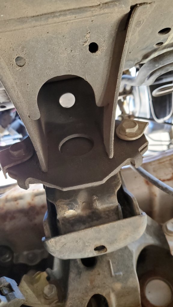

    Only other thots I have on the Acceleration pop [or thud] is motor mount failure [Lt side].
    The pics of wheel assembly and motor mount as much as I could get cam in at correct angle.
    Thx for the inputs...ps
    Lt wheel

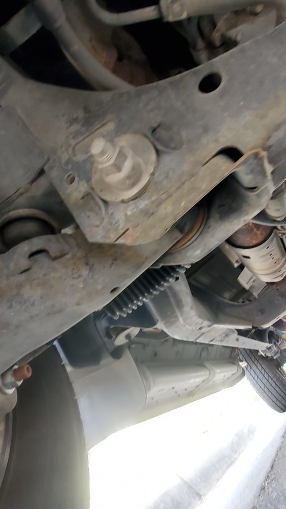

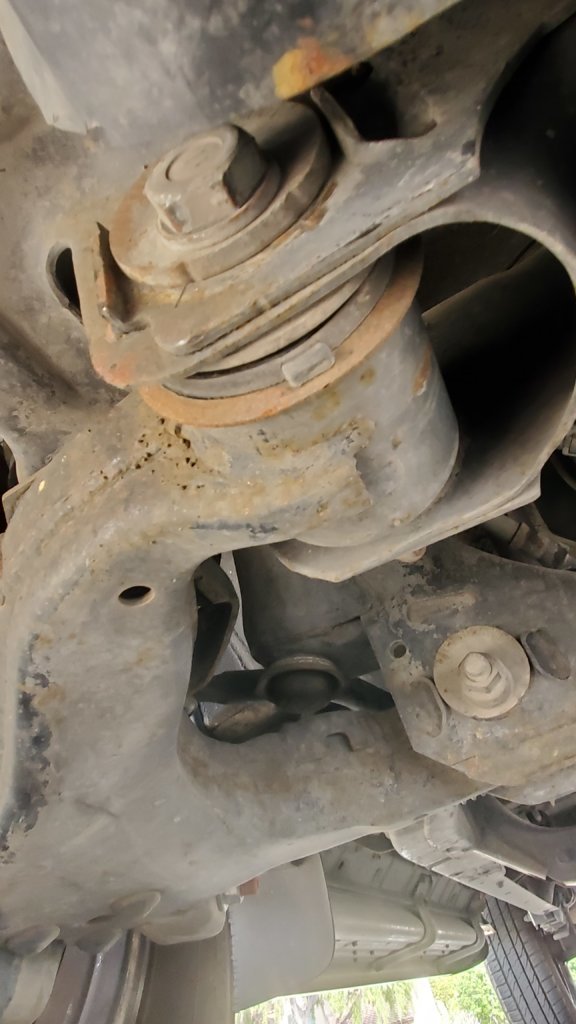

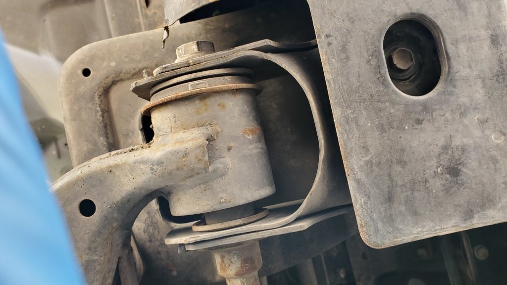

    Lt Motor mount [hard to get cam in there- sorry]

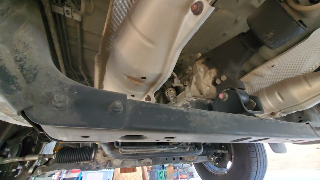

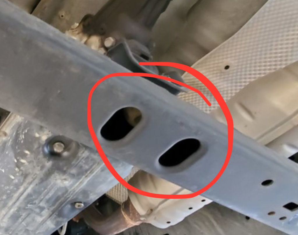

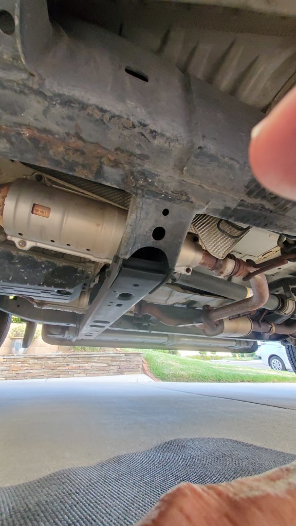

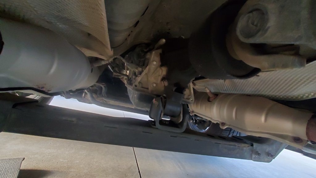

    BTW: in this pic, looks like 2 fasteners are missing@ btm/Bell Housing ?

  4. Sep 8, 2025 at 5:38 PM
    KNABORES
    KNABORES Sarcasm incoming
    Jan 1, 2020
    #40572
    15,226
    Arkansas

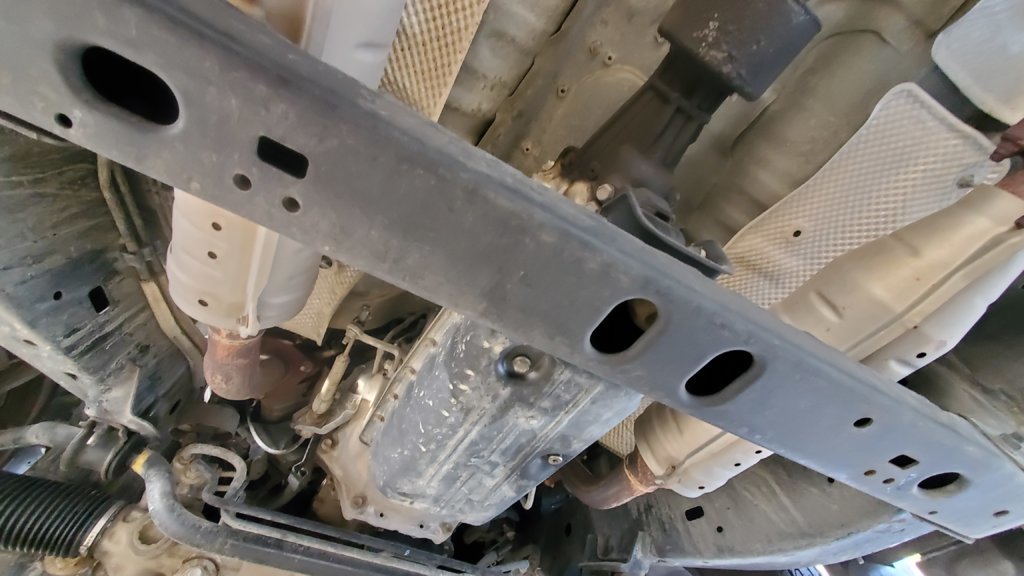

    Have you inspected the transmission crossmember for cracks? Missing bolts? There’s a TSB for 2wd trucks on this issue.

  5. Sep 8, 2025 at 6:29 PM
    ps8820
    ps8820 [OP] New Member
    Mar 28, 2024
    #114453
    563
    joe
    06 SR5 AC 2WD V8 CaptainsSeats
    Freshly Killed Piezo Buzzr!, Re-paint 04-2025
    IDK..unless I can magnaflux it, it looks solid. Some surface rust at join to fr/rail.

  6. Sep 8, 2025 at 8:04 PM
    KNABORES
    Jan 1, 2020
    #40572
    15,226
    Arkansas
    Look in here. Should be 4 bolts. No hairline cracks.

  7. Sep 9, 2025 at 8:59 AM
    ps8820
    Mar 28, 2024
    #114453
    563
    joe
    @KNABORES ..thx for the clue.
    Hadnt thot of that, just b/c sounds are coming fr/ wheel well/firewall, at least when in the cab it sounds like that...
    Gonna rack it up later today to get a good look at the X-member.
    Sounds weird to say, but I'd be thrilled if it were just the X-member vs. FlexPlate, TC, anything tranny, etc....

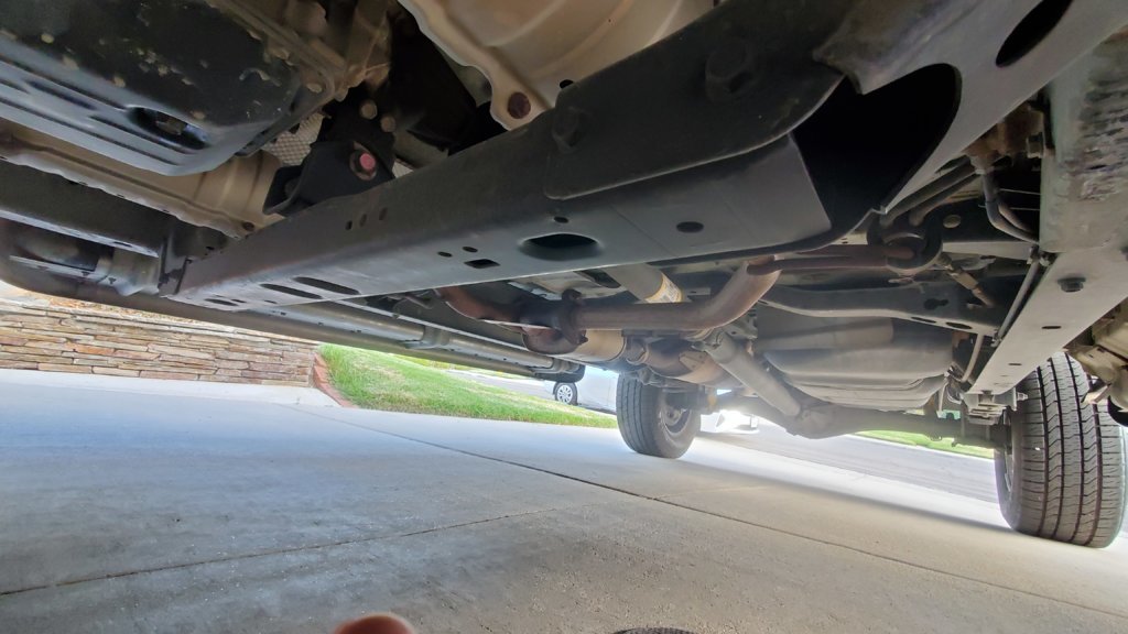

  8. Sep 9, 2025 at 9:53 AM
    blenton
    blenton New Member
    Jul 15, 2022
    #80740
    3,414
    I had some bolts that needed to be retorqued after working on the suspension that gave a similar dull pop/clunk at slow speeds. I retorqued them once, then loosened and retorqued them the next day and it solved the clunk.
    I'd also check the UCA ball joint and bushings.

  9. Sep 9, 2025 at 12:48 PM
    RustyMcTee
    RustyMcTee We do it right, cause we do it twice
    Jan 27, 2022
    #73771
    172
    New England
    03 AC SR5 4x4 3.4L V6 234k
    New frame in 2022 CB Radio Aluminum cap Bilstein 4600's
    Sounds like my upper ball joint before it blew out on me. Any shakes in the wheel or weird tire wear?
  10. Sep 9, 2025 at 7:26 PM
    ps8820
    Mar 28, 2024
    #114453
    563
    joe
    Late Update :

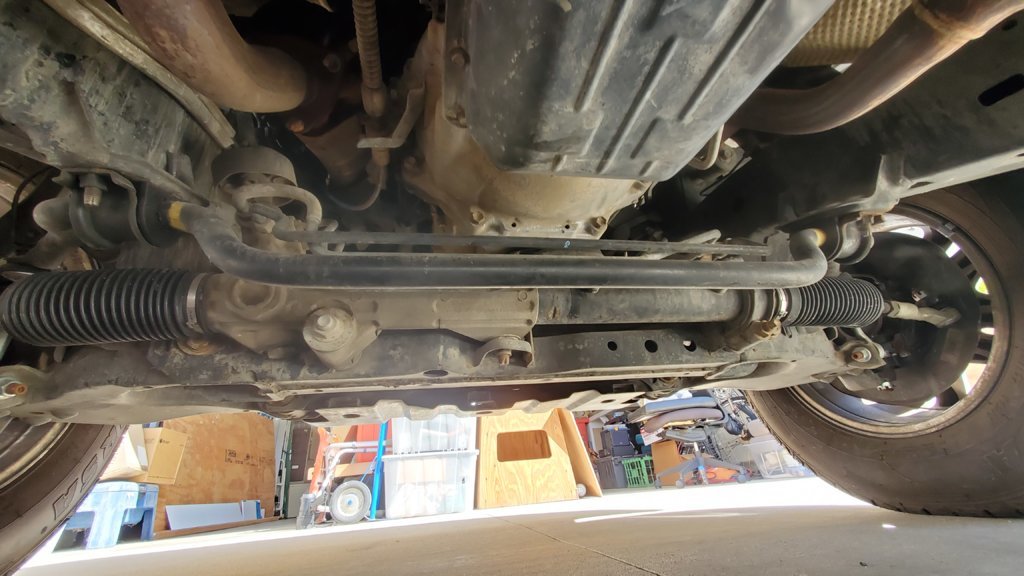

    Closer look while on rack at local driveline shop: all apparently good, including Trans support Xmember and motor mounts are good [for 19+yrs].
    nt. No wheel shakes, shimmies, pulls...
    Drive shaft/u joints in decent shape for 19+ yr/old. About 1/8" slop in the joint at the differential, but not horrible and not responsible for the dull pop sounds, and clean and reasonable at trans tail and the mid-support. Yes, theyre all originals and should be updated sooner than later, but mechanic cant see how theyre responsible for what we're hearing.
    On mechanics test drive did several tight circles w/wheel full lock, Lt & Rt - sounded off only at start and sounded same for either direction.
    Also sounds off when brakes applied and released while in drive: about like advancing in a fastfood waiting line.
    Lunged throttle a few times w/foot on brake to check motor shift, lift, push and all looked good and didnt produce the dull pop/thud sound.
    So, will see mechanic who did the suspension rebuild tomoro AM to troubleshoot. Everything he did [shown in #1 above] has been doing excellent for the 2500-3000mi's so far, [including the 150 mi's of towing] with all Toyota parts.
    The only other thing I could possibly suspect, based on the kind of pop/thud I hear, is what maybe a failing shock mount might sound like but all I can see is the bottom end and they look properly seated and bolted.
    Almost think it may be brake related since its easy to repeat the sound by staying in drive and hitting/releasing brake for short hops.
    Driveline mechanic said it sounds/feels like caliper bolt is loose. OTOH, it may just manifest more obviously by braking action, or anything that suddenly loads and unloads drive train torque on the frt UPPER suspension... Gonna pull wheels this week and check brakes.
    @blenton ...I'll make a point of mentioning all that; btw, UCAs, UBJs, etc: all original, so wouldnt be big surprise if thats the problem source...
    @RustyMcTee ...that makes 2 votes on UCA parts...
