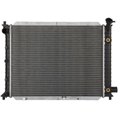

    IMAG3677.jpg Have you checked around the hoses and water pump area for signs of a leak? My stepdaughters car is having the same symptoms right now, but hers is a small leak where the transmission cooling lines connect to the radiator, maybe another place to check...The fitting is where hers leaks (very minimal) the reservoir will go down to the low level about once a month.

    No problem. Since we're on the topic....I really need to swap out the radiator on my stepdaughter's car this weekend (since I'm having shoulder surgery next Friday and will be down and out for a bit). In the picture above - have you ever seen a transmission cooler line that connects like this? Will it be reusable? In the pictures I've seen the new radiators appear to just have a threaded hole where this fitting would screw into, but I'm not sure if they can be reused or if I need to track down a replacement before taking anything apart. Car is an older beater with low mileage. 1998 Mercury Tracer if that helps any.

    If mine is currently leaking at that fitting (where the upper trans line connects to the radiator) is that just a radiator swap or will I need to replace that fitting also? The new radiator doesn't appear to come with one. Unless I'm wrong, it looks like the trans line goes into an insert and the insert is threaded into the radiator. I've changed radiators before, but haven't seen the trans line connected like that.
