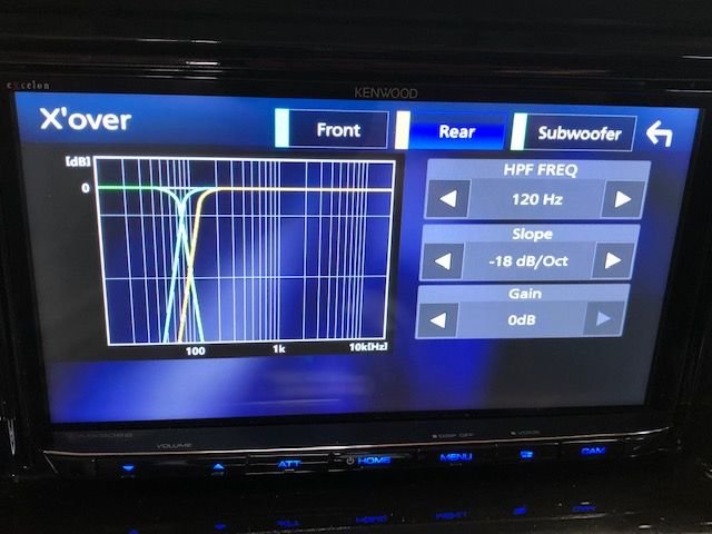

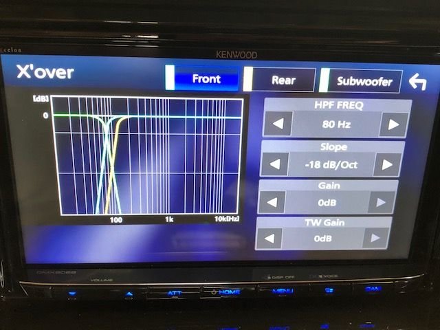

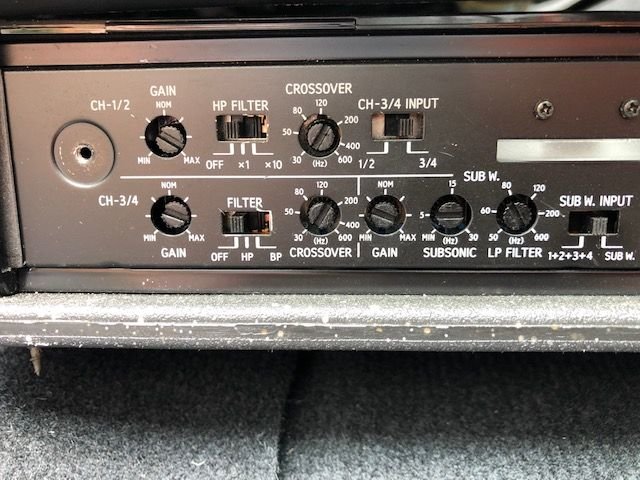

    Pics. Amp settings per James' recommendation. DMX HU settings are bone stock.
    Notes from debug tonight:
    - The cabin 'knob' does indeed work, but only if I crank it to the Max
    - If I remove the remote knob cable, it seems like Amp defaults to 'max' (whatever that is)
    - Overall bass is still very, very muted, only about the same as OEM door speakers, not like a 250W 12" driver
    - There is a high frequency hiss right after the HU boots. It's covered up when there is audio but during silent moments it's very apparent.

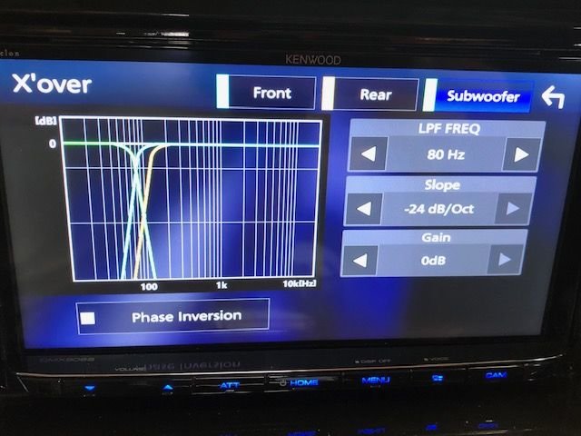

    And the sub settings
    (BTW, cannot increase the gain, it is disabled for some reason)

    I think you’ve got some issues on your crossover and sub gain. I don’t know what James told you to do, but for the crossovers you want those to either match or overlap slightly. Right now your sub is at 80 hz and your full range channels are at 100, so you have a 20 hz dead zone. And your sub gain is set to 0, so that’s probably the main reason you’re getting weak response. You can crank that up a good deal, I’d say at least half way, then tune from there.
    That’s just my approach though, and I’m definitely not an expert. But I’ve usually had decent luck getting okay sound out of my system.

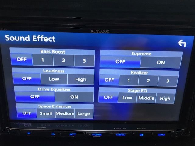

    Meanwhile, here are the boilerplate settings from tech12volts. (I didn't getting anything kenwood specific but did send him a pic of my amp dials and he blessed it) Note that "Bass Boost = 0dB" in both cases.

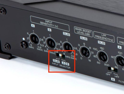

    Here are the Kenwood manual descriptions for the Amp dials. "Bass Boost" sounds rather vague, says "Sets the low frequency level to be compensated." Low frequency level sure sounds like... a frequency level rather than a gain.

    The terminology used in audio equipment is very confusing because it is so inconsistent. Every box has something different, every HU something different.
    So let's look at that "Input Sensitivity" dial. I found this online for a definition:
    The input sensitivity is understood as the voltage required at the input to drive the amp to max stated power.
    I asked James about it and he said "Crank that up to 3/4." But there is Min on the left and Max on the right. Yet the numbers are not linear and go from Greater to Smaller! So which way should be 3/4 be viewed? He then said "Set it at 0.5." OK.
    But when looking at the bolded definition I should actually be putting the dial the other way, closer to 5v. Why? Because I know my HU output pre-amp levels of about 4.75v (HU is rated at 5v but doesn't quite reach it.) Because I currently have the dial at 0.5, this means that even a teeny tiny voltage will allow the Amp to output max voltage on the speaker outputs. I'm amplifying noise - this would explain the constant hissing even in the absence of any signal.
    And still doesn't explain why the Sub hardly works at all. Ugh. Will try some 1kHz and 50Hz tones through it today and measure with a multimeter to see the real speaker level output.

    Leave the Bass Boost off. Dont touch it.
    On the left side of bass boost is your Sub Gain. Look as though it is turned up (sensitivity) to 0.5v... which is definitely turned up. You "should" have sounds.
    Is there a setting inside the radio itself to turn on or off the sub?
    The setting on the sub look fine as far as gain and frequency to start with. I would check your wiring again.
    Or get a multimeter and check the sub output at the amp for voltage.

    The input sensitivity should not be crank all the way up. It should stay around 4-5v. So basically turning clockwise, from a rest position, very slightly. This is to match the headunit. If your hu puts out 4.5v, dial the amp gain to 4.5v.. not at 0.5v, there will be tons of hissing when silent.

    Tick the input selector over to AB and see if it does anything.

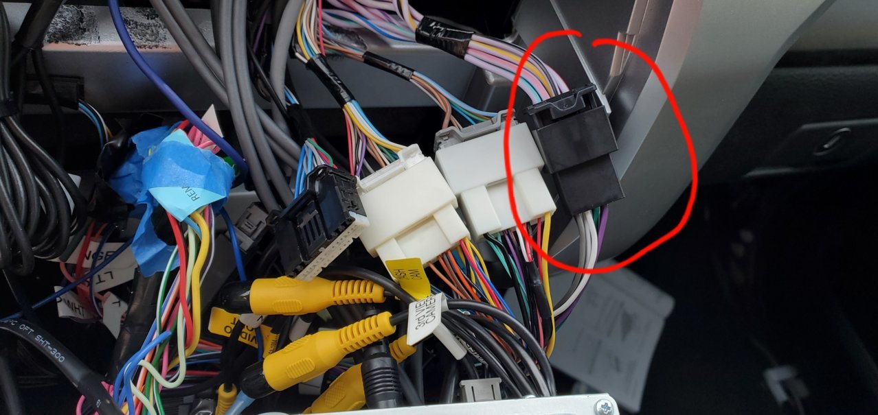

    And here are the pics of the Toyota plugs. Three connected, one orphan plug remaining. It is identical in shape & size to one of the others and I initially had it plugged in. But pretty sure it's not the correct one since it's black. I thought "surely none of these will be the same, if they fit it's good." Not the case.
    And Maestro doesn't show the "extra" plug, it implies there are only three.

    20210414_100719.jpg We need to dig into your connection here.
    1. Are you using the amp bypass harness?
    2. Your photo show this black plug connected to the factory harness. It shows the speakers wiring, white, green purple, grey.
    If you are using the bypass harness, under passenger seat, this black connector need to be disconnected.

    #58113

    Unplug the black plug i circled in red.
    The harness that is under the passenger seat is the bypass harness. That need to go to the amp's speakers output.
    You already have the rcas from hu to amp input.

    Your HU Preamp Voltage is 5 volts set your amp gains accordingly.
    Kenwood Excelon X802-5 X Series 5-channel car amplifier — 50 watts RMS x 4 at 4 ohms + 500 watts RMS x 1 at 2 ohms at Crutchfield
    Your amp's Line In: The amp will accept a signal between 200mV and 5V.
    You shouldn't need to turn your gains up very high to get where you need to be.
    You can see your minimum gain setting is 5 volts
    Here are my amp and HU crossover settings.
    You can try using them as a starting point and see if you can go from there.
    I was surprised to see how low the gains needed to be set for optimal sound quality..
    I have a Kenwood Excelon - 5 volts output.
    My amp input sensitivity is 0.2 - 4 volts
    My gains are not set on MAX they are set to the 10:00 position.
    I'm using the crossovers in the HU.
    All my amp crossovers are set flat (off) sub crossover set to 600Hz.
    Subsonic filter doesn't matter if your enclosure is sealed.
    Someone may have mentioned this but,
    As far as your crossovers, either set them on the HU or on the amp, not both.
    Just turn off your amp crossovers and use the HU to adjust them.
    Much easier to adjust when you're by yourself, makes it easier to actually listen to the differences than running back and forth from the driver's seat to the amp.
    Once you understand and hear what you feel you want the crossovers to be at, you can then experiment with turning off the HU crossovers and setting them on the amp.
    I don't think it makes any difference, many feel like it is better to set them on the amp.
    Slopes are a personal preference, after you get it dialed in, experiment with them to your liking.
    Front
    Rear
    Sub
    And turn all this off until (and maybe after) you get everything set up to your liking.
    Only thing I can see using is a little loudness at low levels, but your sub knob should take care of that.
    Good luck..

    SOLVED :thumbsup: (And BTW: Only the White Wide Toyota plug and Grey Wide Toyota plug are needed for Maestro; the small black plug and Wide Black plug are not)
    1lowlife, thanks!! That's almost exactly the setup I ended up with (James had called me and we walked through it)
    - Disabled the Amp Hi/low crossovers entirely
    - Set it up from the HU instead
    - Made the door speakers around 4v on input sensitivity (gain)
    - Made the Sub about 2v - going any further to the right made it too 'boomy' IMO
    - Added some level control on the typical inputs I used, but I only show USB
    Now it rattles my mirror! ;)
    Note: Didn't take a pic but set the "SW Level" (HU Sub Gain) to +9
