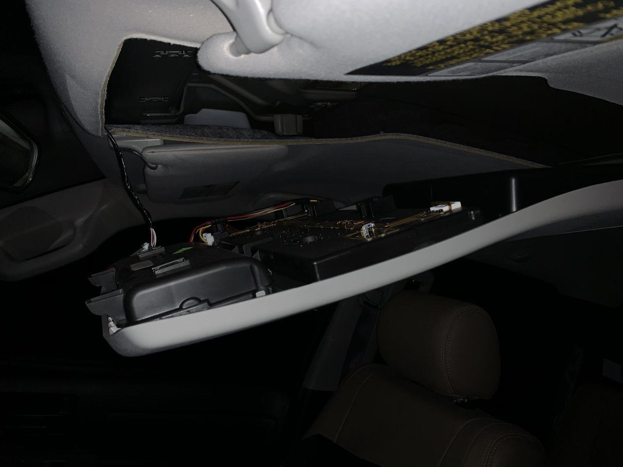

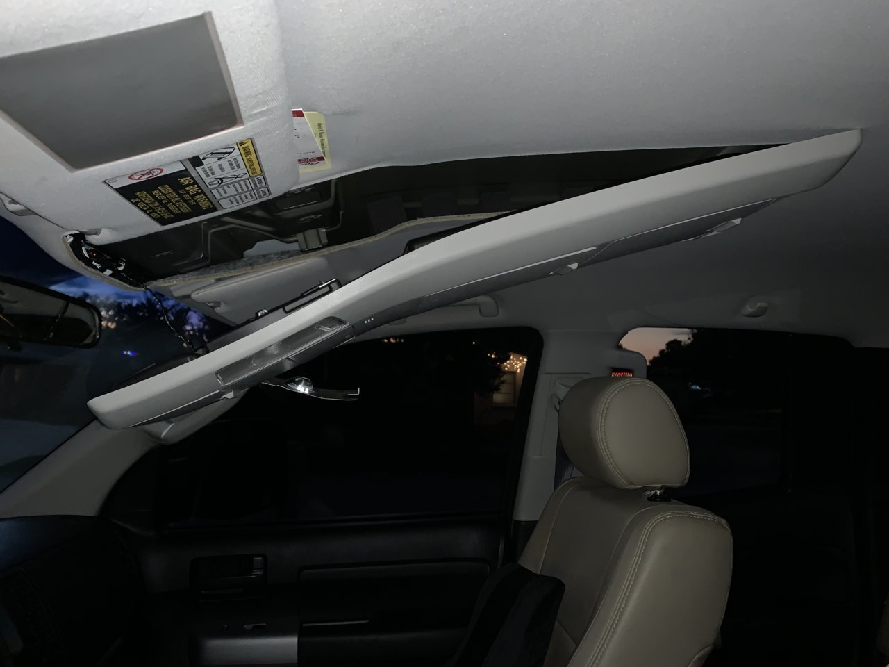

    I'm trying to remove my overhead console but, can't get it totally removed. I can't figure out how to get the Back to release.
    The third picture is looking at the back.
    Has anyone done this?

    If it's like my 2010 theres 2 thin thin metal tabs (reflective metal) you have to bend back after removing the rear light cover which allows access to 2 more screws. don't bend back like that going to break something.
    I attached a file that shows how to remove.

    Pop off the light cover, there will be 2 screws.

    Got it thank you. Those two screws in the back are hard to see even with the reflector removed.
