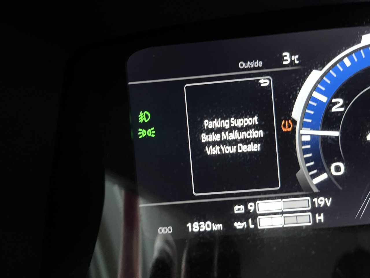

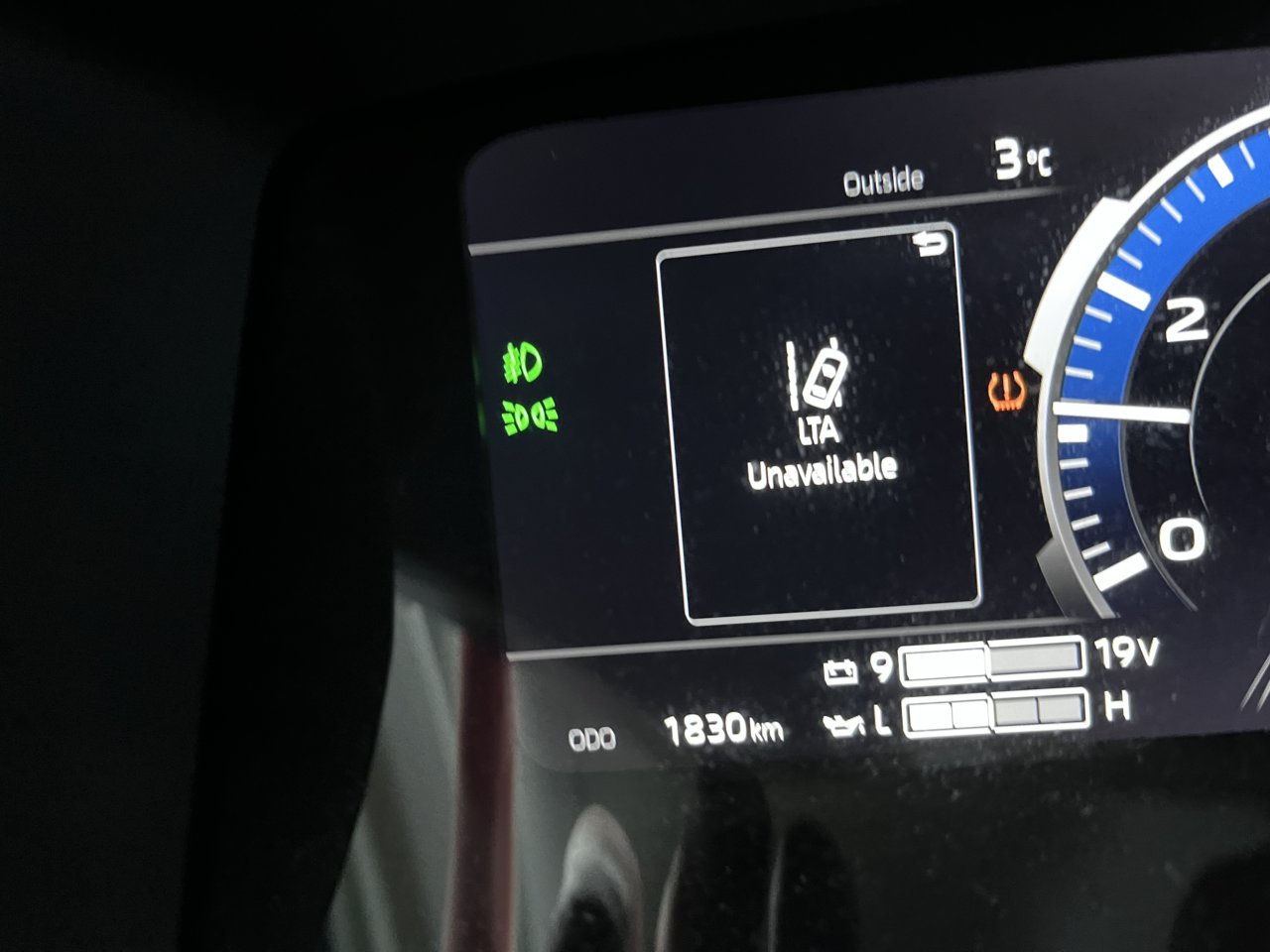

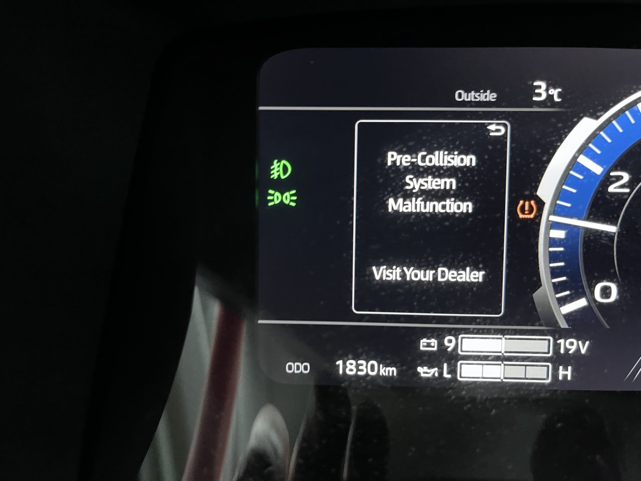

    -after the install the truck rides great, but I am getting the following warning messages on my dash:
    -the truck went to the local Toyota dealership for a calibration but they could not clear the codes and I have no traction control, LTA or pre-collision avoidance capability according to the dash images as shown
    -oddly enough I got a brake! message on the dash when I came too close to another vehicle from the pre-collision avoidance system even though it is not supposed to be functional so not sure what is going on there...
    -the only other issue I have had was the main digital dash died the other day while at the dealership. I came back 45 minutes later and it was fine, but they service person did not mention anything.
    As it stands: The local dealer service took some photos of the lift to forward to Toyota Canada to see if they can solve this issue. The service department said they were looking into it at the previous visit but left me hanging for 5 weeks with no contact, so they do not seem interested in helping solve anything.
    If anyone has some insights into what I can do the help with this it would be greatly appreciated. In my opinion, it is a software or calibration issue, but the local dealer, "doesn't want to calibrate it again as we have already done it once."

    I suspect your pre-collision system is actually working ok. The problem is more likely related to the lower speed safety system because you have a Parking Support Brake Malfunction alert.
    This is the system that I think is failing:
    Can you try three things and at each stage see if the messages go away?
    1 - Turn off the parking the parking assist like in the video.
    2 - Go into your menus and turn off the parking radar assist.
    3- Go under the truck front and rear and follow the wires from the little round parking sensors in the bumpers. Look for a break or disconnect. As an anonymous internet stranger I would put a timbit on this being the problem.
    Then report back :thumbsup:

    There are a few wires up front attached to the upper control arms that are delicate. The tech may have disconnected them to avoid breaking them. I was reading that if the key fob is in the truck while doing any type of work will cause all sorts of issues. I think the battery disconnect was the solution. This would allow the codes and errors to clear.
    What tires are you running after the lift. If you go too high overall, this can also cause issues. There is a long thread that talks about the height issues.
    Also noticed that you TPMS light is on. What is going on with that?
    Sounds like Mountainpete might have a possible solution as well! The sensors seem to rely on each other and if one goes crazy, the rest seem to shut down.
    I know the Lower Mainland dealerships are probably not the best to talk about the TRD lift as they probably haven't done any. They should have the spec's on the lift and know what the upper limit is for height before the sensors go crazy.

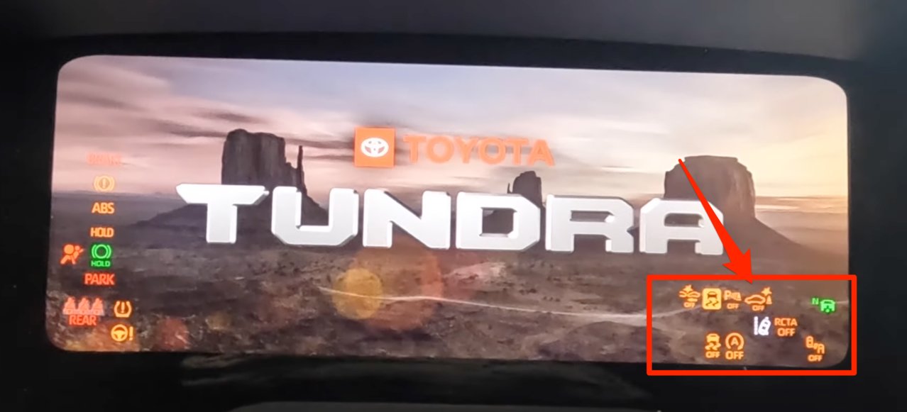

    When you press the parking assist button (1:15 of the video) nothing happens at all? The light should go on and off. The light should, in normal operation, go on when the truck starts and then disappear.
    If you never see the that icon on startup or if it doesn't appear/disappear with the button you should have the dealer diagnose that specific item.

    I'm not entirely sure this is a calibration issue. I say that because I'm running ~3.25" of lift with my Icons up front PLUS another ~1" from my tires. I've never had my sensors recalibrated. My front radar & LTA all still work as they did. I don't have any PCS or LTA warnings on the dash like this (knock on wood).
    It sounds like something didn't get reconnected or there's a connection issue somewhere causing a hitch in the giddy up.
