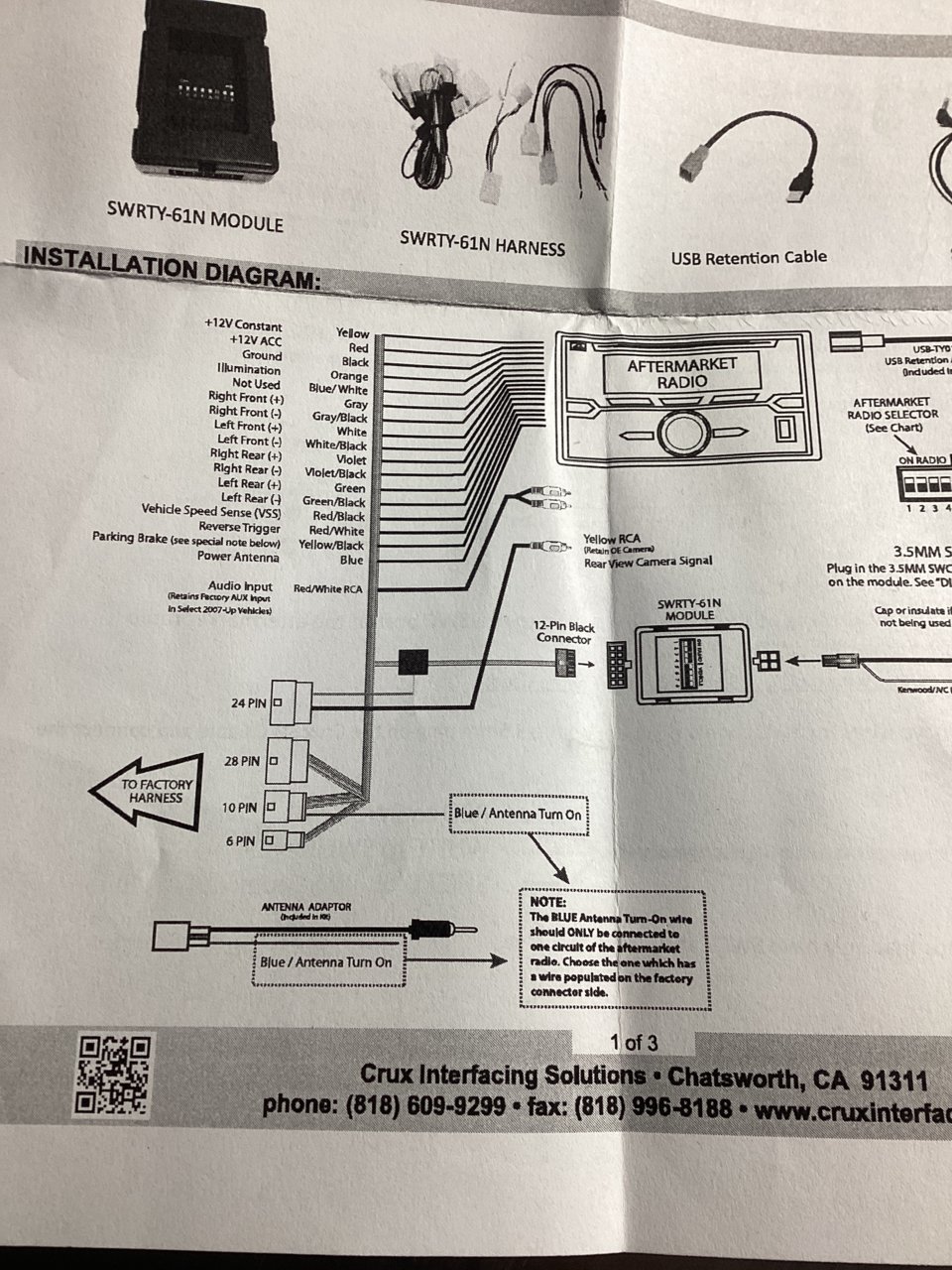

    I’m in the process of installing Jensen stereo and can’t figure out pink wire. Diagram shows pink on radio side “parking brake (-)” plus has tag saying VSS. On the Crux adapter side it shows red/white (looks pink to me) reverse trigger. Would they go together? TIAimage.jpg

    Is it your e-brake bypass?

    VSS is vehicle speed sensor and is used by the head unit to lock out (or unlock) certain functions based on if you are moving or in park.
    The reverse trigger is for turning on your backup camera
    They are separate functions.

    Do you know what the vss is connected to?

    So where did CRUX tell you where the “VSS” gets connected to? Mine, like yours, is pink, not red/black as on the direction sheet, and mine also says “PHONE MUTE” printed on the wire.

    They told me it was not needed. So I capped it off.
