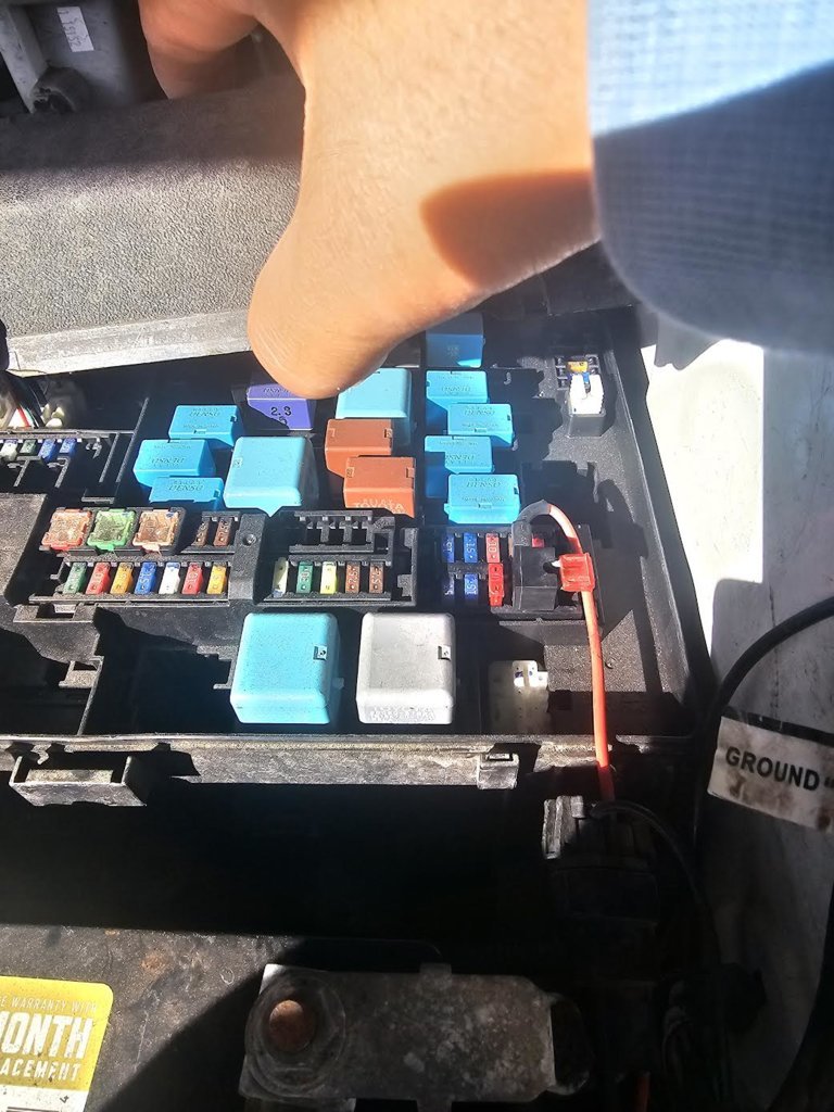

    Hey guys I had this plugged into this spot but had to take it out because it would randomly pull power throughout the night and I noticed my battery would be dead.
    Any idea where to put the add a fuse to power my day light running lights on my aftermarket headlights?

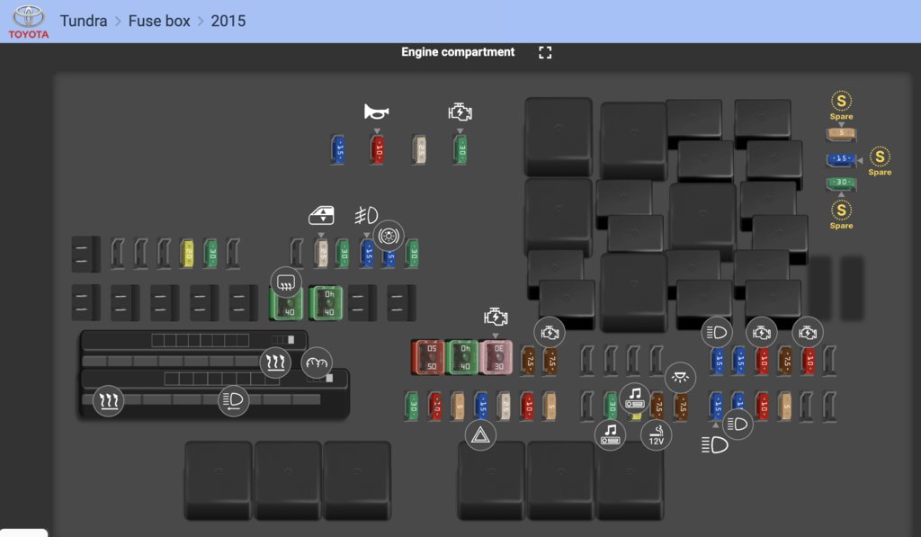

    Which one is it?

    LED headlamps/fogs; interior footlamps.

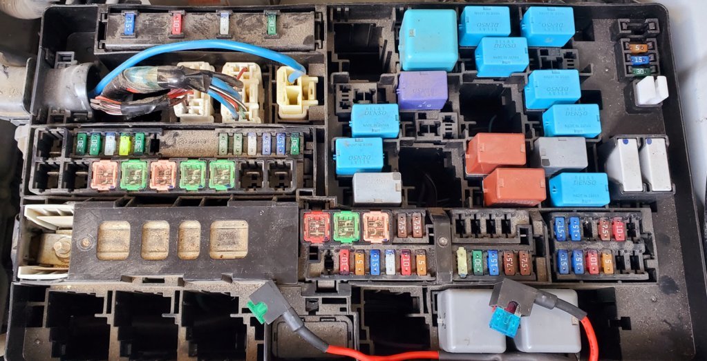

    Ignition is on top row - middle - Green with Engine/lightening bolt symbol. That is your Trigger wire (+) to the relay No. 86 connection on relay. Then connect the +power from No. 30 on relay to the device along with a ground. Now it will not turn on by itself. Here is my fuse box - you can see the Ignition trigger and constant hot I used.2015 Fuse Box under hood.jpg

    Do you mind taking off that add a fuse so I can clearly see so I can copy you??
    Thank you!

    74
    Thank you it worked but now I gotta figure out why one side is amber and other is the right white light lol...
