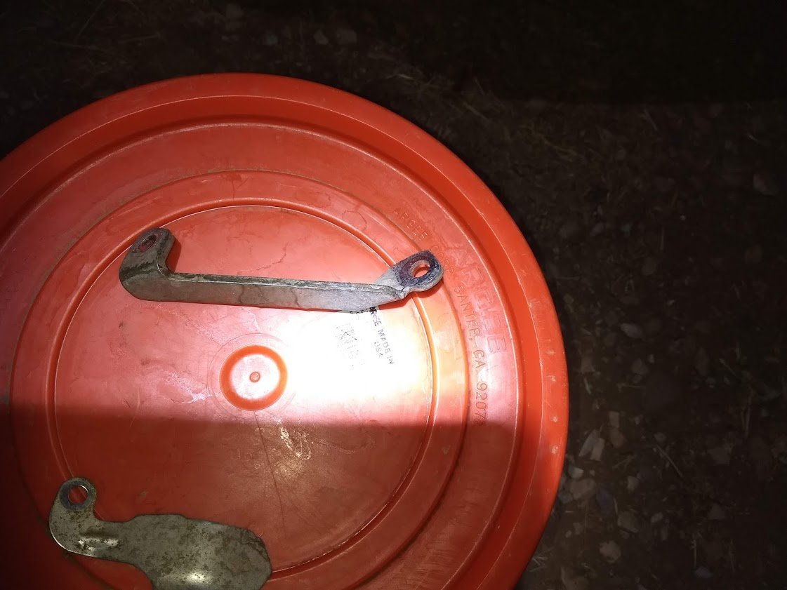

    Also, what is this part? I know the one in shadow is the protective cover for the crankshaft position sensor, but what's the other one? where does it go? It was leftover after I re-assembled my engine bay.
    _dsBBoGlO4EcOUGEZagCwD3KiGm9Mg9erXE1REoC_65606bec285a49712c36f6a5161731488817e089.jpg
