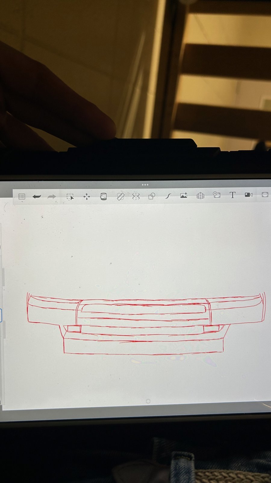

    I plan on cutting my bumper like this:IMG_9200.jpg

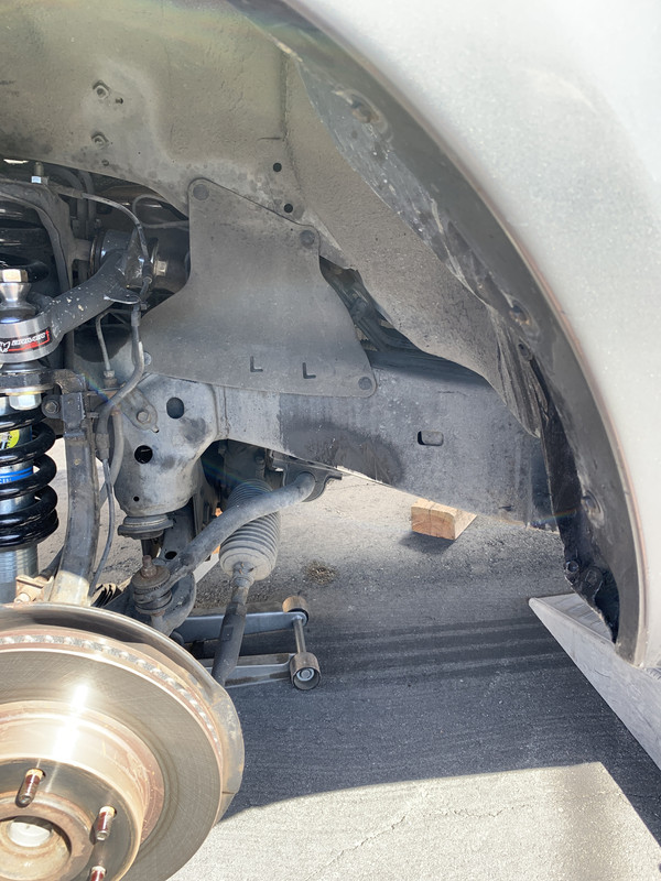

    You will 100% rub on the frame on the driver side on 285, there is a user on here with the SCS Gen 5 on a grey double cab. I will look for his video or Instagram. Those were my original choices for wheel and the ray10 was on the list, so I had tons of screencaps of them.
    you should probably go with a pizza cutter tire, 255/75/17 if you don’t want to rub
    Update. Read the caption.

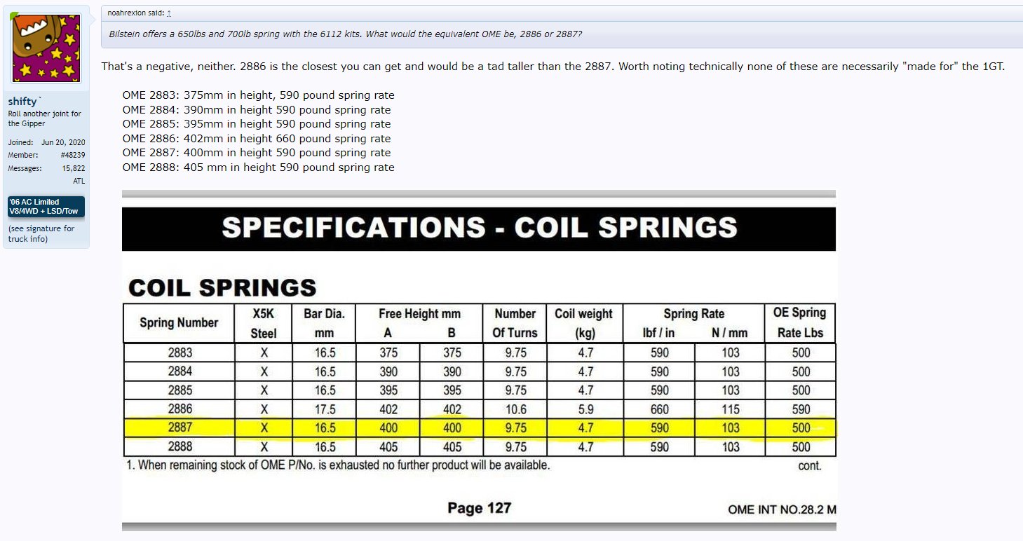

    I'm pretty sure also, those are all 590# springs. You 100% sure that's what you want to use vs. a 700#?! 2886 is as close as you can get, at 660#.

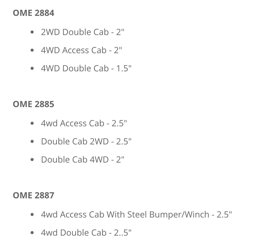

    What would be the best way to get to 3" lift? Should I just run the 2885s and adjust the collar? I'm trying to avoid spacers

    It's not recommended to use anything other than the lowest circlip on Bilsteins when running lifted springs, so no, I don't think adjusting is the way to go here.
    Honestly, I still don't get it, and I'm not the biggest fan of running strut spacers, but you may want to just slap in a 1/2" strut spacer and call it a day. IIRC, the lift ratio on pucks is 2:1, so 1/2" would give you the 1" lift you're desiring. If you only want an inch, and you've already got aftermarket uppers planned, then run with it.
    OME tens to under-quote their lift kits. You may want to skip Bilstein and go straight to their 3"/1" lift kit. Won't be adjustable (I don't think), but technically neither is the 5100 if you're using lifted springs, so seems like an apples to apples situation to me.
    I think I missed that you're leveled in front, just saw your signature. I don't consider "leveling" the same as "lifting". That's probably why you're not noticing a ton of difference, you just changed the angle of the frontmost portion of the truck. You haven't "lifted" the truck yet.
    I'd be interested to know whether the 2886 OME coil is recommended for our Tundras.

    3" front spacer (Not even an option due to the roads I travel)
    Bilstein 5100 with OME 2885 and 1/4" Shims (Not keen on mixing lifts but willing to do it)
    Bilstein 5100 with OME 2887 (would most likely get me to 3" but wont the 5100s max at 2.5"?)
    OME 90004 with OME 2885 and 1/4" Shims (Again Not keen on mixing lifts but willing to do it)
    OME 90004 with OME 2887 (Would get me to 3" but reading many bad reviews about how stiff OME is)
    Eibach PRO (Claims adjustable to 3" but also says average lift numbers and I dont think they'll actually get me to 3" without issues)
    Icon 2.5 VS IR (says adjustable to 3" but dont hear of many running Icons)
    Fox 2.5 (Really really expensive for a daily driver)
    King 2.5 (Also really expensive)
    Anything else I could do? What do yall think?
