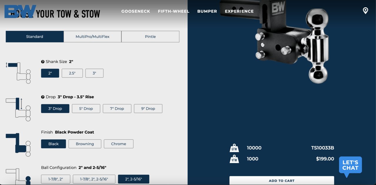

    B&W Tow and Stow have a 2" Ball rated for 7500lbs and the 2 5/16" rated for 10000#
