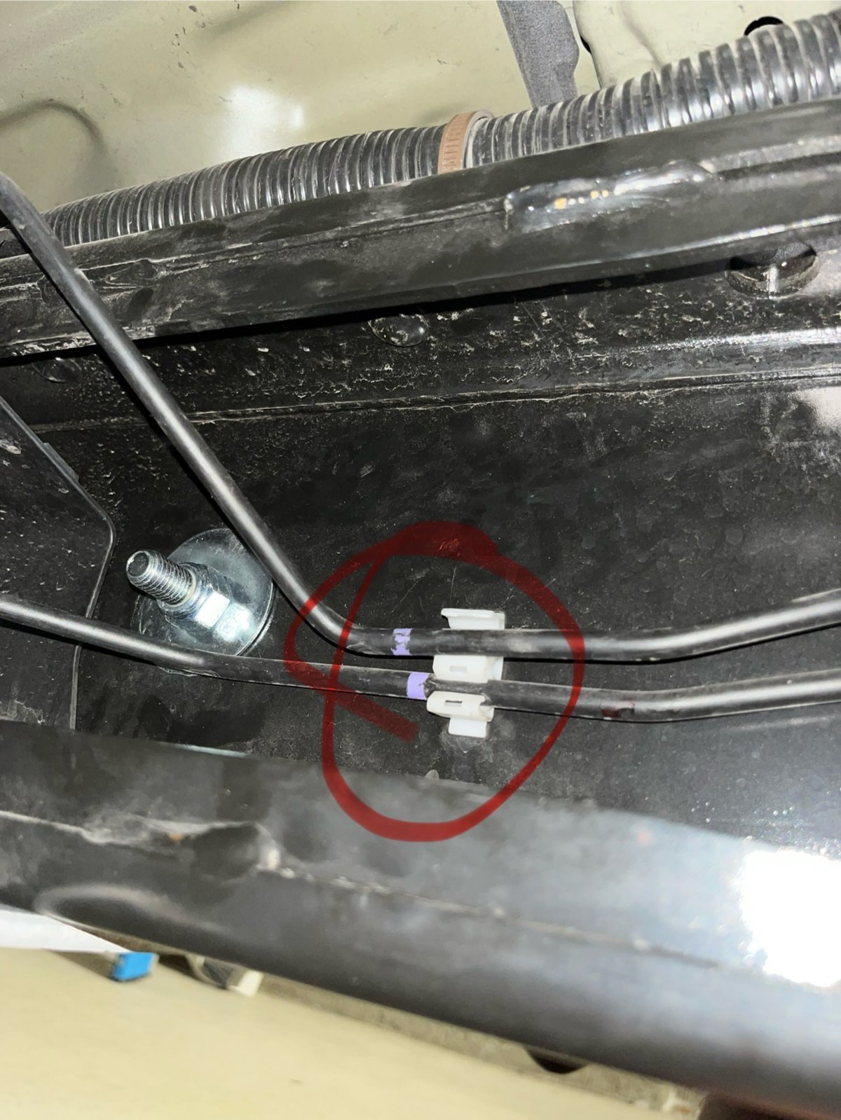

    What is the this clip holding? It runs along the frame on the passenger side. I’m trying to identify the part number but having a difficult time figuring out what it is to begin with. Ty!

    Sorry about that. I meant to attach a photo. Apparently it was too late night. I snapped one of the clips while working on the Talon z bracket so I want to replace it.

    Its called a brake tube clamp, but Toyota uses that description for a lot of variants of it. Go to a toyota parts site and put in the vin or model, year and trim and search that term and see if that matches any of the hits you get. The other thing you can do is try to remove it and see if there is a number on it, but it might break.
    When I search it for my 2020, the attached is what I get.

    I’m having a difficult time identifying the part #. Can anyone help? I have a 2021.
  10. Jul 29, 2024 at 12:00 AM
    33,075
    18" TRD Off Road Wheels
    @Jim LE 1301 gave you a link to the possible part numbers. The part would probably be the same regardless of model year. They barely changed the Tundra from 2007-2021 aside from body work and interior. The underpinning are generally the same.
    If I had to guess I'd say it's Clamp Brake Tube No. 5 from the link he gave you. Worst case, buy one of each as they are cheap, and return the ones you don't use.

    That's what I think it is too; No. 5. Next closest one would be No. 7.
    https://www.toyotapartsdeal.com/oem/toyota~clamp~brake~tube~no~5~90464-a0004.html
    https://www.toyotapartsdeal.com/oem/toyota~clamp~brake~tube~no~7~90469-a0004.html (ignore their first picture. looks like some sort of resistor, but 2nd photo looks right)

    Usually I can figure out part #s but as you can see there is a lot of conflicting info with the various clamps. Yes, it’s the second photo but the first one is something totally different hence confusing. Guess I’ll have to go to a dealership and see what they came up with. In my experience most of the parts guys know less than us though.
