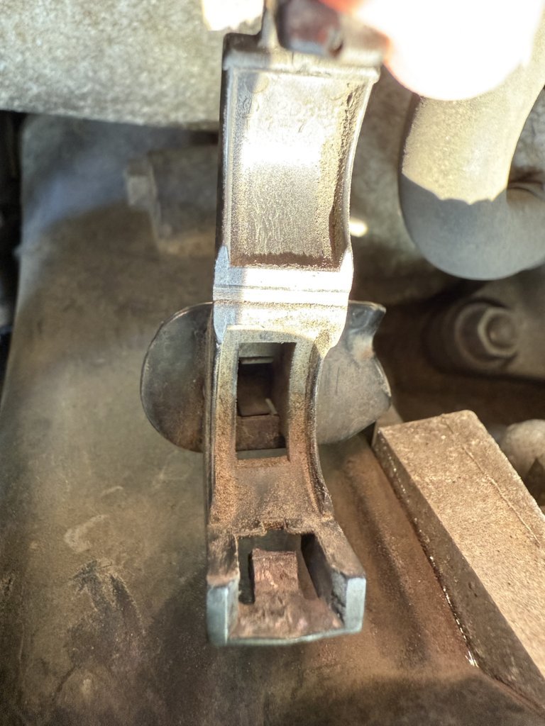

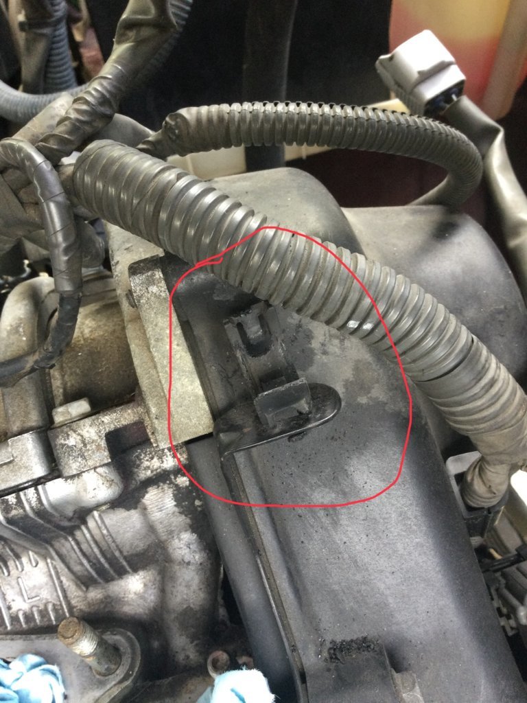

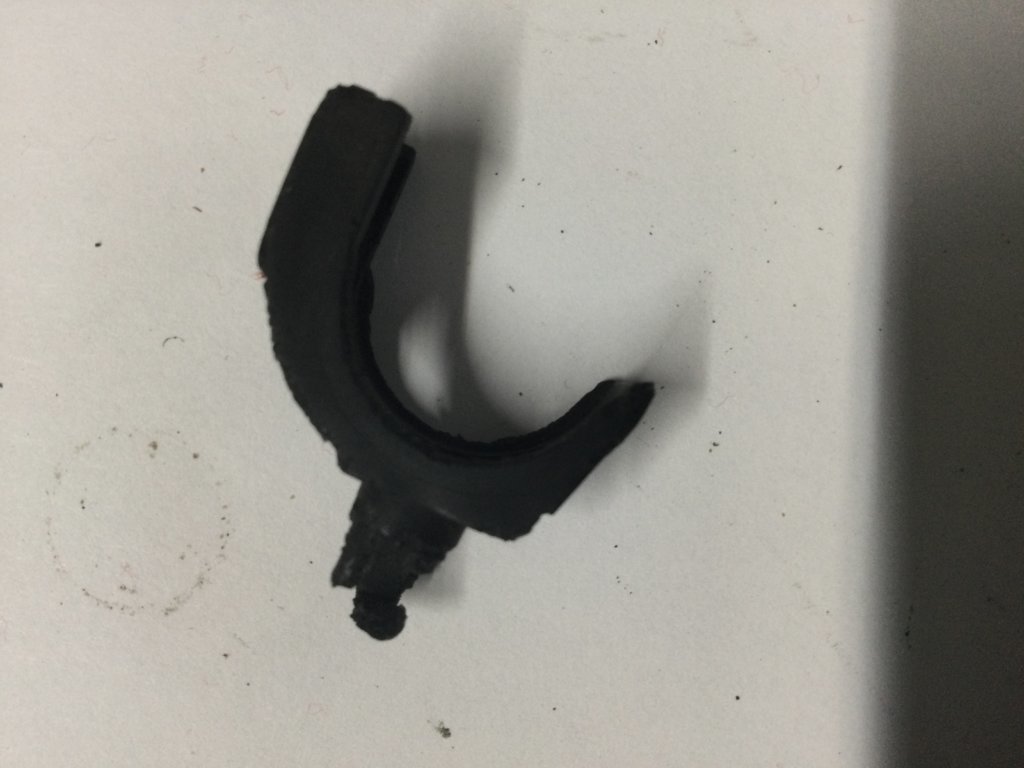

    Normally I’m able to identify the connectors and clips by the tiny 5 digit number embossed on them. This one is too far gone and I’ve not found it in the EPC. Can anyone give me a part number for this? Thanks

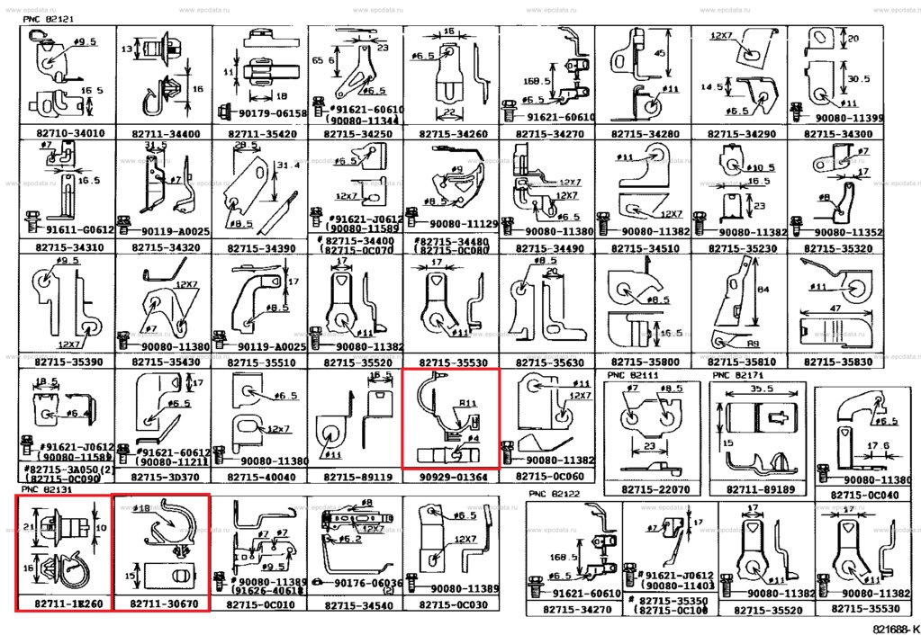

    Hey Bryan, is it possibly one of the three I've boxed here? I can't really tell the shape of what's there. It's pretty mangled.

    Thanks @shifty` - the oval on the bracket measures approximately 6mm by 12mm. Any chance you can take a photo of that clip if your truck has the same clip so I can see what an intact one looks like.

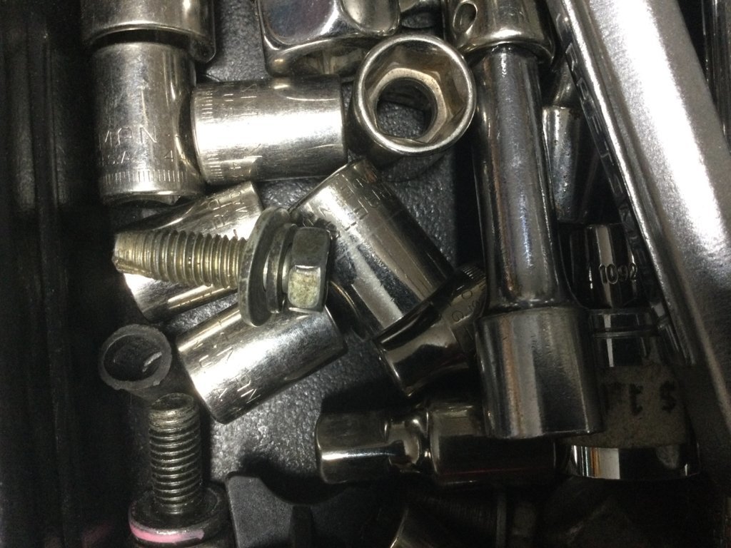

    Thanks @shifty`. I have a neighbor with a 2002 but she’s Not home either. Seems I also misplaced the little bolt that holds the big gray engine harness plastic box to the starter. I think it’s a standard M8 bolt with a captive washer and I was packing up my tools in a hurry when the thunderstorm hit. Hoping this is it.upload_2025-8-3_16-47-45.jpg

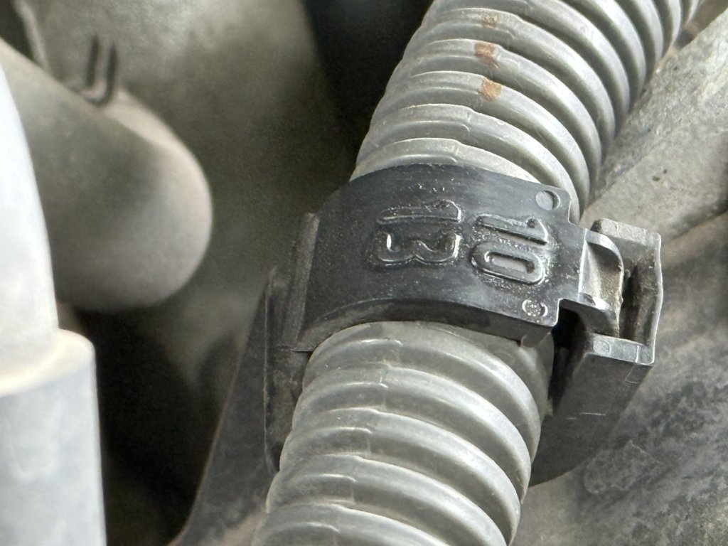

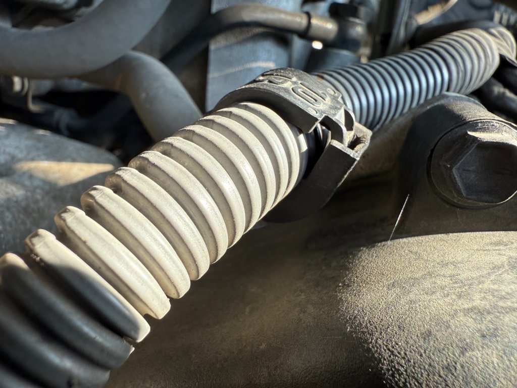

    Is this the clip you’re talking about? Top of the drivers side timing belt cover?
    Has 10 13 on the top. The one on the second row from the bottom that’s marked in the diagram Shifty posted looks right.

    @Upshot Knothole - that might be it. Can you zoom out a little. The big numbers 10 and 13 generally refer to the ID of the clamp in mm. There should also be tine 5 digit number indicating the part number but it may be under or on the side - can you see any such number?

    I looked briefly but couldn’t see one. I’ll check again in a little bit and report back.

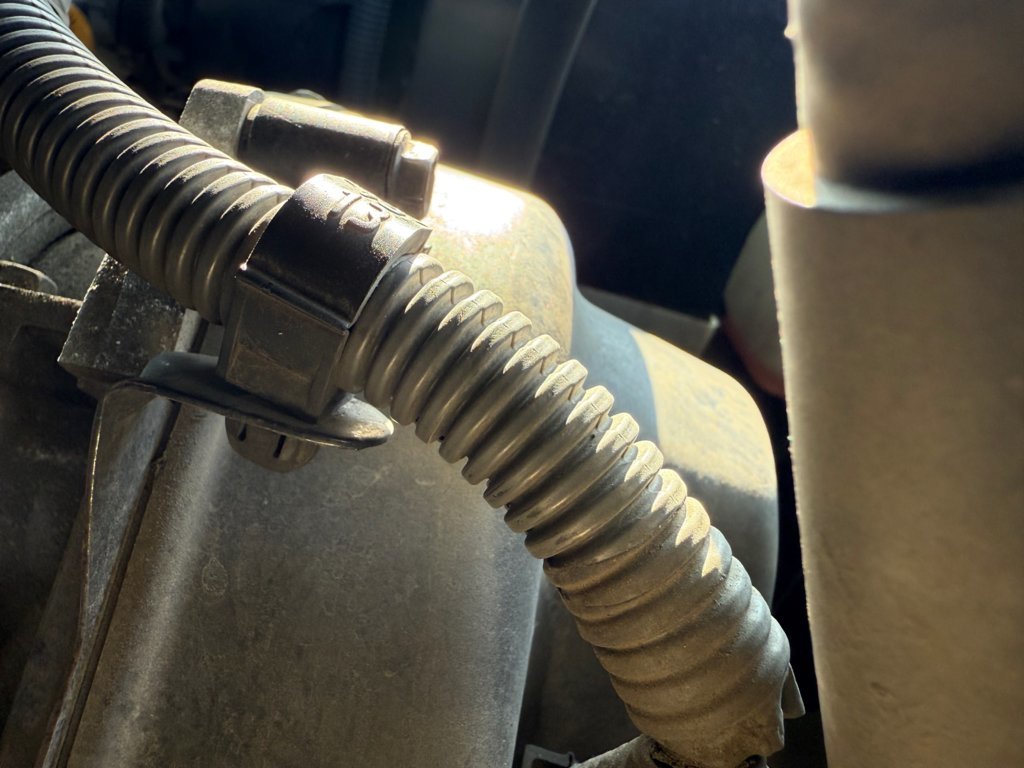

    I looked again and tried taking a couple more photos, without removing it I don't think I'll be able to see a part number on it.

    I think you may just need to pop the clip open, I think it's potentially on the inside edge of the connector but may be wrong.

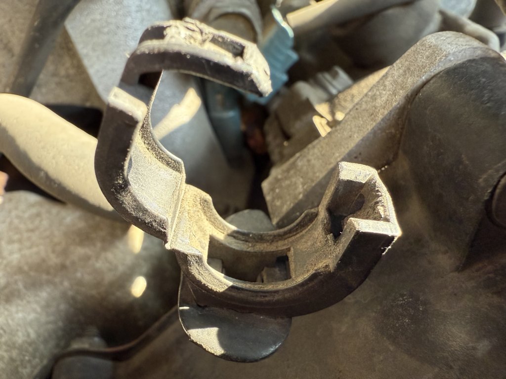

    Can’t see a part number on it. Didn’t bring any tools with me so I didn’t try removing it from the bracket.

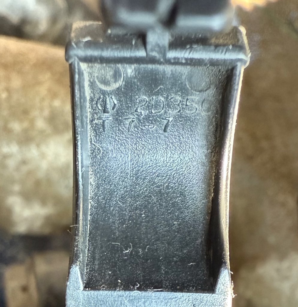

    Now that I look at it on my laptop I see the numbers on the inside of the clip. I apparently didn't put enough spit on my finger to get them legible. I'll try again.
  15. Aug 4, 2025 at 6:25 PM
    Upshot Knothole
    Upshot Knothole New Member
    Sep 5, 2024
    #122480
    356
    Thatchery
    PDX OR
    2003 SR5 V8 AC TRD 4x4
    Best I can do. I tried looking up the number, but not finding anything with a quick google search.
    2D350
    T 7 - 7

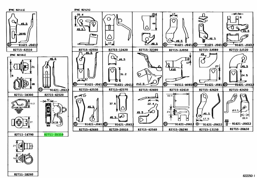

    Think I found it. Baseball game is over so I'm done sitting here searching for it.
    82711-2D350
