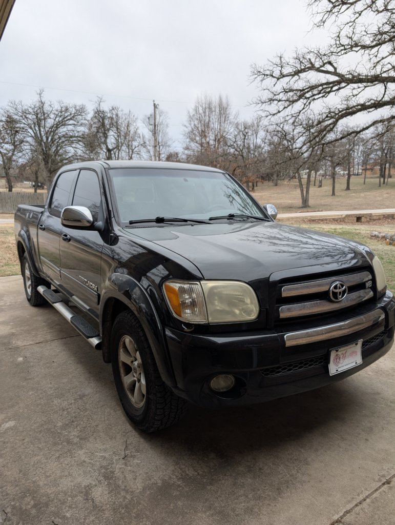

    Thanks! Here is the best picture I have for now. I don't know if you can tell from this angle or not.

    Those are the 4th gen 17" wheels from the TRD Sport
    They have more backspace than the OEM wheels, so the meat of the rim sits closer to the frame. I think its about 15mm or so which is a little over a half an inch. This pushes the tire further inward towards the frame as well, which compounds itself when you turn pushing the tire into the inner fender against the cab.
    Here is problem #1 and #2 that you are about to face
    #1 when you lift your truck, it pushes the A-arms down, and this lifts the truck but subsequently swings the tire even closer to the frame. What you will most likely see with your current tire and wheel combo, if you put a floor jack under the front crossmember and jack up say +1.5" indicating a 1.5" lift you most likely are going to see the tire rubbing the upper A-arm. I suspect you are already crazy close, and with a lift you are most likely going to be rubbing the upper A-arm. This may lead you into needing a different wheel, or a thin spacer to give you the clearance, or maybe even new upper A-arms.
    #2 i already for got what #2 is but if i remember what it is i will edit this post.
    First edit: you likely only need about 1" higher in the front to clear those tires when turning, i suspect they are rubbing the mud flap right now. Those tires are not really too big for the truck, but them sitting in further than normal, i suspect is a compound effect when turning full lock and making them rub the inner corner of the mud flap mount in the inner fender. You should be able to get a flash light and peek around in the fender and see a shiny spot where the plastic shows signs of tire rubbing.

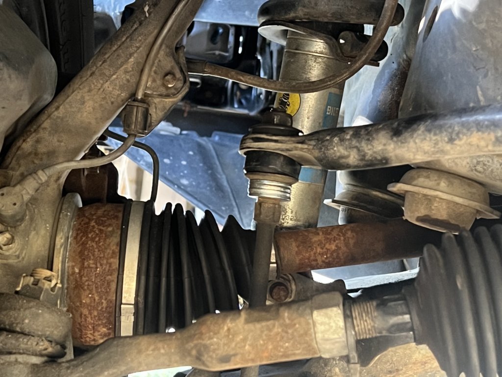

    Stock link “mod” for leveled FGT
  9. Mar 10, 2025 at 6:38 PM
    shifty`
    shifty` Just like witches at black masses
    Jun 20, 2020
    #48239
    28,377
    ATL
    '06 AC Limited V8/4WD
    In case it's not obvious to anyone, note the ~3/4" stack of washers under the bushing.
    I always appreciated this "mod" :rofl:
    (Although the lack of threads up top is not ideal)

    The nut is fully engaged with threads, about 1-2 threads sticking out the top :D
