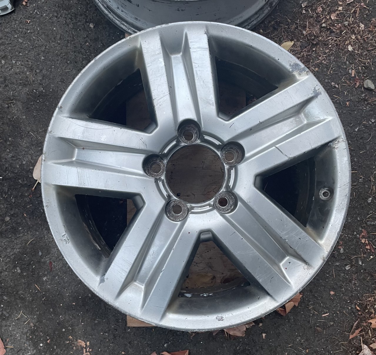

    So my 2011 has the 17” Rock Warrior wheels, which are using lug bolts (no studs on the wheel hub). I’m going to be mounting some 20” Sequoia rims with H/T tires for a big road trip, and realized the lug bolts aren’t the right ones for the “new” wheels. Do I have to install hub studs and get lug nuts for these 20” alloys? Or is there a set of lug bolts that would work?

    This is what the lugs look like that you need vs the rock warrior lugs. If you can find a wheel bolt with a flange like these lugs then it should work. I don’t know your rock warrior would be setup with wheel bolts instead of studs/lugs; curious. Post some pics of the hub flange and wheel bolts if you don’t mind..
