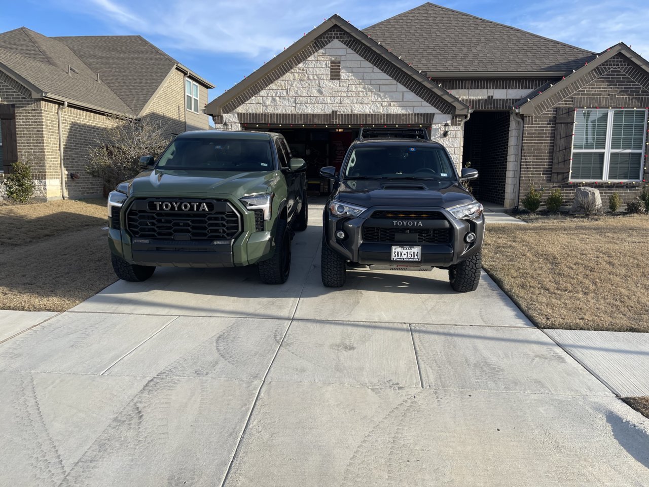

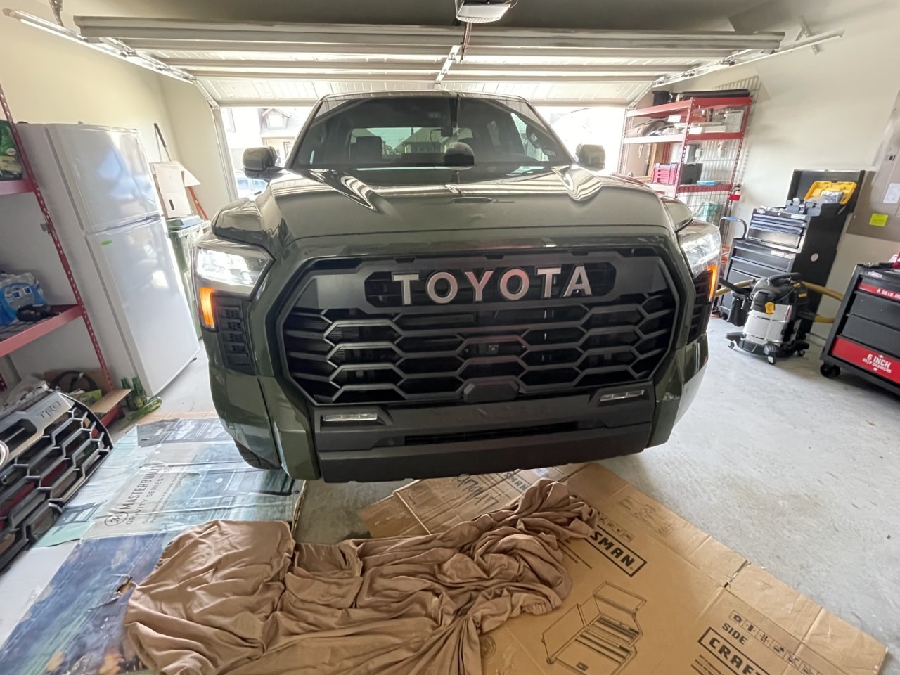

    Hey all,
    It’s been a while but back with an issue. After waiting months for it to cool down & have some time off, I finally got around to installing the heritage grill & chrome deleting the Tundra.
    The issue? Now I’ve got airbag & lane departure warnings. I already have my 10K appointment at a dealership on Friday but was looking to see if there was anything I could do beforehand to get these errors to go away.
    All the connections are there & good to go. Not sure what I did wrong…
    Thanks! 128FF7F4-EEE5-40D3-B1D7-B42959B9670A.jpgB7E92B1E-87E1-4A93-8990-24F3E767324F.jpg
