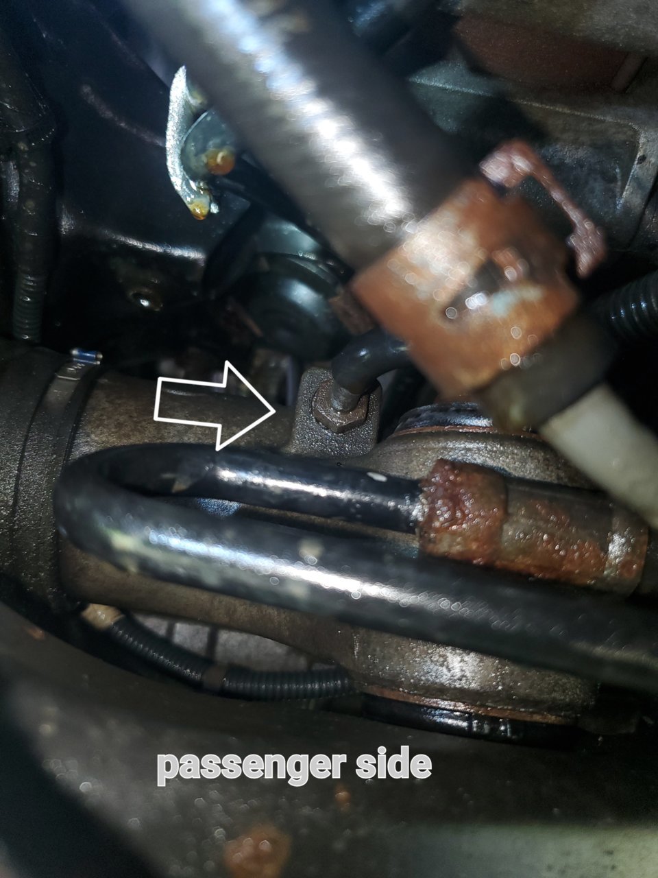

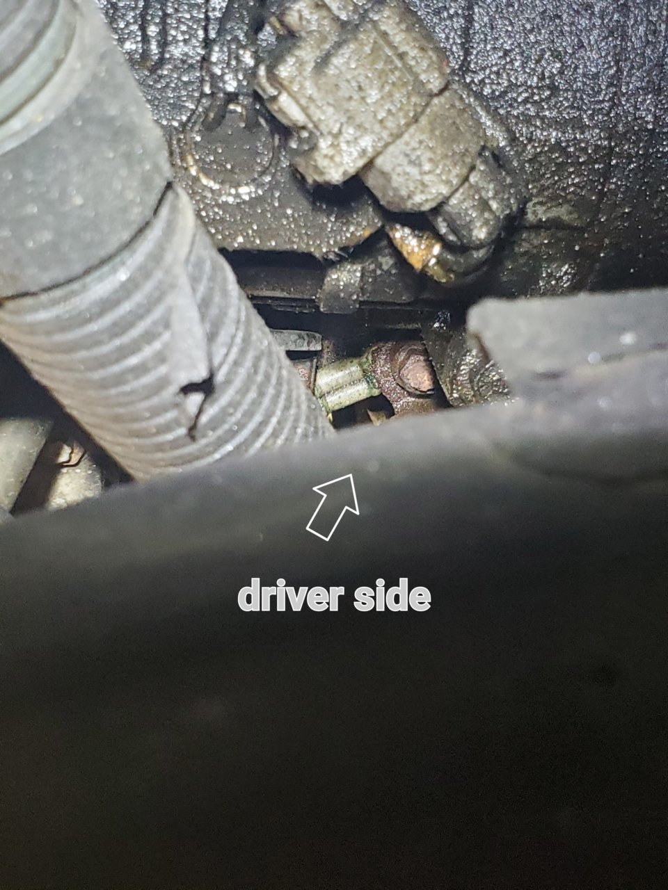

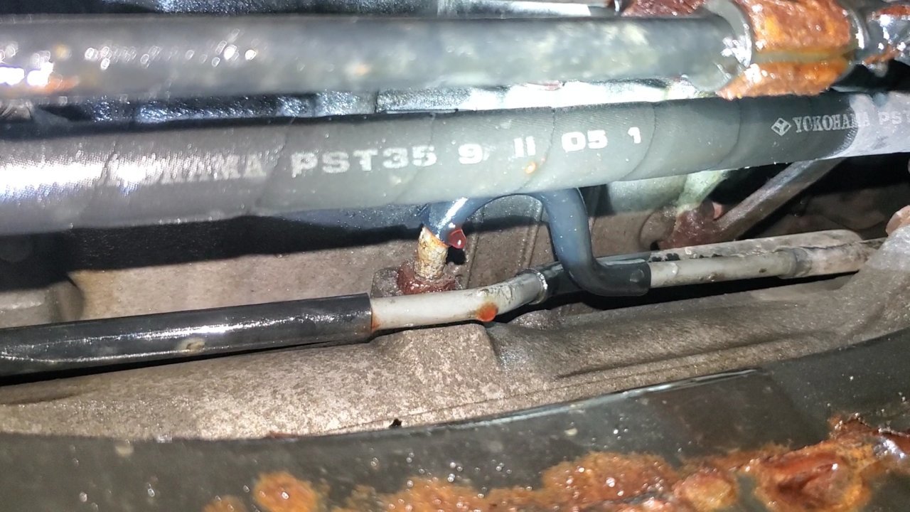

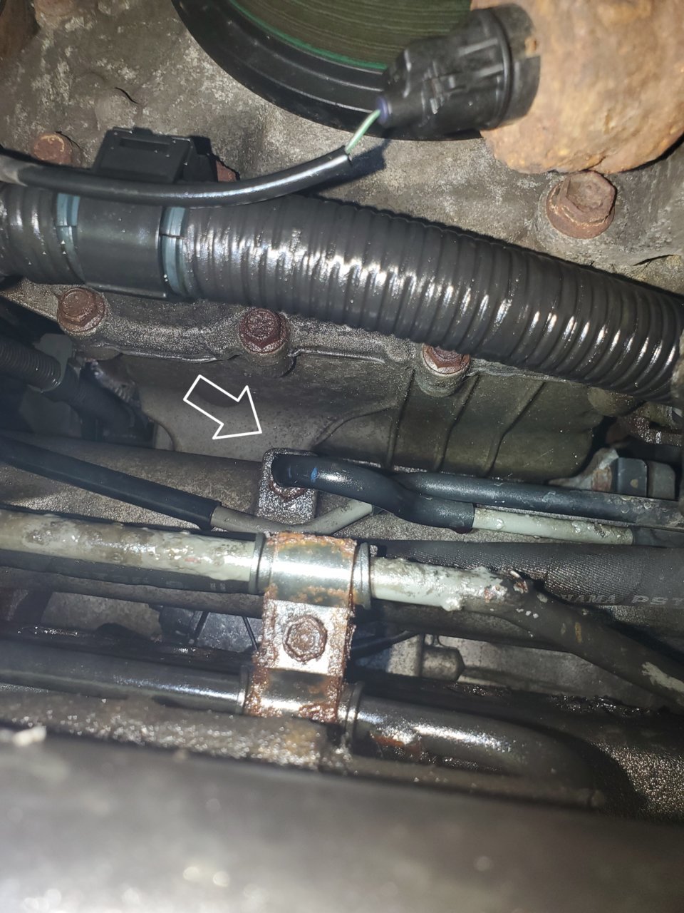

    My issue is with my 2010 5.7 Crewmax. It dumped all the power steering fluid yesterday. I found the issue, but I'm not sure what the line is called. It seems to make a loop to 3 places. The leak itself is within an inch of where the line comes off the front of the steering rack. It appears to run towards the driverside where it goes into ( and possibly) out of the rack again. And then doubles back following the other line past the leak to the passenger side. I'm not sure if I'm capable of this repair myself, I'm a decent (ski lift) mechanic, but might not have the proper tools to reach some of these spots. Looking for what this line is called as well as any input to a repair procedure. Thank you all for your time.

    2010 Crewmax
