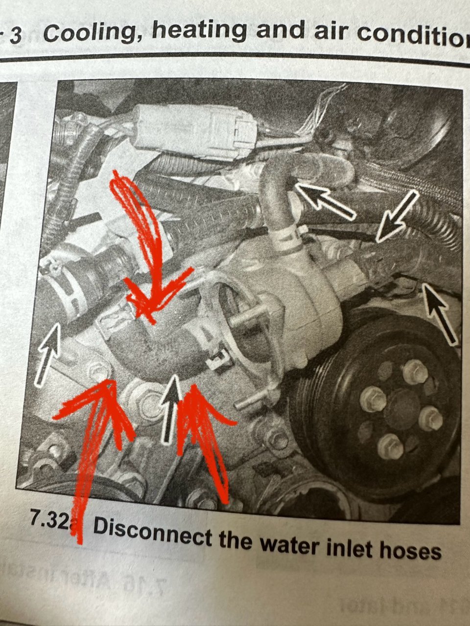

    I recently replaced my radiator/thermostat/water pump. Today I found a leak from a hose that I probably damaged in the process.
    I can't find any documentation for the size of the hose to order a replacement, and I'd like to get the replacement part before removing it. I also need replacement clamps.
    The hose attaches to this pipe on the thermostat housing, on the same side the thermostat attaches:
    It's probably 5 inches long with about a 90 degree turn and a 1" outer radius.
    Here's a pic from Haynes which tells me nothing about it.
    Thank you!

    Assuming it's a 5.7L and tow package.
    1626738020 90 degree hose
    9613652101 clips

    Thank you, that looks perfect. For future reference, how did you find those part numbers?

    stealership parts website I use conicelli toyota.
