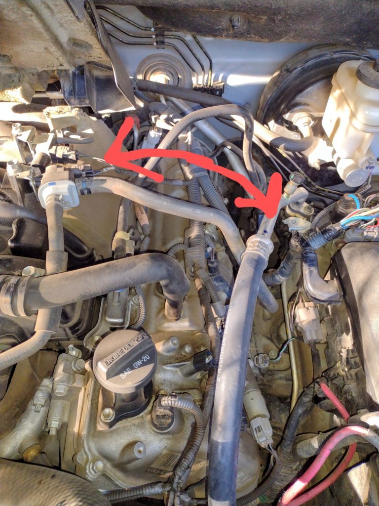

    Hey there, can someone help me identify this hose? I need to order a replacement because it has a small hose and is triggering an engine code for a leak from time to time. It runs from the evap purge valve down to a pipe, from the intake manifold area. Thank you.

    Unless your adiment about getting a OEM replacement, I would just get vacuum hose and call it good.

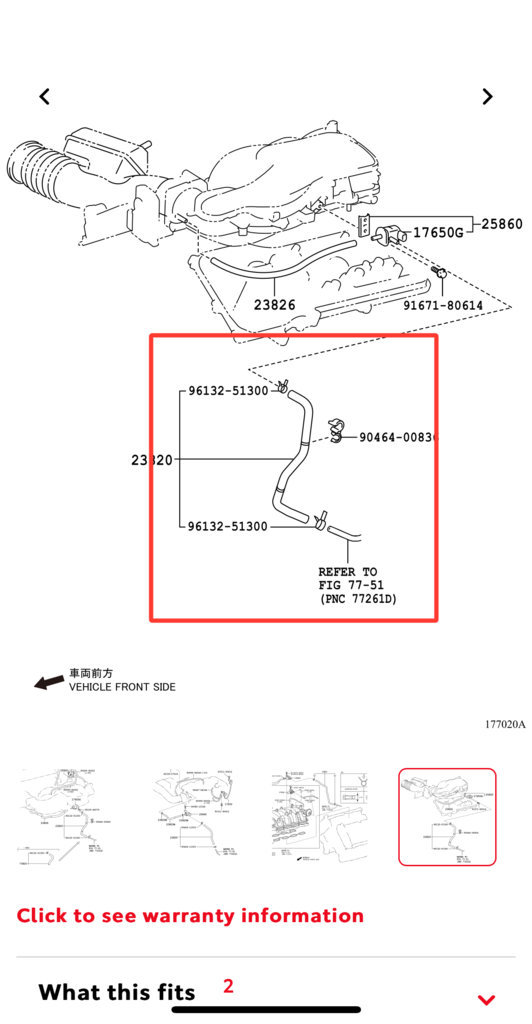

    I searched for quite a bit, but boy do the Tundra parts diagrams online SUCK.
    I’m definitely not 100% sure, but I believe it’s part number 23820-0S050 and called a “fuel vapor feed hose”.
    Talk to your local dealership or something to verify. I, for the life of me, couldn’t find anything conclusive with the lack of user friendly diagrams.
    mountainlyon[OP] likes this.

    Thank you Jmanscotch! I think you are spot on with this identification. I'm going to order the hose right now.
