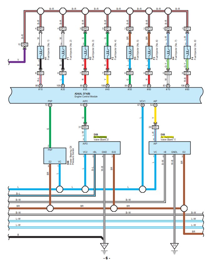

    I accidentally pulled the harness off the wires so now I got to find color that goes on the valve for the secondary air injector on the left side of the engine, which I believe is bank 2.

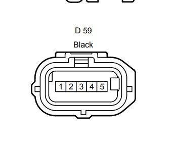

    Maybe?

    I knew what he meant, but you're right about posting in the future..
    Did I find the right thing @shifty` :confused:

    Yes!!!! That will work, I appreciate it very much!!!!

    You absolutely did! That's why I liked your posts, top notch job.
