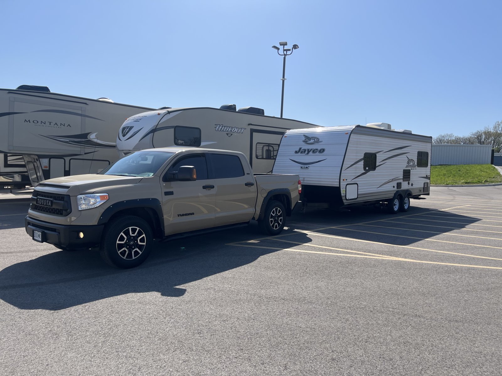

    Home in one piece. No sway, no issues. Went about 65 mph all the way home.
    Got the OEM tow mirrors ahead of time. Had the brake gain set on max 10 didn’t seem too strong really so I need to spend some more time better understanding setup on that or possibly I need the reflash IDK.
    Anyway, thanks again to all that helped with advice, I felt prepared for the day today.
