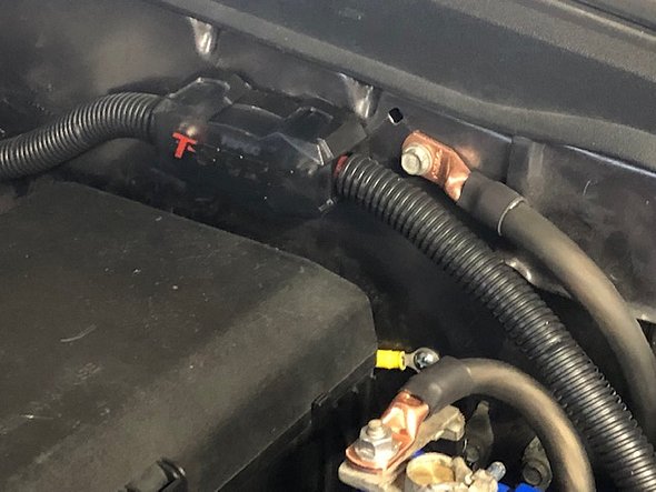

    I would start at the condition of your battery terminals. Then follow the negative wire to the point they ground. I'm guessing you will find your problem....If you know what to look for.

    Yeah the main chassis ground is close to the battery on the inside of the fender. Any aftermarket electronics? I've found this truck to be sensitive to electrical mods.

    Clean those posts and clamps.

    The one on the right that mounts to the fender.
    Replaced mine with 0 gauge.

    Yeah I’ve cleaned the posts and have brand new terminals as well. The ground by the battery on the inside fender looks good too.

    Keep following the ground. You've got a weak connection somewhere that fails only when the conditions are just right.

    Followed the ground, I can’t tell if anything is wrong or not. Not sure what to look for either I’m not too mechanically inclined. A lot of ppl telling me they think it’s the alternator. But I figured if the alternator was going bad, it wouldn’t just happen randomly. Maybe I should just replace it anyways and see. Or spend the 200 and take it to the dealership for them to look at it and hope they figure it out
