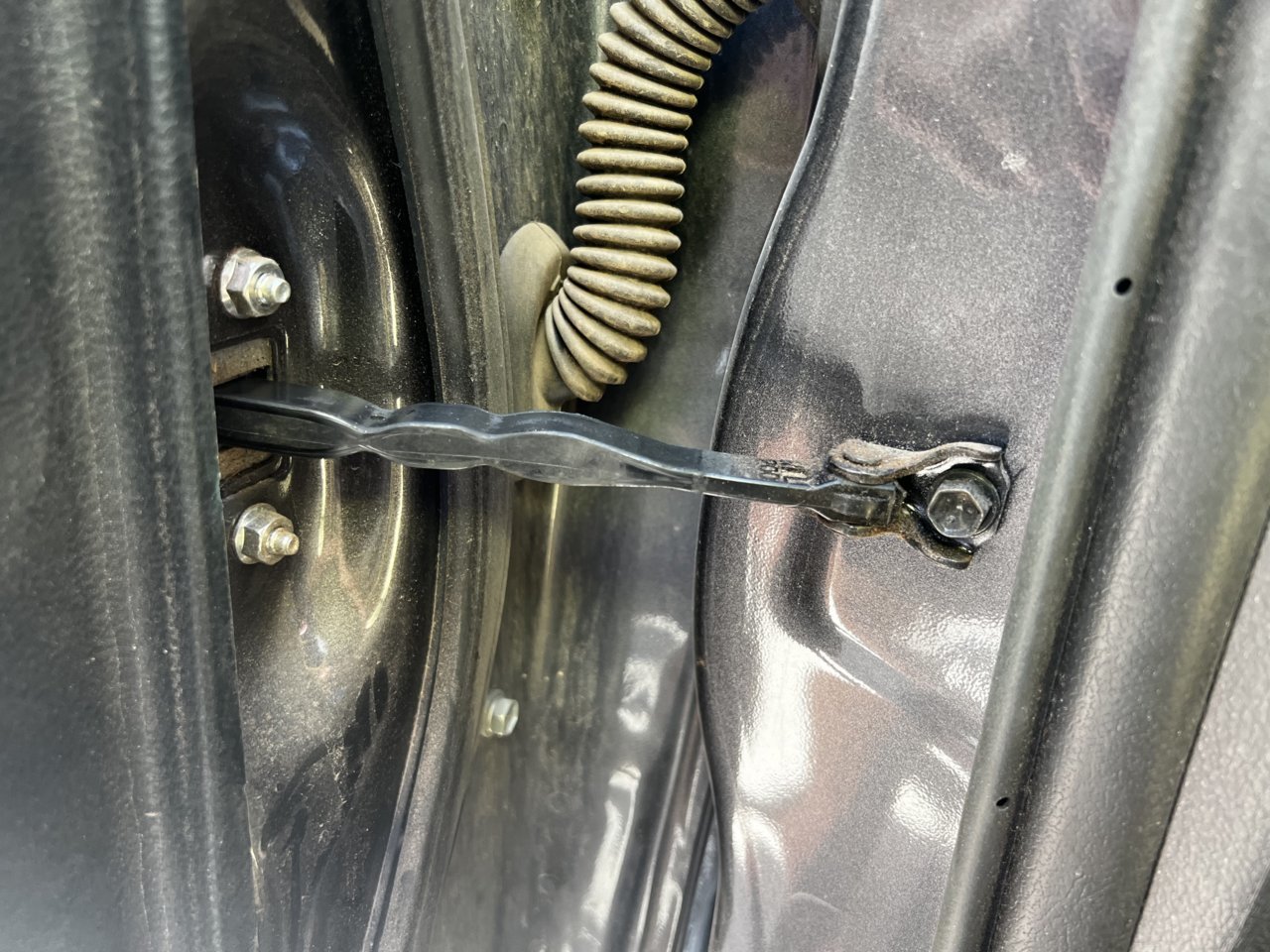

    It sounds like the check strap. I would remove the inner door panel card, and look. You don't want something loose on the inside of the check strap mount being loose- you could bend or wreck it.

    It’s a clunk only in one spot in the opening and closing process, it’s like it catches in that one spot. No rattles or sounds while driving

    Check the pin connecting the door check to the mounting backet on the b pillar. They can develop play and make that cracking noise as you pass over the detents in the door check.

    I had this on the same door. One side of this needed tightened.
    pretty sure it was the two nuts on the door side. I threw some blue loctite on when retightening.

    This is most likely it. I had to tighten a bolt on my front passenger door when i first got the truck. Ill chalk it up to covid in the manufacturing process.

    just got home and checked and the nuts were loose. Looking for my loctite now.
