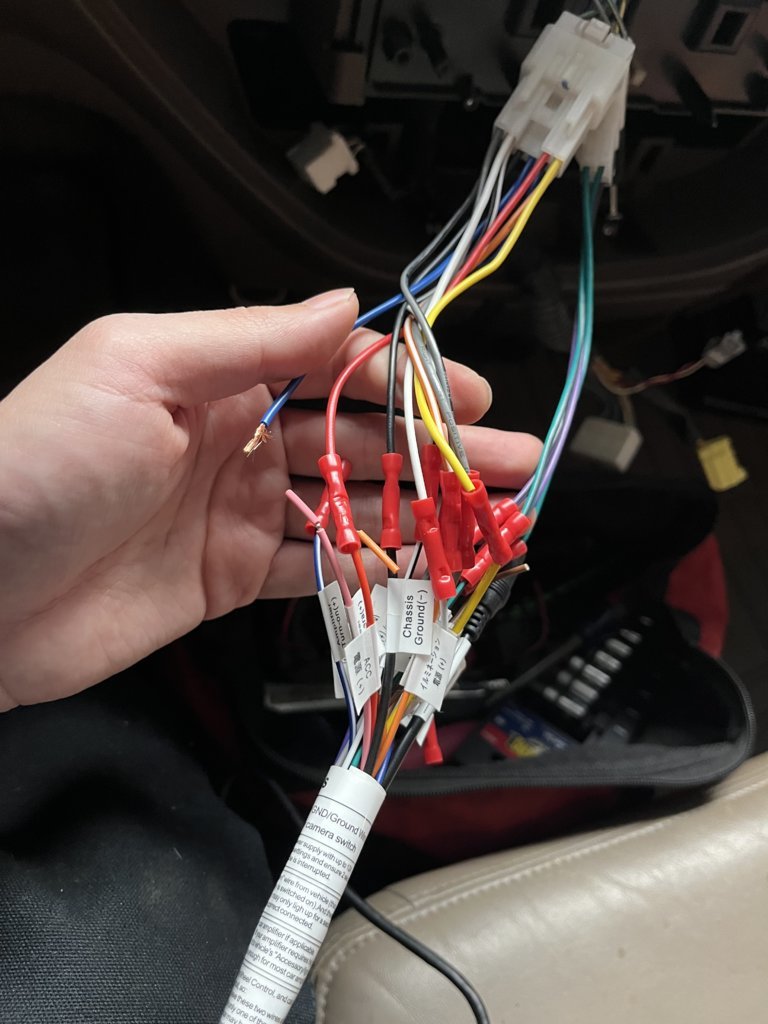

    Update and clarification
    Installation is for a 00 with factory amp. I did removed the factory amp and used a bypass harness.
    Both 15amp radio fuses (acc and comm) are good
    Still troubleshooting

    Are you trying this with the ac bezel/controls disconnected?
    Iirc it has to be plugged in for the radio to get power.

    You are absolutely right my good sir, thank you so much

    I just learned this fun fact when I went back in to hook up the mic on my Alpine (that I didn't think I'd ever use).
    Panic set in for a second until I figured that out :rofl:
