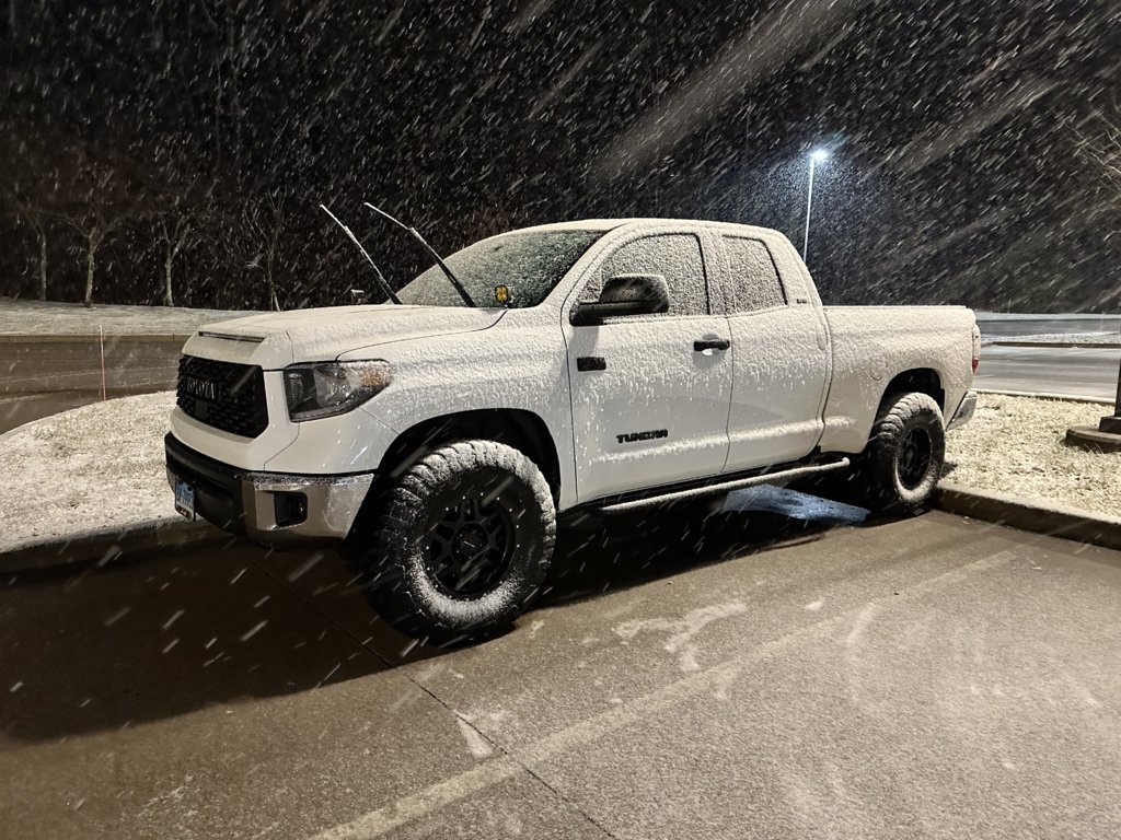

    My truck is on 5100s all corners with front at top setting (2.3”) and rear at 3/4” lift.

    Thanks for the advice, also love the look of your tundra, what size tires are you running?

    Thanks! I’m on 37s.

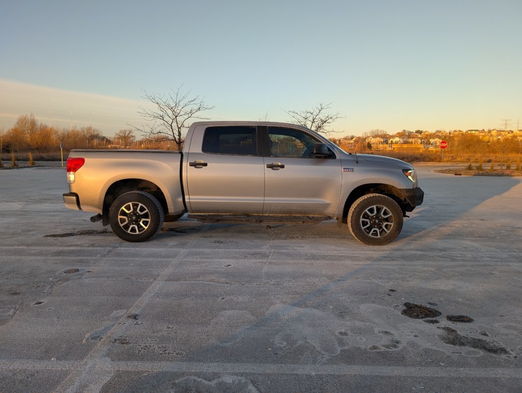

    I have 5100s on front, top setting. 1.5 inch spacer blocks in rear. ( from PO) Was hoping to be able to remove spacers and be level. Not the case.
    My truck sits level like this.

    That's weird. Your rear springs must be pretty sagged out. 5100s on top setting should be pretty close to stock rear...

    Most likely

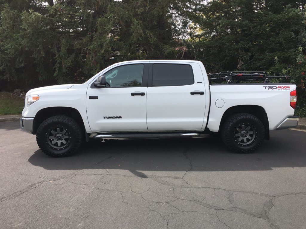

    My first suspension upgrade was 5100s all around. I set the fronts at the middle setting and added a CB shim to each side. Total lift was about 2” - a little less than going with the 3rd setting and no shims. (2” is also what the TRD Pros are lifted). This made the truck level and because the coils were not as compressed, the ride quality was not impacted. IMG_2090.jpg

    This is what my target was. At the last minute I decided to use top setting. Hopefully in the spring I can correct this and get rid of the rear spacer blocks.
