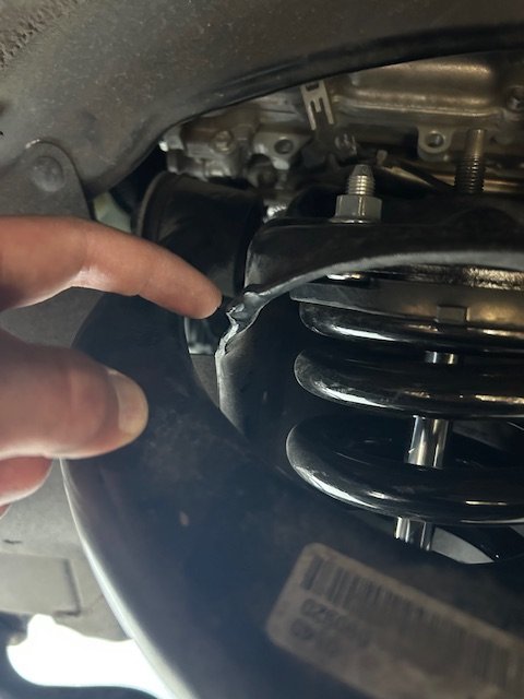

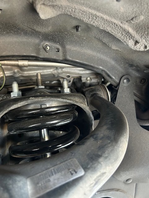

    I need some help addressing a clunk I'm getting post-suspension install. When hitting small bumps at low speeds with wheels straight or only slightly turned, I'm hearing a clunk from the front wheel areas. Figured it was the skid plate (stock TRD OR plate) but the skid plate is so small I can't figure out where it could possibly be hitting, and I don't see any marks or dents on it. I did notice some bent metal on the driver side strut tower housing (see photos.) The passenger side isn't as bad but does show some signs of wear.
    Has anyone had similar issues? My initial guess is I will need aftermarker UCAs, but since I'm still on stock tire size I would be really surprised if I need to go aftermarket UCAs. Anyone have other ideas what it could be? Anything I should recheck with the sway bar maybe?

    that strut tower ding does not look fresh.
  5. Oct 15, 2024 at 9:42 AM
    akshorts
    akshorts [OP] New Member
    Oct 15, 2024
    #124271
    13
    2021 CMAX with 6112/5160s
    Agreed. The truck only has 42K on it, so I wondered if that was a factory blemish. I didn't notice it or pay attention while I installed the suspension. Also going to re-check torque on LCAs today since another thread mentioned it. Side request, has anyone found a decent resource for torque settings on these trucks? I have to piece meal things from the interwebs.

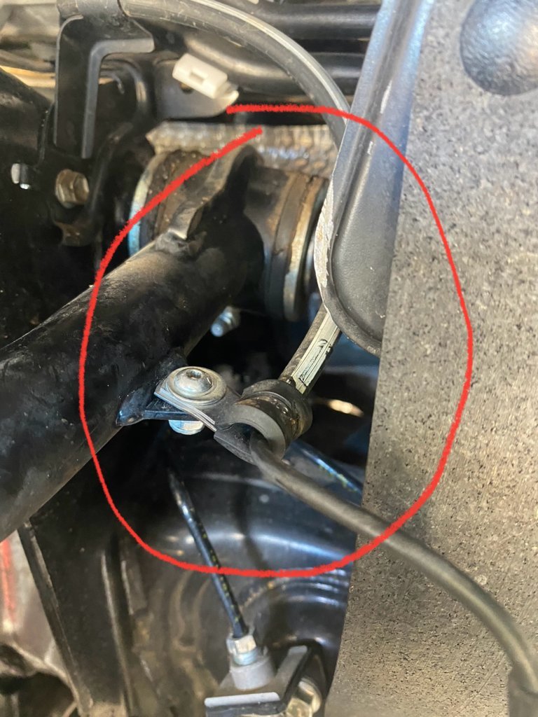

    BillyB
    BillyB New Member
    Sep 26, 2021
    #68556
    1,322
    Billy
    AZ
    2021 SR5 TRD Sport 4x4
    I had a clunk on my old truck as well after installing 6112's. It was hitting in this area, from the ABS bracket (I think) onto the fender.
    crikeymike and AZBoatHauler like this.
