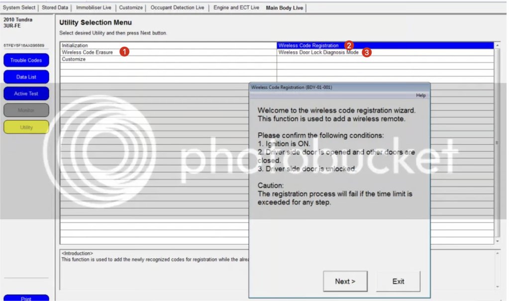

    To present day, I have installed the keyless entry door control receiver on the passenger side C pillar. Running VCI J2534 with V17.00.020 version 1.4.8 Techstream. I was able to connect to the vehicle and got to Main Body --> Utility where I should be able to program the key fob but I was missing the options for 1.wireless code erasure 2. wireless code registeration 3. wireless door lock diagnosis mode. (the screenshot below is from another post that I am using as an example).

    The ask: Is there a reasonable way to add wireless etc functions back in to my car using techstream or other means?

    Go to "customize" within the main body ECU and make sure the Wireless Control is set to ON.
    Apparently it can be set to On or Off, I wonder if yours is Off from the factory and you just need to enable it
