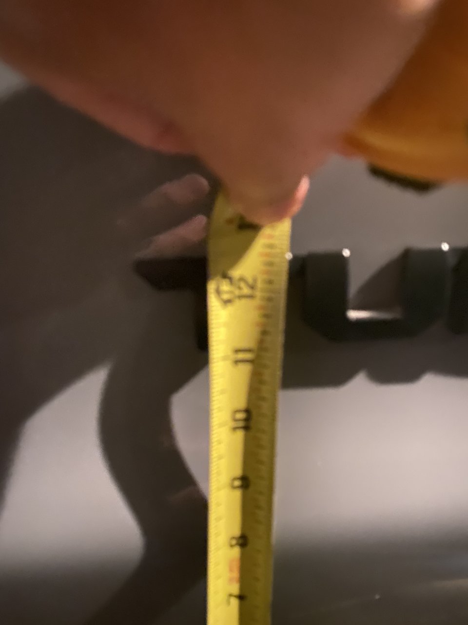

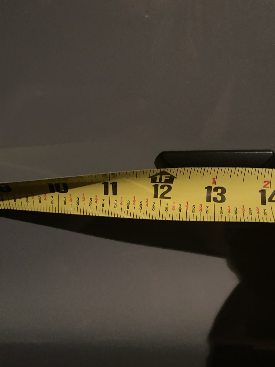

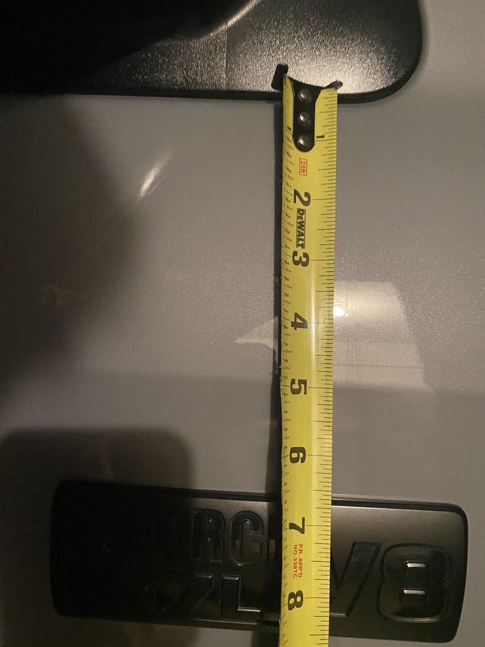

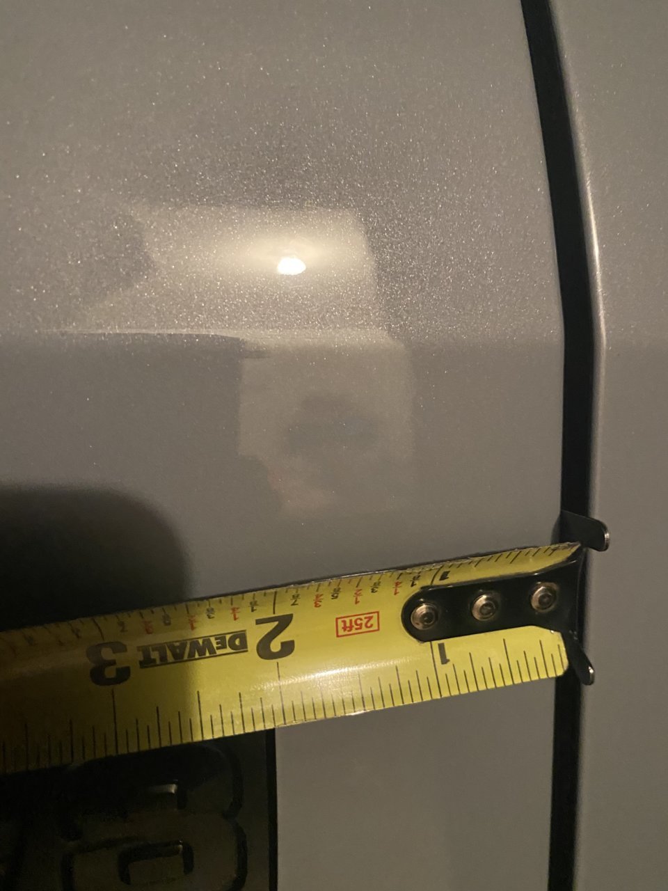

    I have a 17.
    Too dark to snap the 4x4 on the tailgate but if you need it let me know and I’ll get it tomorrow
    The up from the bottom was about 12 1/4. Because of the curve of the door I just put it on a flat edge and measure. Then from there to the edge of the door for left it right. Hope it helps
    9C7B14F4-35AB-4D91-BE07-DB18222D66E9.jpg 661CDC68-19E9-40B3-AB94-051A0F9A3813.jpg A321F01E-FAF6-4079-9BA5-9500528D739B.jpg 05EDB320-C112-4AF8-BF7E-D20AF12FE6F4.jpg

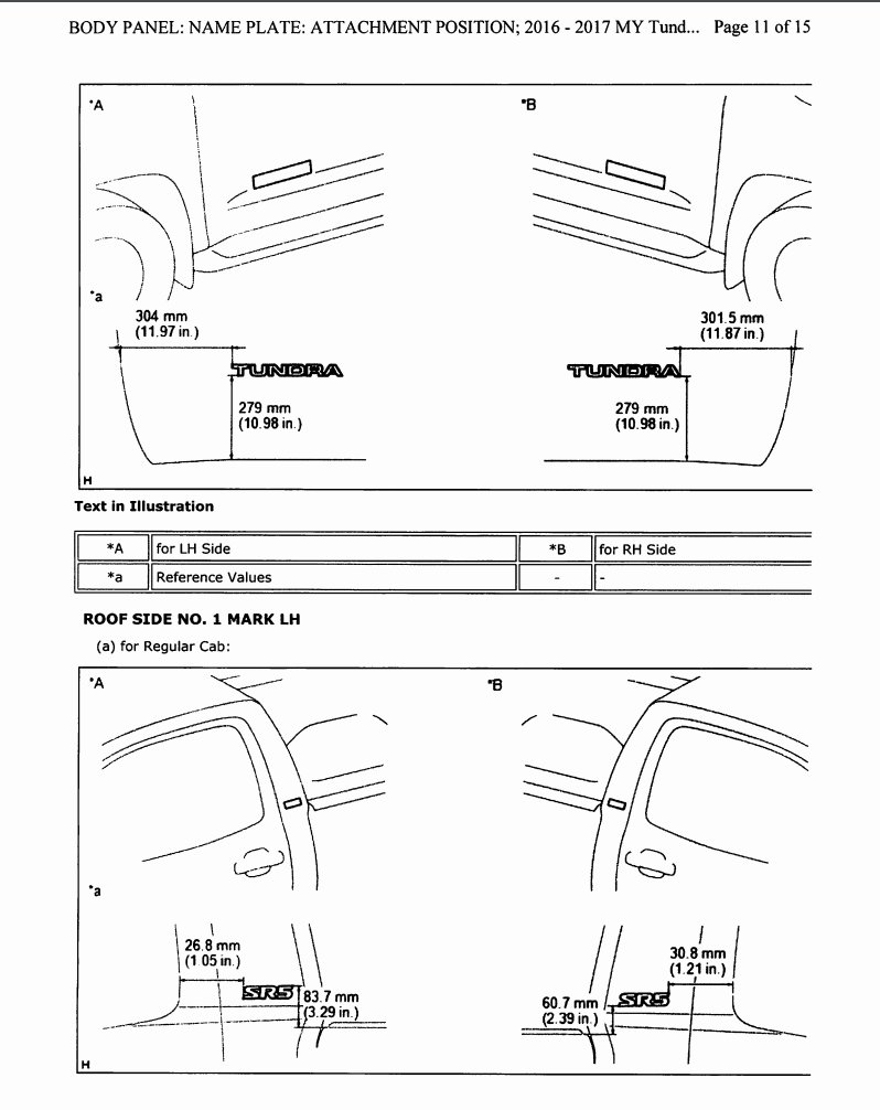

    Found this....

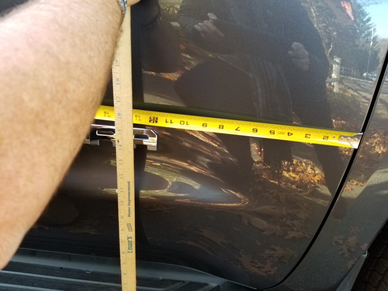

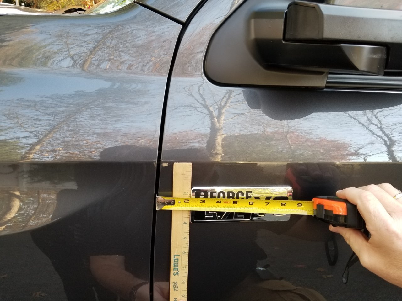

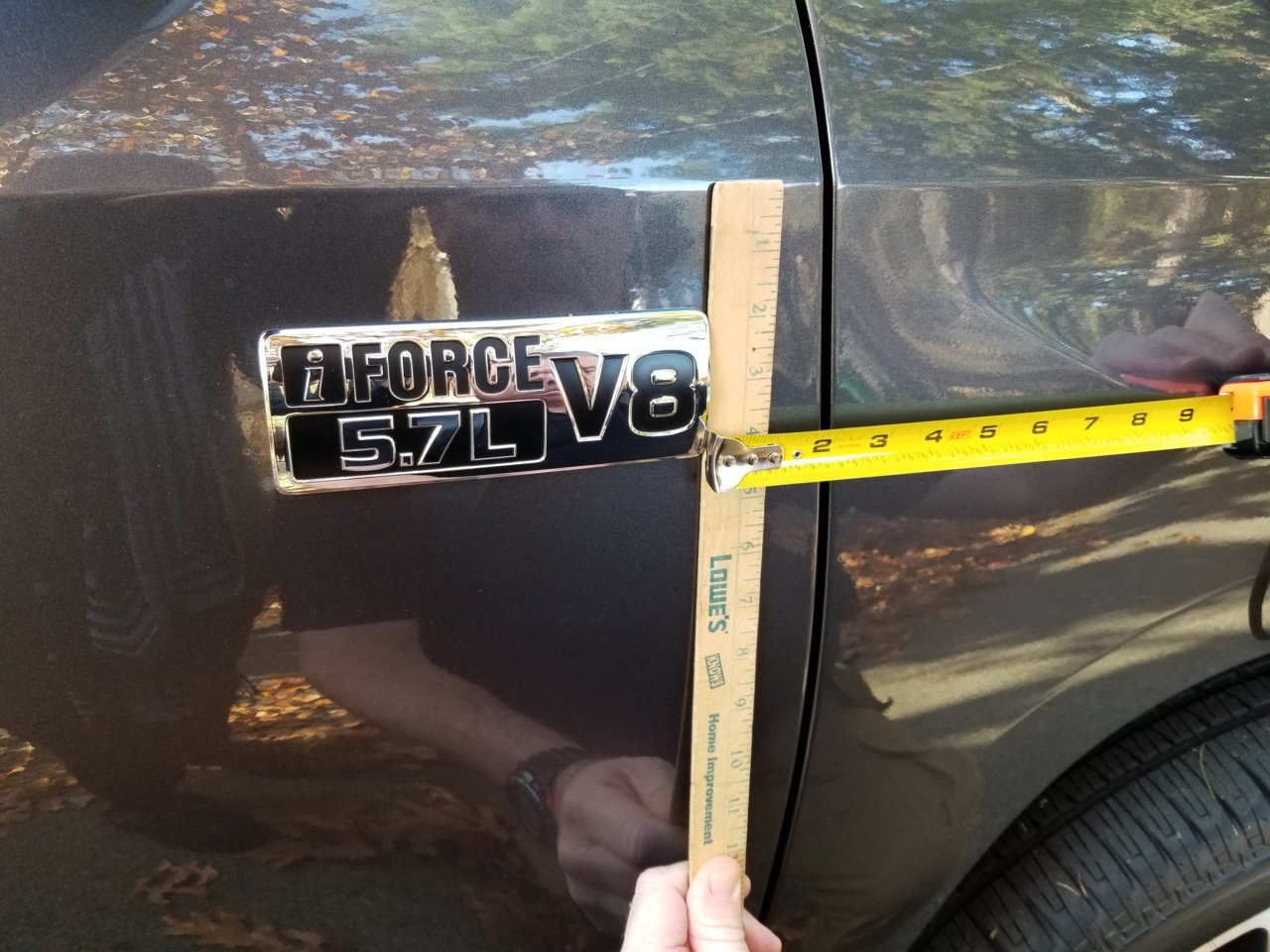

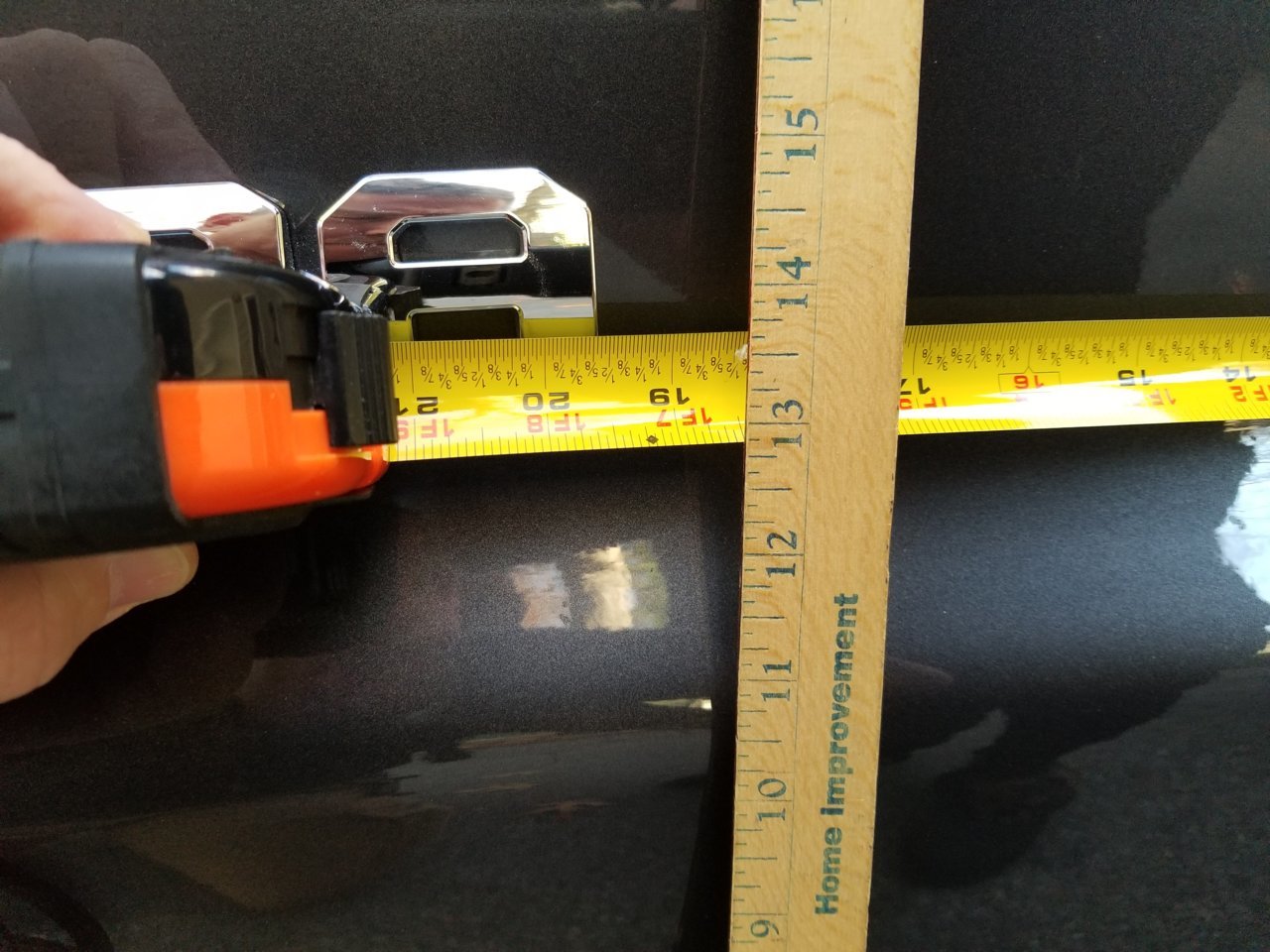

    It could have been my post. I'll look.
  10. Oct 4, 2022 at 7:48 PM
    29,568
    20181111_142441.jpg 20181111_142403.jpg 20181111_142337.jpg 20181111_142314.jpg 20181111_142150.jpg 20181111_142057.jpg
