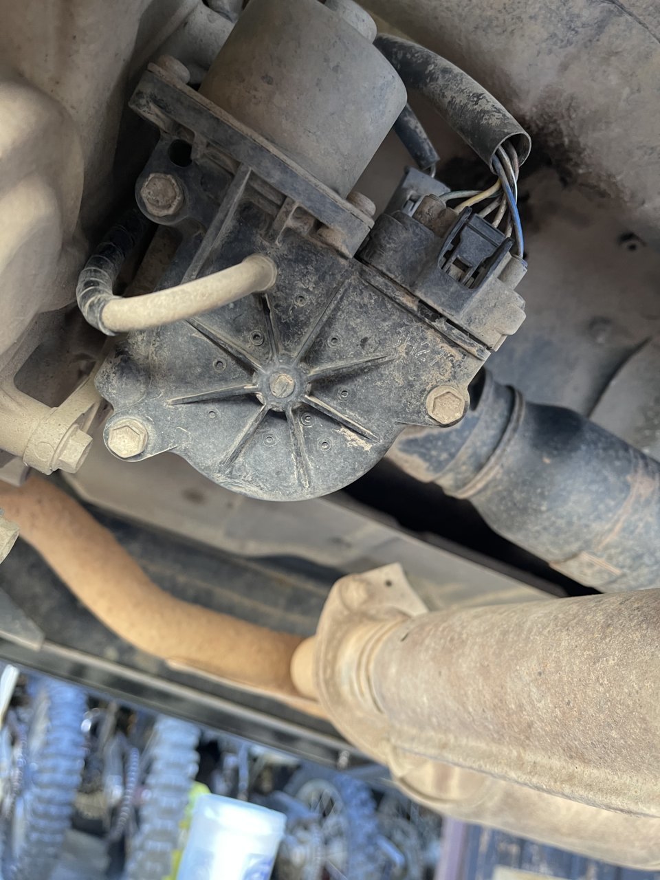

    Update: Think I may have found the issue.
    I'm 90% sure that is actuator vacuum line. Which I think is supposed to be in that hole? Anyone ever put one of these back in?

    Yeah. Thats an easy one. Clean off the nipple up high and slip the hose back on. Mine did this a long time ago and I put it back with no problem.

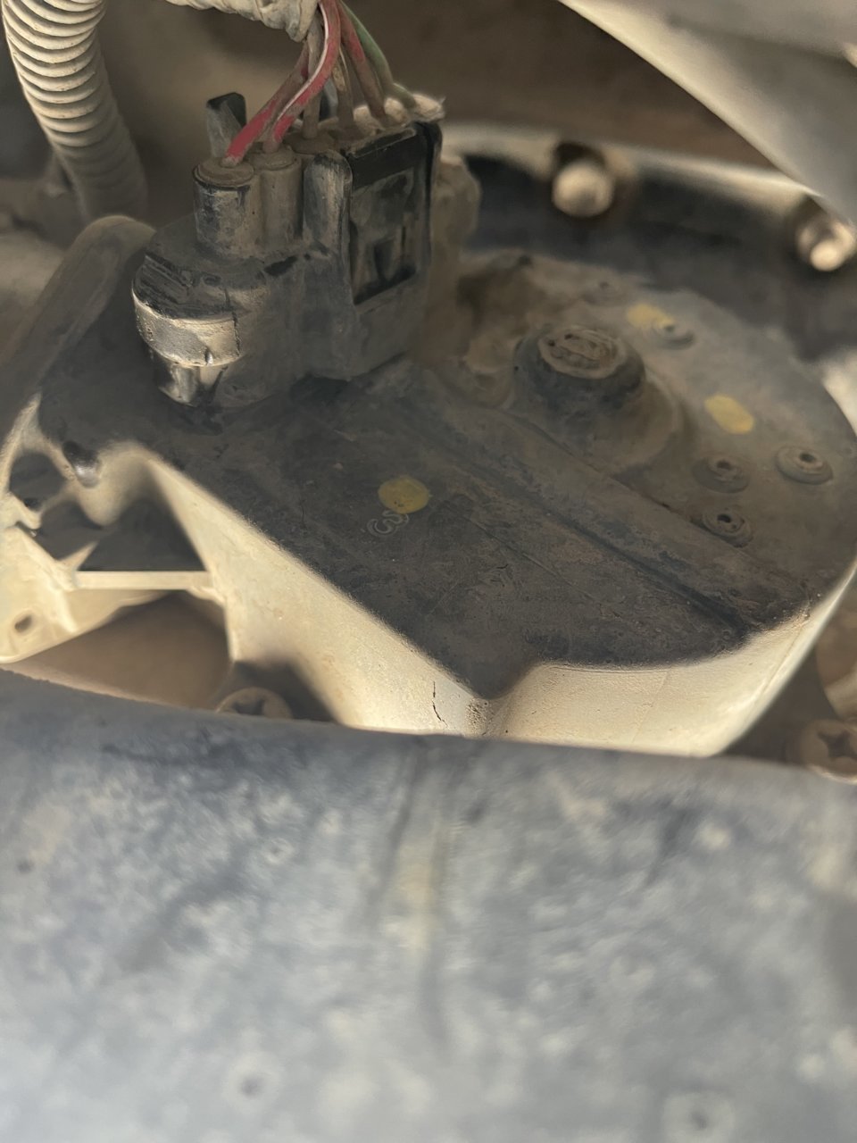

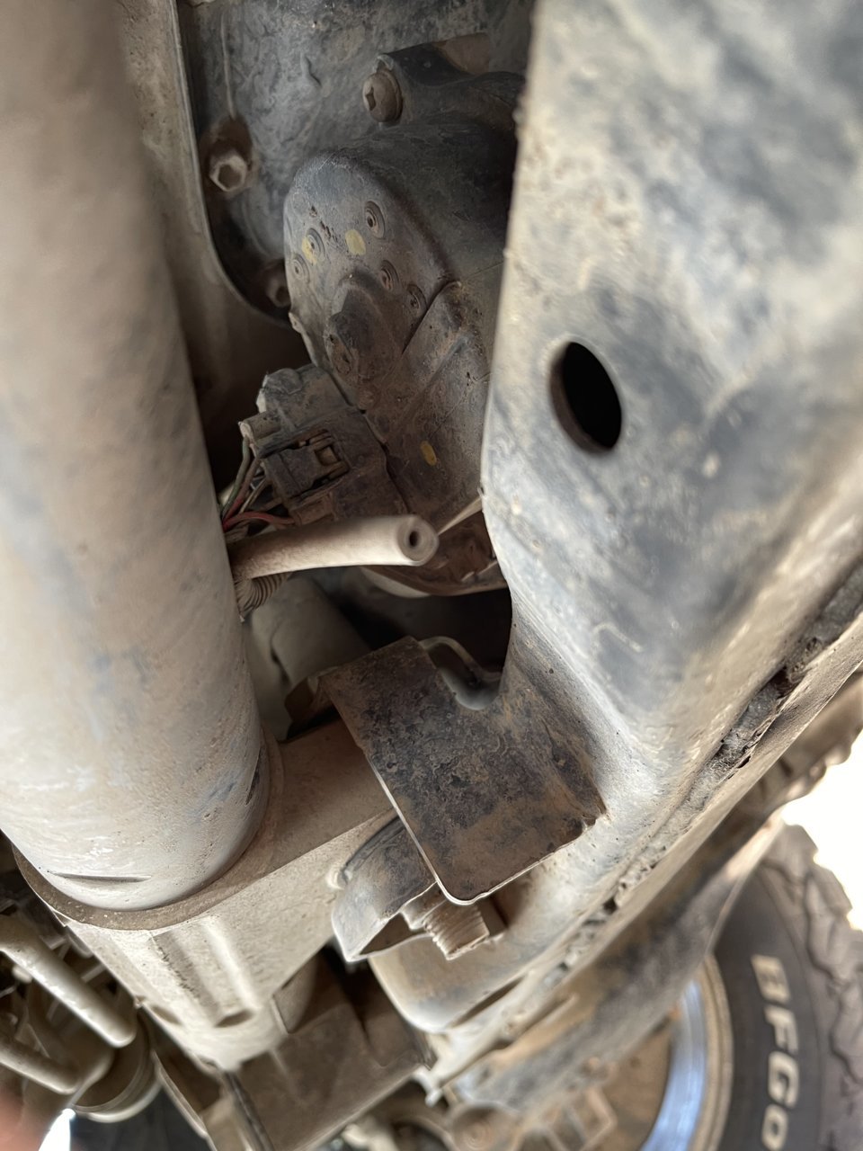

    I can hear movement in the transfer case actuator, but not the front actuator. Also, is the nipple on the front actuator supposed to be the same as the nipple on the transfer case actuator? (Size, location etc.) kinda seems like mine has broke off

    I can’t remember for sure, but seems like they were both the same. Take pics of both and post them up so we can see.

    Picture of Front Diff actuator:

    Picture of T-case Actuator:

    Well that’s my issue. I don’t see it on the front actuator. But on the T-case actuator you can see the hose connected

    Just to clarify some confusion, that rubber hose is nothing more than a drain line/vent. No vacuum involved. My suggestion would be to get the truck completely off the ground and see if the T-case actuator is engaging when you select 4hi with the vehicle in drive. You should be able to look under the truck and see the forward drive shaft spin when the T-case actuator is engaged. If the A.A.D. actuator is the problem, you'll get the front shaft to spin after hitting the button, but the front axle won't engage, and front wheels won't spin.
    If the front shaft isn't spinning, then the culprit is the T-case actuator.
