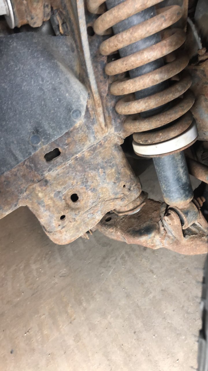

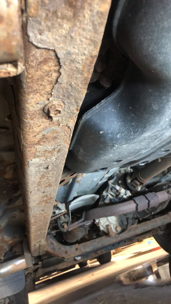

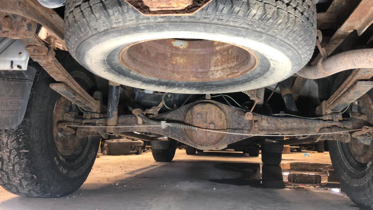

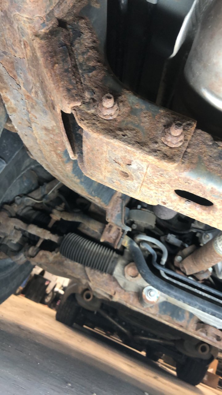

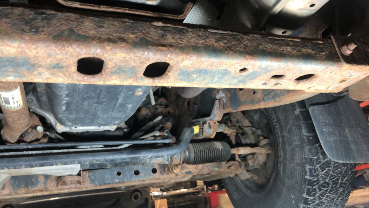

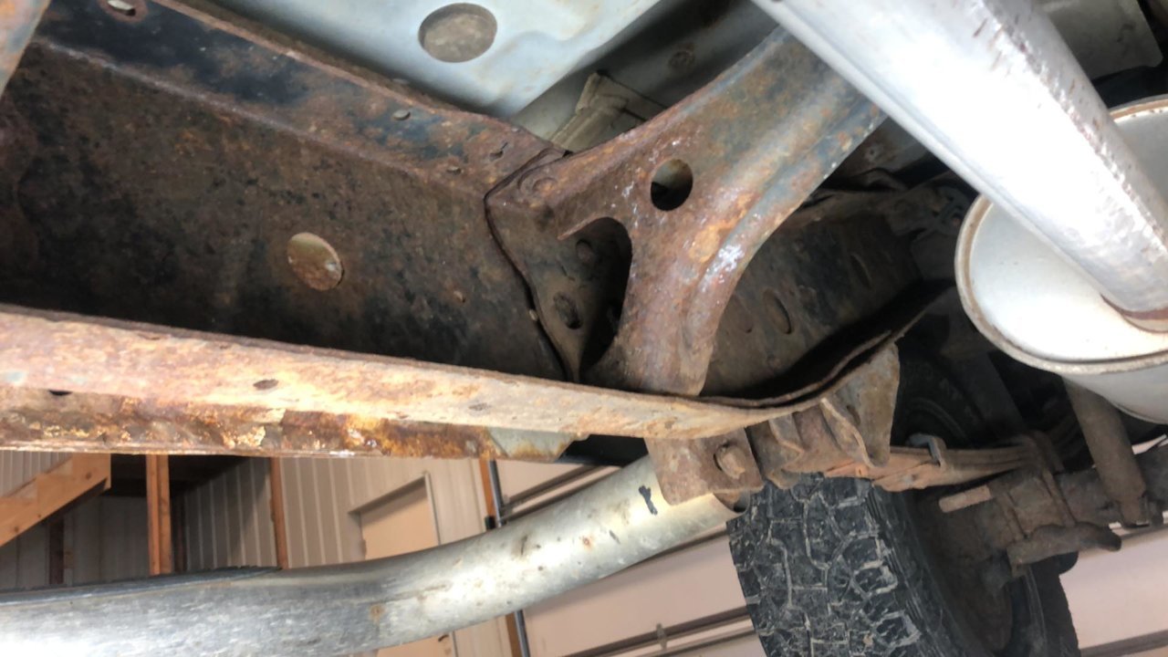

    Hello all!
    I am planning on buy a 2005 Toyota Tundra access cab this Thursday. I will be flying out from MT to SD to pick it up. She looks pretty good from the outside but the owner sent me the photos attached below today. Do you guys think that this is too much rust? The truck has 127,400 miles, I talked the seller down to $6000, but it has a salvage title. Do you all think that I should walk away from this deal? Thanks in advance for any knowledge and advice!

    fuck that.
    It's not getting ate for the most part, but it's not far.

    I would take a higher mileage truck with less rust.

    I wouldn't walk away, I'd run.
    They don't call rust "cancer" for nothing. That would be a ton of work to clean up, and it might be hiding some serious rot underneath the surface. Simply not worth the risk, IMO.

    salvage title and rust like that? RUN LIKE THE WIND!
    that trucks not got a long life ahead of it. i bet the passenger side front top part of the rail (A/C drain) is already rotted out.

    I liked it better the first way. It is Halloween, just read it as boo.
    Yeah, too much rust for a salvage title at that price.

    JESUS I would not buy that. Can you imagine trying to work on that with all that rust? No thanks.

    Not worth it. Generally a salvage title will cut a vehicles value in half. That rust bucket isn't worth $12k

    I usually will defend a little rust on these type of posts, being from the Northeast an rust being a part of life. But dang man that's alot even for me to overlook. Top off with a salvage title. And your traveling to buy it?. no way..
    You can tell whomever owned it in the past didn't give one sh$t about cleaning an rust prevention. Hard to believe the rest of it was taken care of either in that case ..

    That is too much rust to fly-to-buy. In one photo you can see the backside of the rocker panel is about to rust through. The trailer hitch has rot through hole which means you shouldn't trust the hitch for any towing. The spare tire rim is rusty & compromised. Every bolt you touch on that truck will snap off & you'll have to E-Z out the broken bits. That's not a truck to buy, that is a truck you give to a kid so they learn the value of working hard to afford a good vehicle. As said above - that is not the one, unless it is being given to you for free by an uncle who will help you to work on it. Which it isn't. Keep looking.
