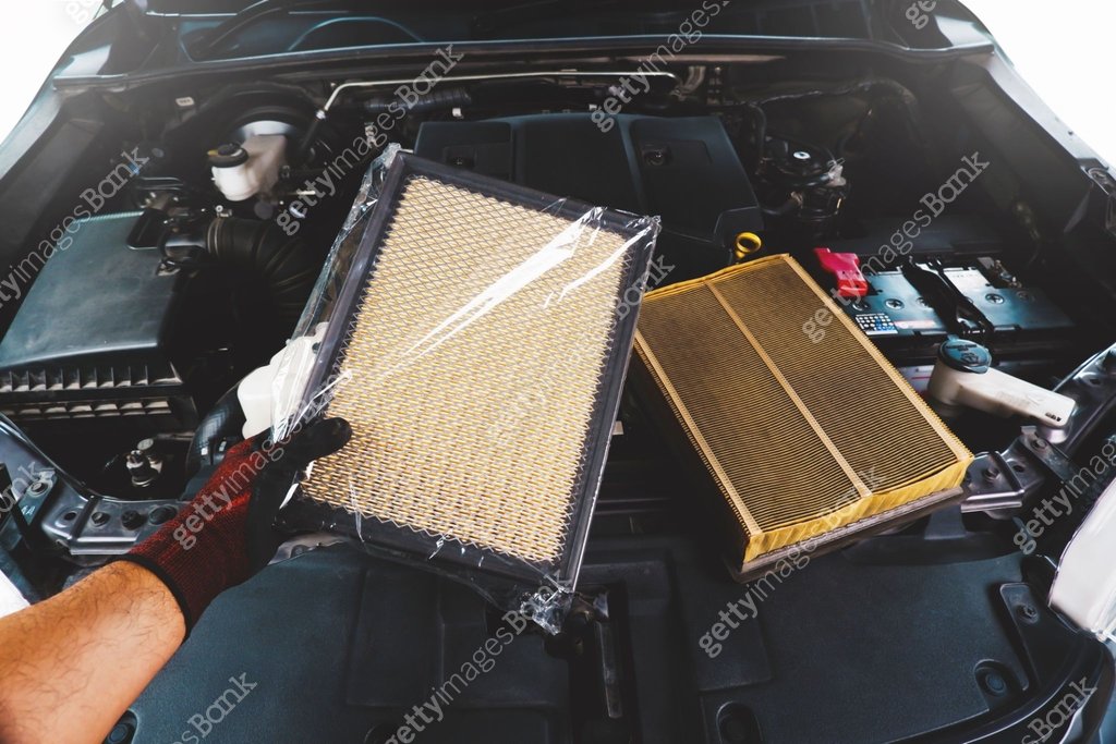

    Update: I remembered I replace the air filter and cabin filter with some cheap Amazon brand the day this all started. I was reading that restricted air can cause the truck to crank and not turn over. I had cleaned my K&N air filter a couple days ago so I decided to put it back in last night. The truck started. Checked this morning again and it started.
    I hope that was the issue but I will still check all the ground in the chassis for green. Wish me luck!

    Helps if you remove the plastic first..
    :D:D
    Seriously, though, that’s weird. I only use OEM filter but I haven’t seen that happen before. Maybe the air filter was just coincidental? How bad were the terminals? Either way, glad it works though!

    Hahahhaha!
    I find it odd as well. I have started it a few time this morning separate times and no issue so far. I will keep triaging.
