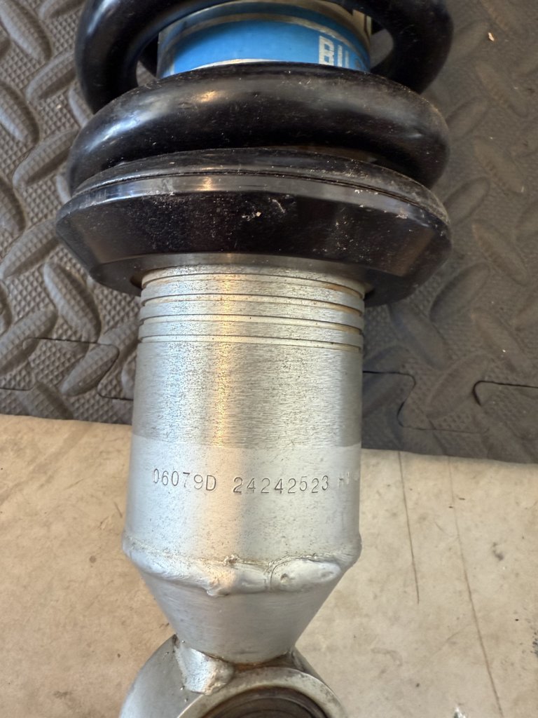

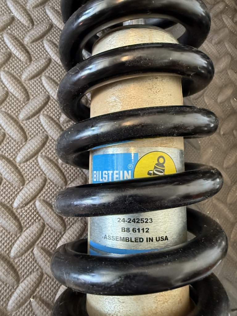

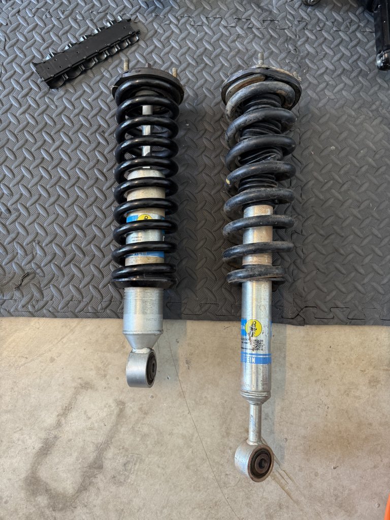

    So I bought some 6112 bilstein off Facebook marketplace, the guy said the guy said they were for 2001-2007 tundra and sequoia. I was about to install today on my 2007 Tundra Regular Cab 4x4 OR, and took off the 5100s off my tundra and noticed the 6112s are way shorter. The 5100s and 6112 coilovers should be about the same length, correct?
    did the guy sell me the wrong ones?
    Any help is appreciated it

    You should also be able to search the part number you got from the guy and see what its applicable to

    yeah for some reason when I search by the part number they don’t come up

    The shock on the left is the incorrect 6112; I’ve got 6112’s on my truck and they’re just larger 5100’s
    looks like sequoia only, you should try and get your money back
    blenton and Mountainlord[OP] like this.

    Unfortunately, the shocks you purchased are for 01-06 tundras. The tundra was completely redesigned for 2007, so 07-21 are completely different from 06 and older as you see.
