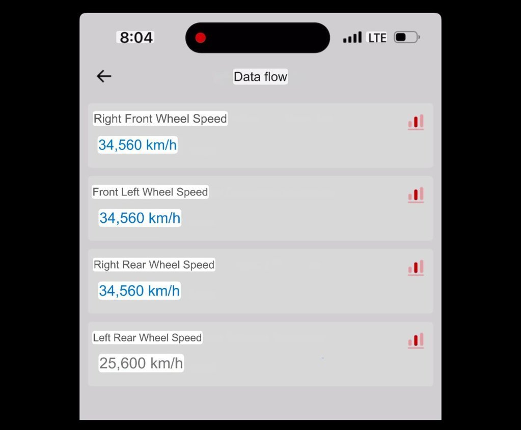

    My other problem is the rear left wheel speed sensor. It's not reading correctly and is causing my truck to keep turning on the anti-skidding light. I've replaced the sensor with a new one and still have the same problem. I checked the cables and it's still giving a bad reading. When I do the live scan, I only get different values. Is it normal for that part of the sensor to have differential oil? That's another question I have, but these problems have affected me quite a bit, and I can't find a way to fix them. There aren't many experts on the subject here in Venezuela.

    I'll update this issue tomorrow and take a closer look at the speed sensor wiring.
    Regarding the oxygen sensors, I'm not getting any codes. Is it still a good idea to check them?
    Imagen de WhatsApp 2025-03-19 a las 00.20.13_d38550af.jpg Imagen de WhatsApp 2025-03-19 a las 00.16.31_2e3b3486.jpg

    Estuve revisando el cableado del Abs y pues nada. Se ve todo bien y sigue dando problemas, estoy un poco aturdido.
