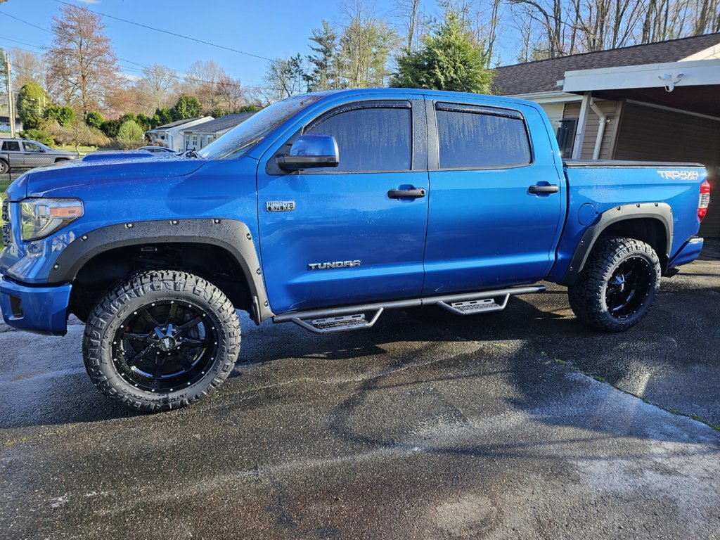

    Hoping to get some advice. I admit, I didn't do my homework when I purchased these tires and wheels, with that said I purchased a set of 20x10 wheels with 33x12.50R20 tires. I have no issues with the rear. The front on the other hand, rubs when making a sharp turn. It has a 2-inch front level kit. I'm not sure how much higher could I go for the rubbing to stop. Any suggestions would be appreciated.

    My knowledge of wheel set ups is limited. But you need to check what the off set on the wheels is. Also, look and see where its rubbing. If the mud flap or any of the plastic, that is easy fix. If its frame or UCA or sway bar, it can require more work/money to fix. I'm on 33's as well but I'm on the stock wheels which are +50 or +60 offset and I have no issues.
