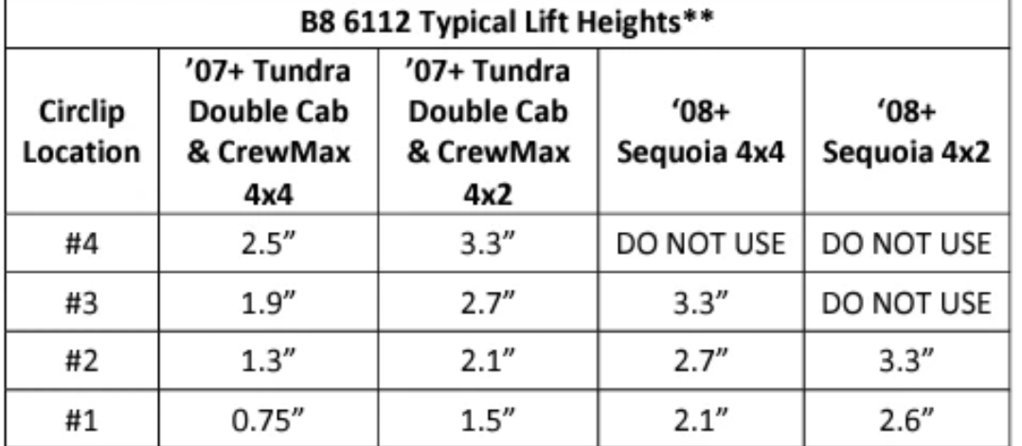

    Hi my name is Tim! Recently put 6112’s on my 2018, and thought I would get more lift then the 5100’s naturally. The 6112’s are on the middle setting because I heard it rides pretty rough otherwise and I think bilstein says to not ride on the top ring. I have a block in the back, and Firestone bags, want to put a ad a leaf from icon instead of blocks. With the 5100’s gone from the front I’m no longer level really, I mean I have a ready lift set of alloy spacer for the front but that compresses the shocks…? What’s the best solution at this point? Haha any pointers?

    So there are 4 clip options, so you can be at the 2nd or 3rd but you can't be in the middle. It also varies if you are 4x4 or 4x2.
    What height are you at and how much more are you needing?
    I have 6112 at the 3rd clip and I'd say their expected height is pretty much what I received. I'm 4x4 and got the 1.9, I did add a coahbuilder shim on driver side to account for lean.
    Pulled from:
    https://hotshotoffroad.com/collecti.../bilstein-2007-2021-toyota-tundra-b8-6112-kit
