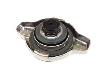

    Pull off radiator cap and post a picture of the rubber side here.

    Thanks @Half Assed, pic attached of the cap

    pic attached

    Its possible the nipple on the bottom of the rad cap broke off and got sucked into system causing and overheating condition in part of the engine.
    It happened on mine. Got stuck in a small heater line where the upper rad hose goes into the engine. I was able to remove it by removing the upper rad hose. Lemme search and find the old post about it...
    Notice the difference between a new cap and yours:

    @Half Assed that nipple certainly is missing, thank you...easy to get another rad cap and I appreciate you trying to find the old post on it, I am searching as well

    You need to find that piece as well as replace the rad cap. At least a couple members found that piece from the cap plugging a passage to the thermostat causing overheating.

    Theres info and pictures in this thread about it
    https://www.tundras.com/threads/running-hot.33183/
    Considering your rad cap is broke, I'd start by getting a new cap, and then pulling the upper hose looking for little chunks of rubber stuck in those little coolant passages.

    Well thanks for everyone's help...the damn nipple was the issue ;-) Pic attached
