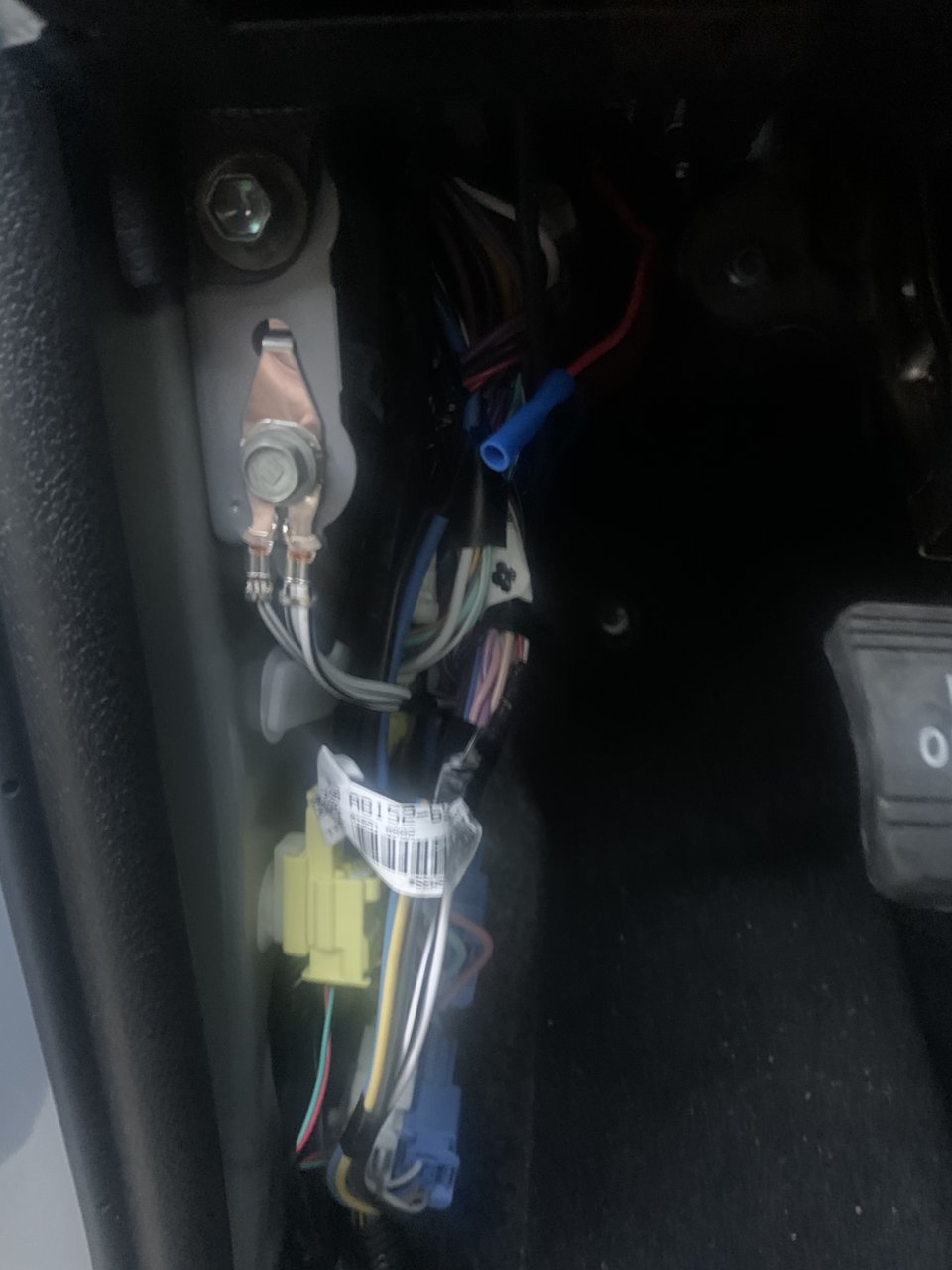

    Ok I am wiring the heated seats in now. My questions are can i wire both hots together and both grounds together. I have a add a fuse into the fuse box for the hot side. For the ground side can i ground it into where the black and white wires are left side of the picture. Thanks

    Yea you can absolutely ground there, add a ring terminal underneath it and youre good to go, thats a factory ground :)

    Thank you i assumed it was but wanted ti make sure before i did it.
