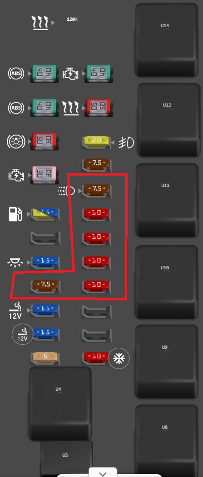

    Have you checked all the fuses, under the hood and in the dash? Under the hood, I think there's a 7.5A and a couple 10A mini fuses for the headlights, I believe it's in this group boxed in red below (this is the fusebox next to the battery)
