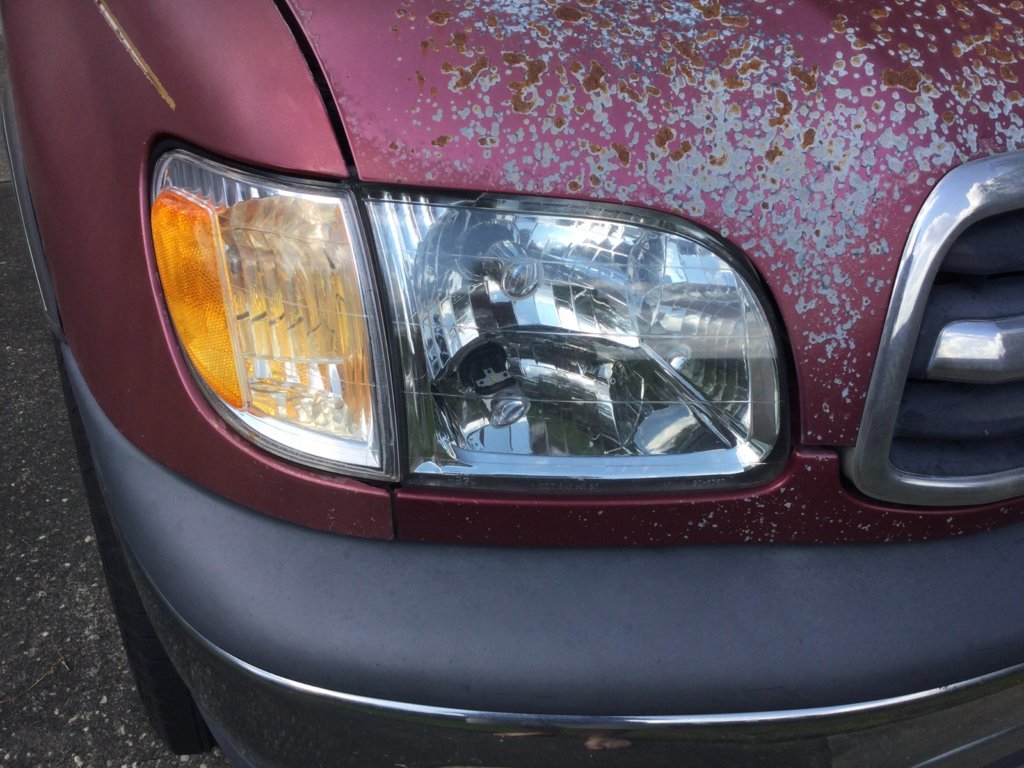

    I'm running the $35 TYCs (actually, they were $22 when I bought them). I think they're great! Perfect fit, and they look fantastic!

    Not trying to be antagonistic here; sincere question. How long do you believe the coating and materials will hold up at that price-point?
    Other than recoating them annually the last 2 yrs and some very fine spidering-effect, the OEM ones have held up incredibly well here in the desert for 23 yrs. Not an environment that's kind to rubber or plastic. When I break down the cost of OEM, that's a pretty good value, really.

    Well, I'll tell you...I don't know. But they sure as shit look a lot better than the ones I took off, even after polishing and coating them. But I have a secret...I have another brand new set of of TYCs in the garage (remember...~$22 ea), so even if they only last a few years I'm way ahead of the game.

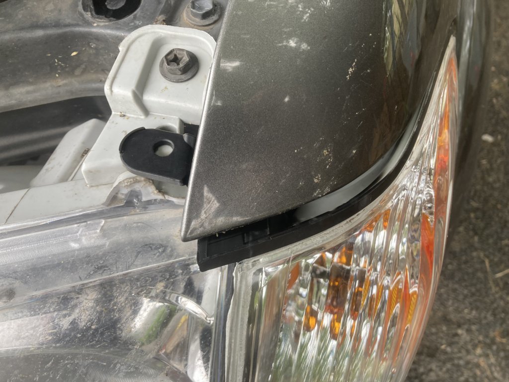

    Anyone else have a fit issue with Dorman side marker/corner lights? I previously replaced the headlights with no issue. So easy, even I could do it. I ordered the Dorman side marker lights from Rock Auto. They come close to fitting, but I can't get them quite into place. And I really don't like a gap where water will run into the housing. Before I send them back, I wanted to see whether others have had a similar issue.

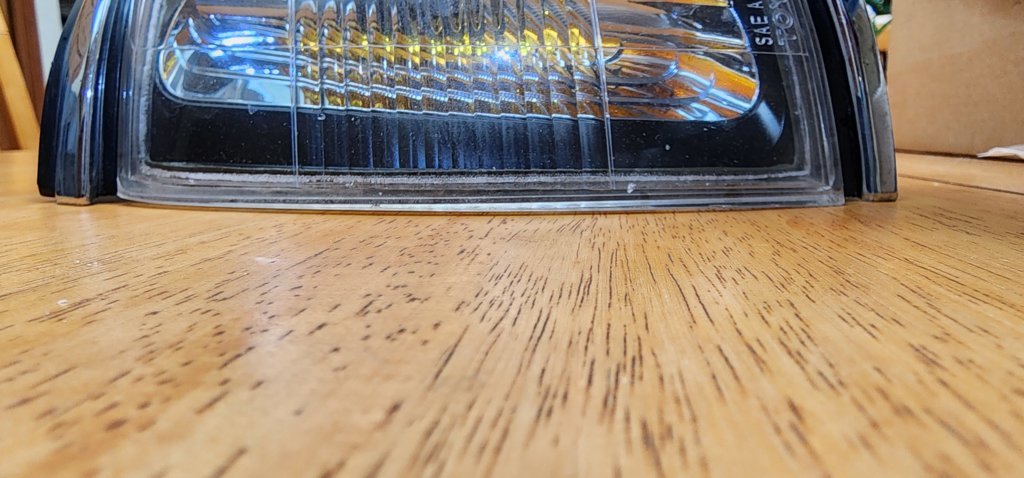

    Have seen fixtures not be precision as can be seen here (although not Dorman) with a slight gap left to right on this Taco side marker that made it difficult to get even gap with headlight. If it won't fit, it is because the stud doesnt insert or tab won't line up to put in the screw? Looks like maybe it is hittng the headlight with stray plastic and might benefit from a little trim?

    Never had an issue with a Rock Auto CAPA certified fixture.
