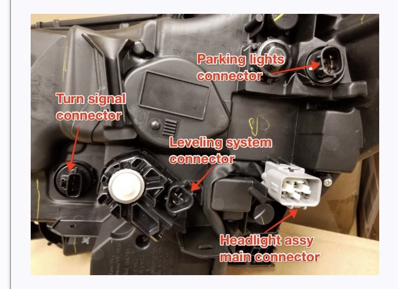

    This is an OEM led headlight but you can see the level plug

  6. Feb 14, 2022 at 5:47 PM
    BBB1
    BBB1 [OP] New Member
    Feb 14, 2022
    #74616
    7
    2016 Tundra
    Thanks ill take a look tomorrow
