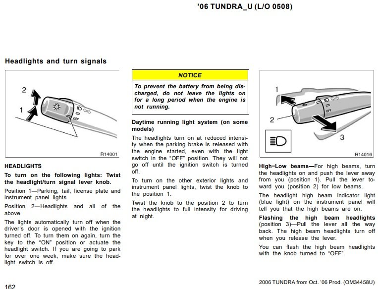

    Those bold items might be easily explained but wish to ask anyway.
    An 06 Light Control switch has 3 position w/o DRL and 4 position w/ DRL, if we count OFF as a position.
    Because of the elec circuitry, it some what matters if your system is with DRL or without DRL.
    I'll also add that regardless which system you have, a Dimmer relay will cause what you're experiencing. I realize you checked all relays but since the dimmer relay is in the EG bay, you might not hear it ?
    shifty` likes this.

    Damn, this is a good one I would've never thought about!

    I didn't think about that. I'll look into this. Thanks a ton.
