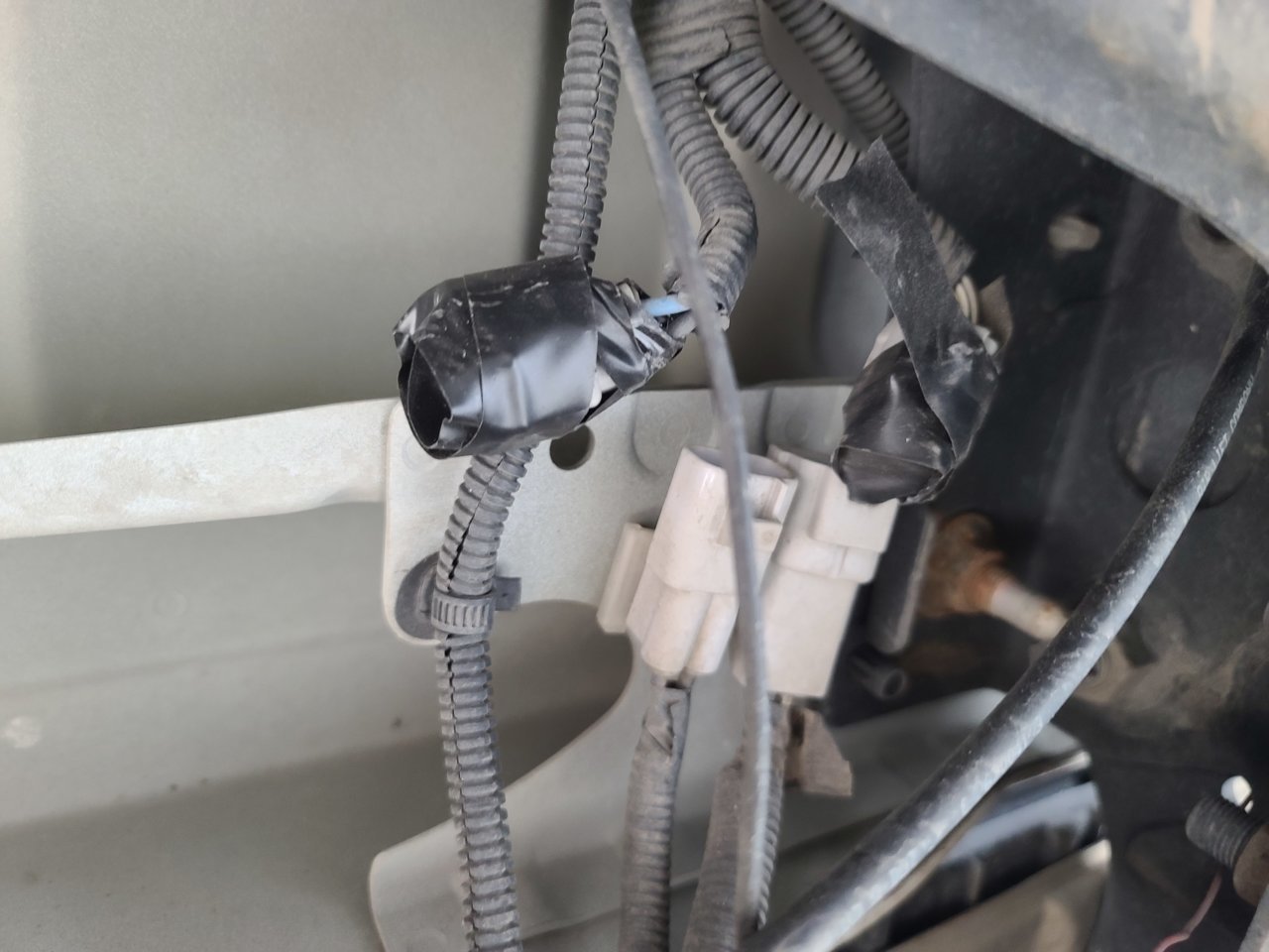

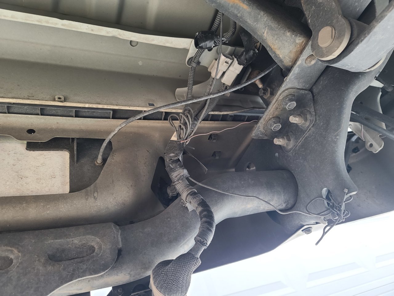

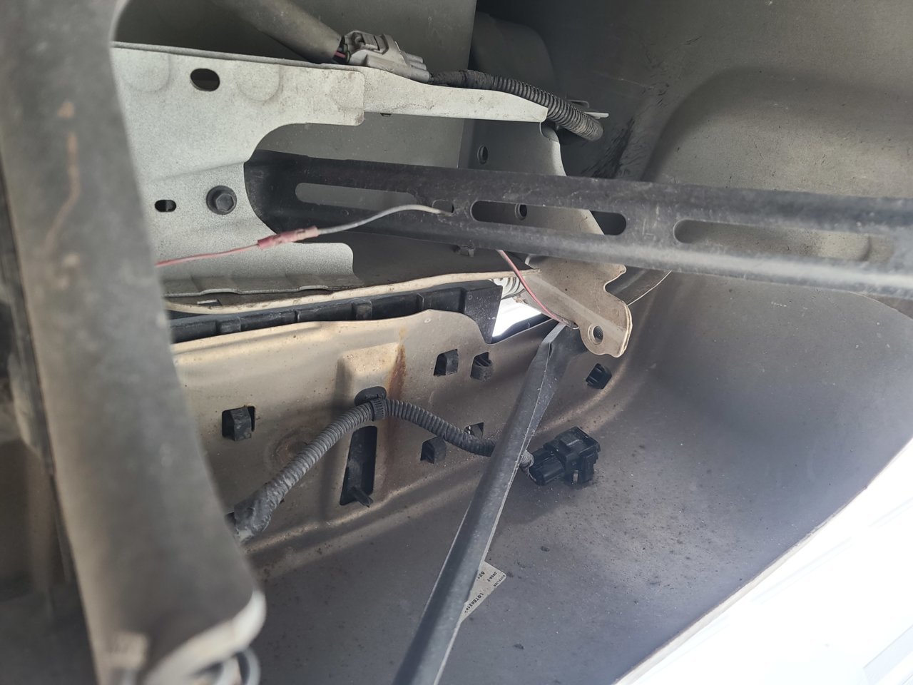

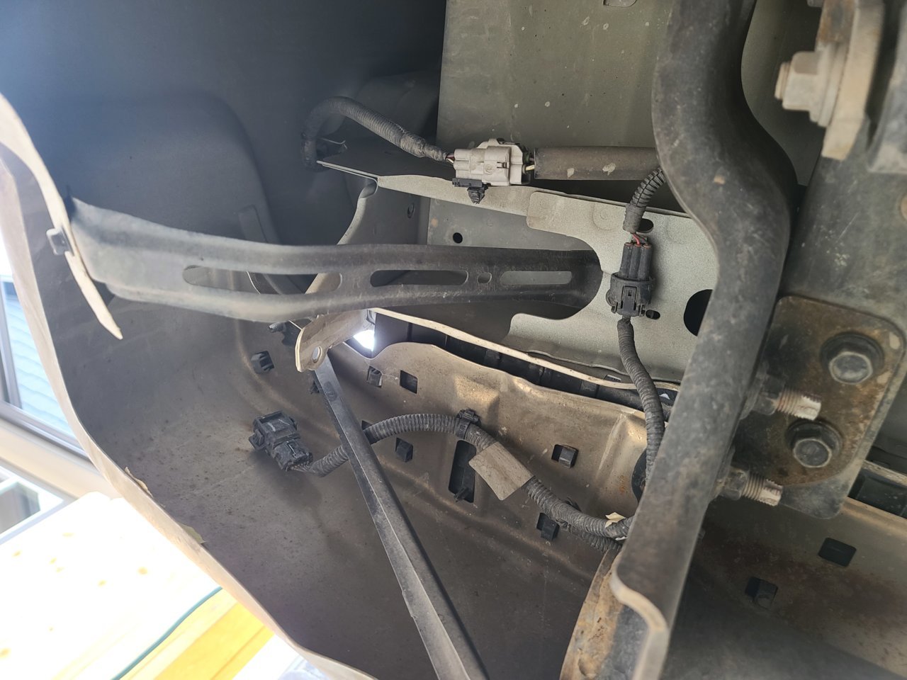

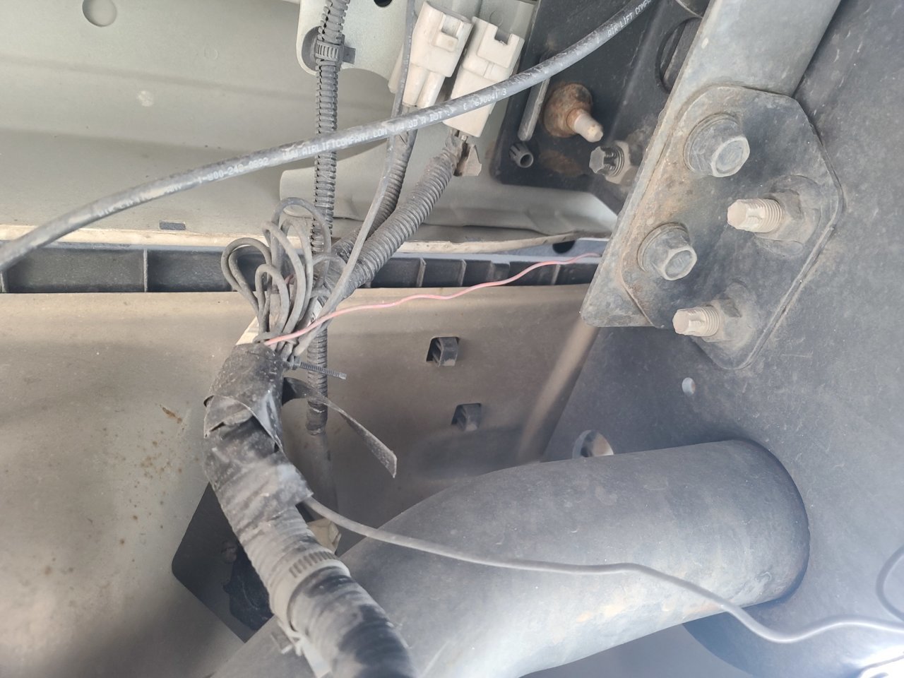

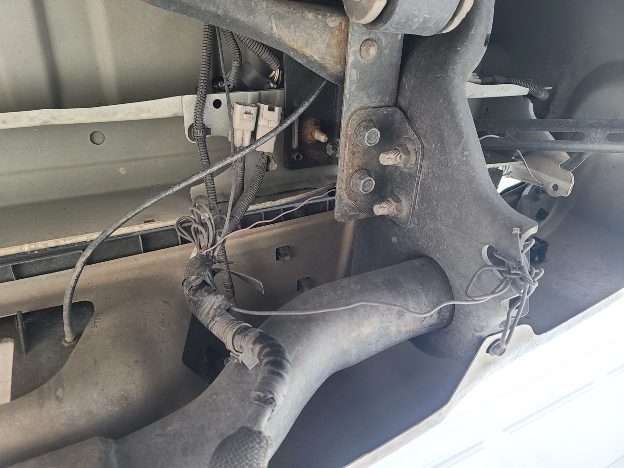

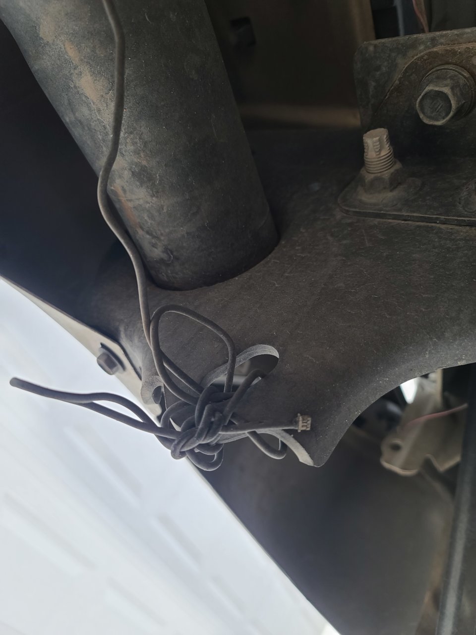

    @KNABORES I did go out and take some photos of the wiring under the truck one immedialty weird thing is you'll see the driver side has a random red wire running to them that the passenger side does not. 20220317_152916.jpg 20220317_152913.jpg 20220317_152916.jpg 20220317_152913.jpg

    @KNABORES you'll also see I noticed tonight those plugs with electric tape on that that idk why they are unplugged but I haven't plugged them back together yet
