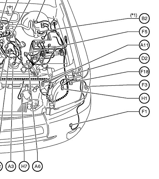

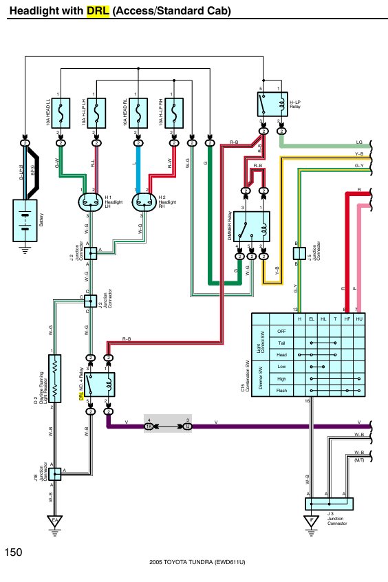

    That is the truck's DRLs, Daytime running lights.
    There should be a gray connector between the battery and the fender you can unplug if you'd like to turn them off.
    I had them on my 2005 double cab.
    It is the D2 connector.

    this is hugely helpful, thank you! I will take a look at my wiring and try the grey connector
