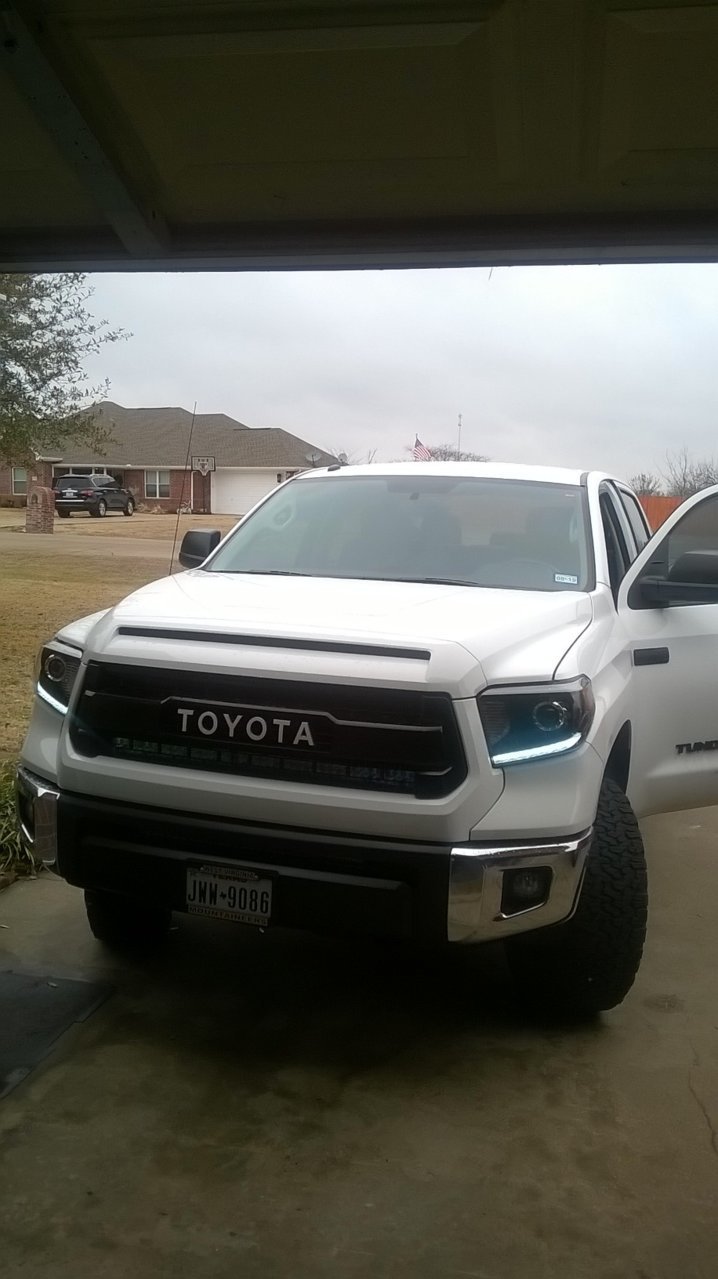

    Is it possible to do a plug and play with the headlights in a sr5 from a limited tundra which has all led headlights? Or is it a complicated swap with lots of modifications?

    There is a headlight harness on here to do plug and play for the 2018 headlights....lemme find the link

    You can buy a P&P harness from @iHacker

    Yes, you can and it is not complicated. There are two vendors that sell the harness, @iHacker and @eledobleu . Both are very good quality and have extensive installation instructions. Essentially, the 2018 OEM SR5 uses the same headlight as a 2017 Platinum/1794 which has an LED DRL and halogen headlight (I had the 2016 version) which converts to full LED. This is mainly PNP harness plus changing one pin in the turn signal plug for each headlight (driver + passenger).
