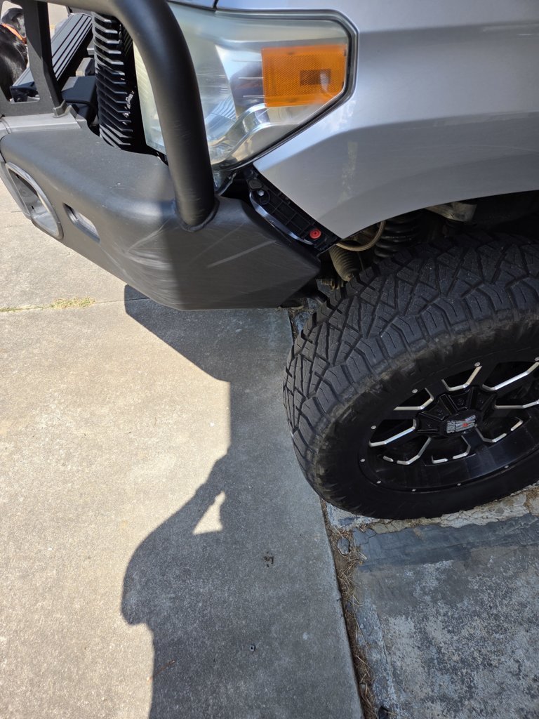

    Yes, but the little tiny quarter panels need to be removed and then you'll have access to the mounting hardware.
    I have the exact bumper you're talking about and it's a Bear but can be done. I "deleted" those little panels as pulling them with the bumper installed scratched them up like crazy but now it takes me maybe 5 minutes to remove the headlight assembly. If you need any help, PM me.

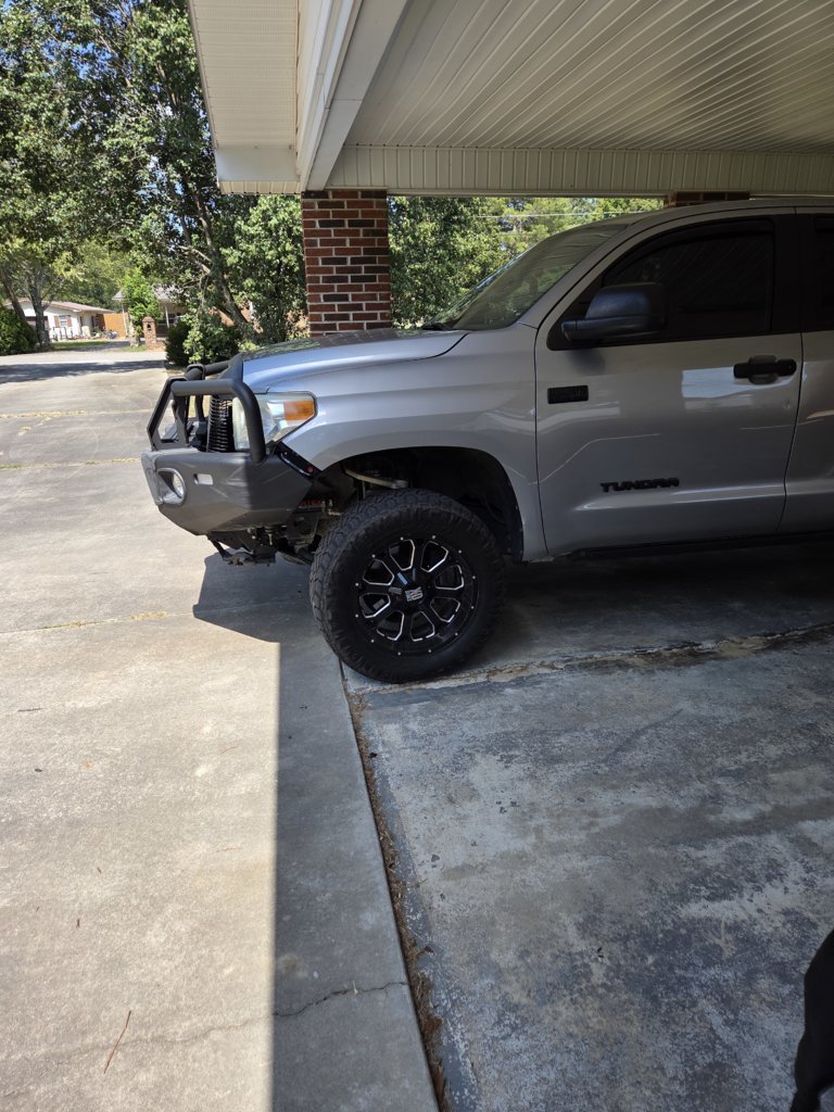

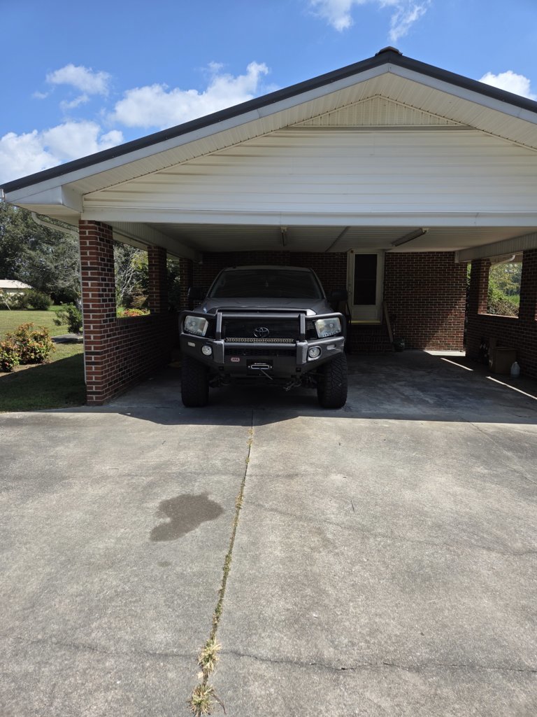

    Do you have a picture of your "delete"? I think I understand what you are saying, but want to be sure.

    I'll get one. Hold on.

  6. Sep 3, 2025 at 12:05 PM
    Corndog123
    Corndog123 New Member
    Aug 8, 2024
    #121073
    1,631
    Sam
    Tennessee
    2014 SR5 Tundra Crewmax 4wheel drive 5.7
    Rough Country suspension, 305s, ARB bumper, light bar, Smittybuilt 10k winch. XD Buck 25 rims
    I like the way it looks.
