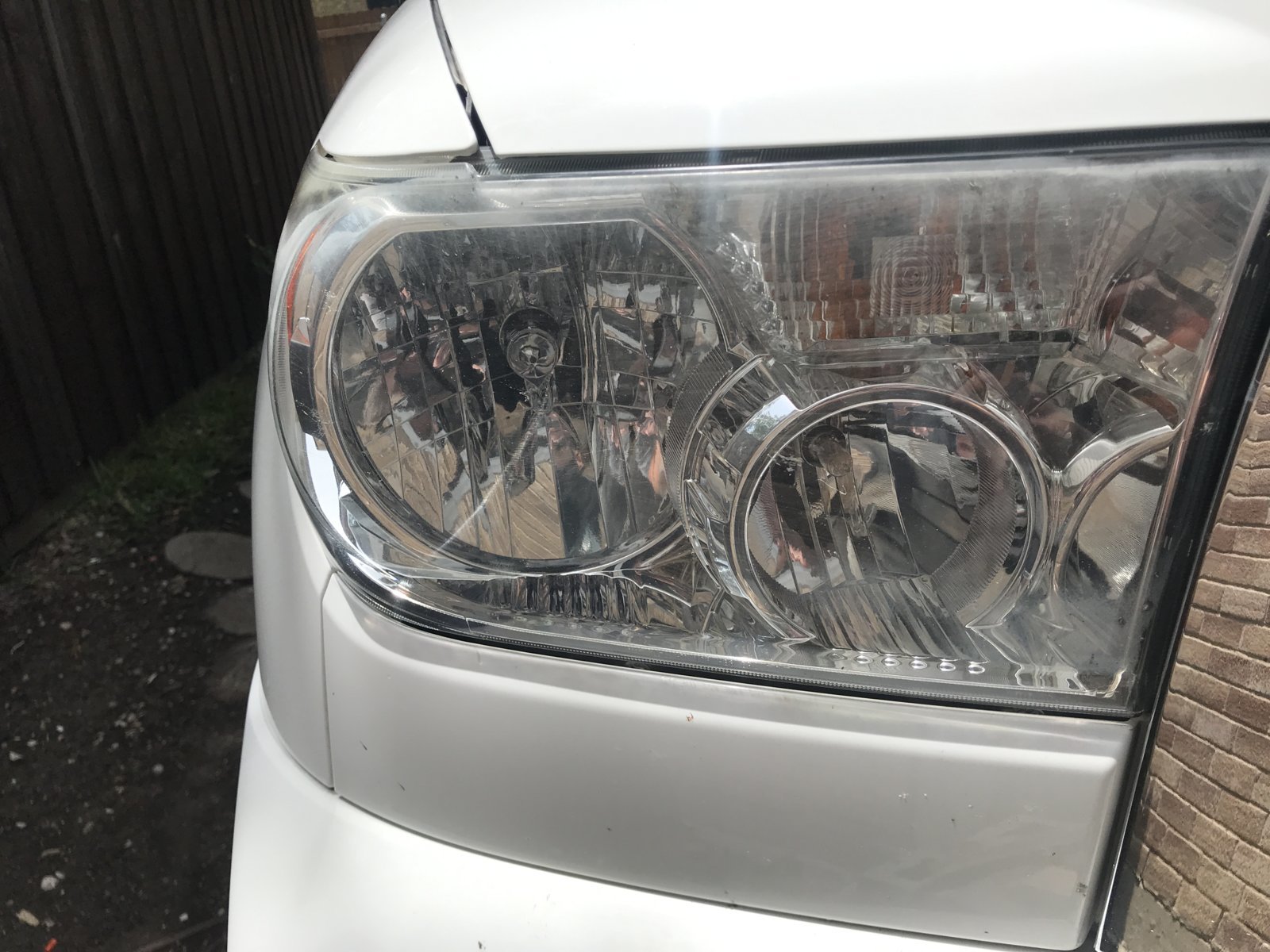

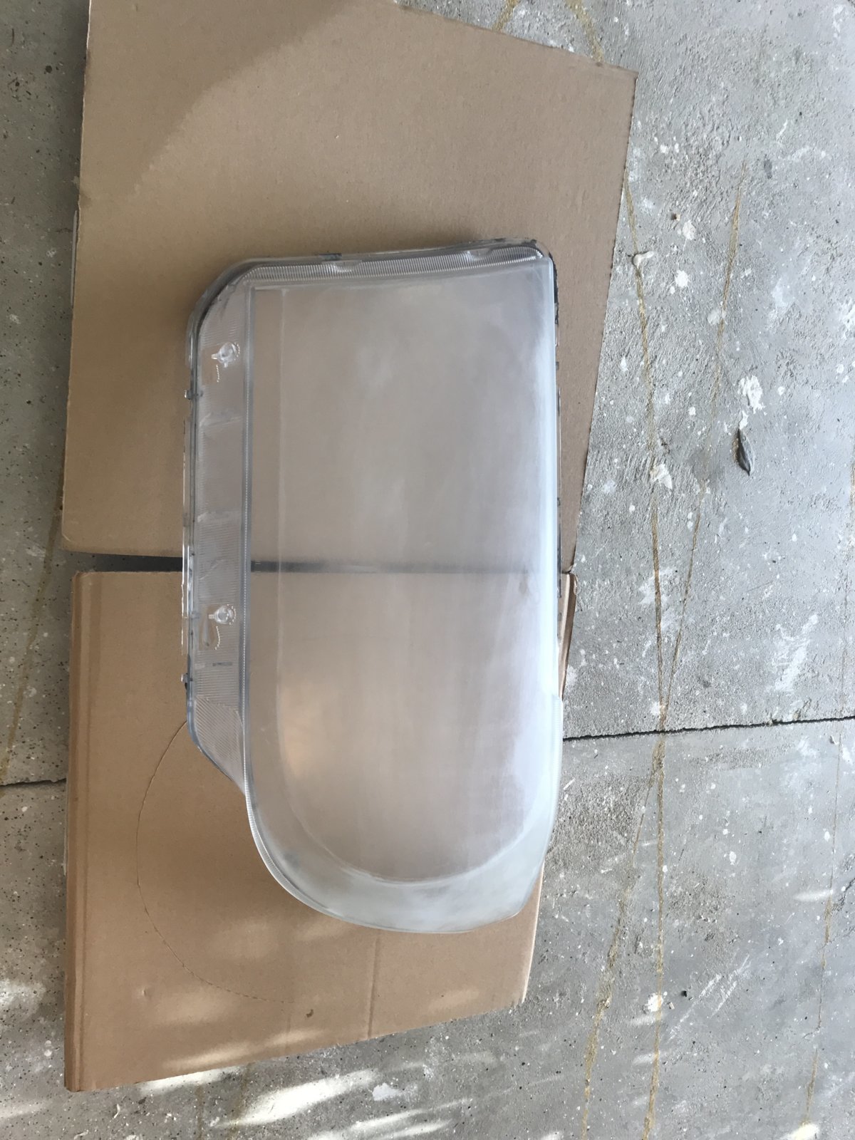

    If you restore them then clear coat, they look new again, even if they are not crystal clear after restoring but before spraying clear coat. Clear coat will cover up any hairline scratches.

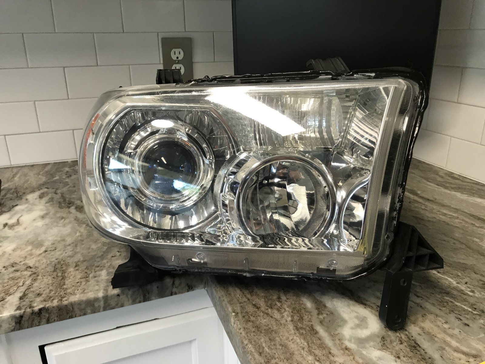

    Also, depending on your budget, you can do the above and do HID projector retrofit at the same time. It’ll greatly improve the light output while retaining the level adjust. If you go this route, you’ll reseal your lights in the process.
    Someone on here posted a step by step for retrofit DIY that I followed. It was pretty easy.
    Attached is before and after. The 3rd photo shows how scuffed up they were before clear coat.

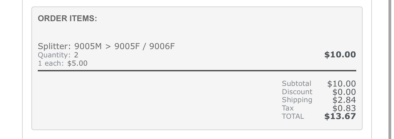

    I can’t tell if the attached list has the bulbs on there or not. If I remember correctly, that may be the $55 charge below ballasts.
    Separate order lists a splitter, this is a splitter so you have both low and high beams on at the same time for a “quad beam” effect. Super bright and worth it.
    Clear coat used was from Spray Max. I originally tried Home Depot clear coat and it was junk with tons of orange peel. That’s why the lense is so scratched up in my original post and took a lot of time sanding off Home Depot clear. Spray Max kit, while expensive, uses a 2 part clear that mixes in the spray can right before you spray. It was a night and day difference.
    I followed this post and he did an amazing job writing up the process: https://www.tundras.com/threads/how...w-morimoto-d2s-5-0-bi-xenon-projectors.44863/
